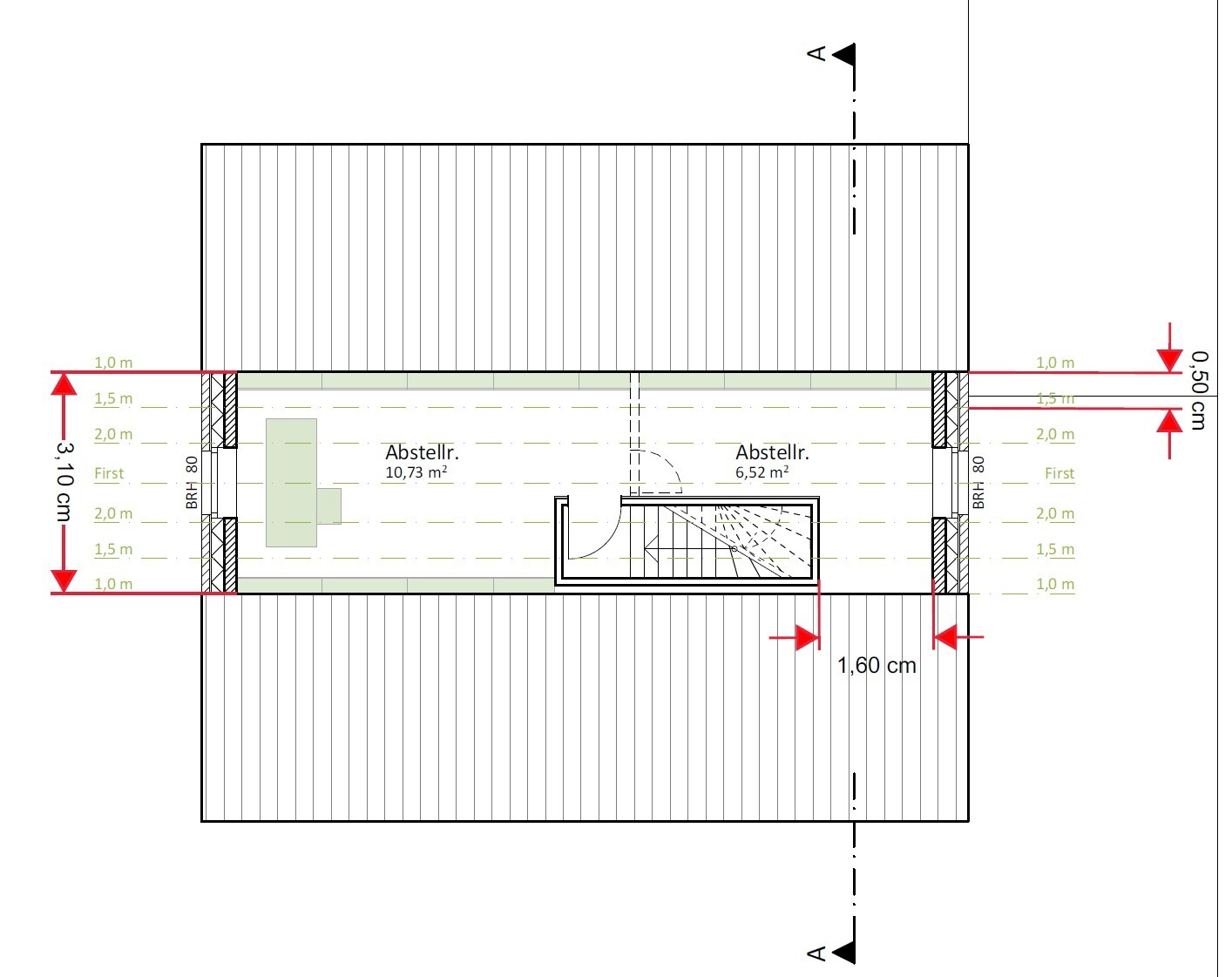

  • Option for a multipurpose room (playroom, TV room, guest room alternatively on ground floor or attic)

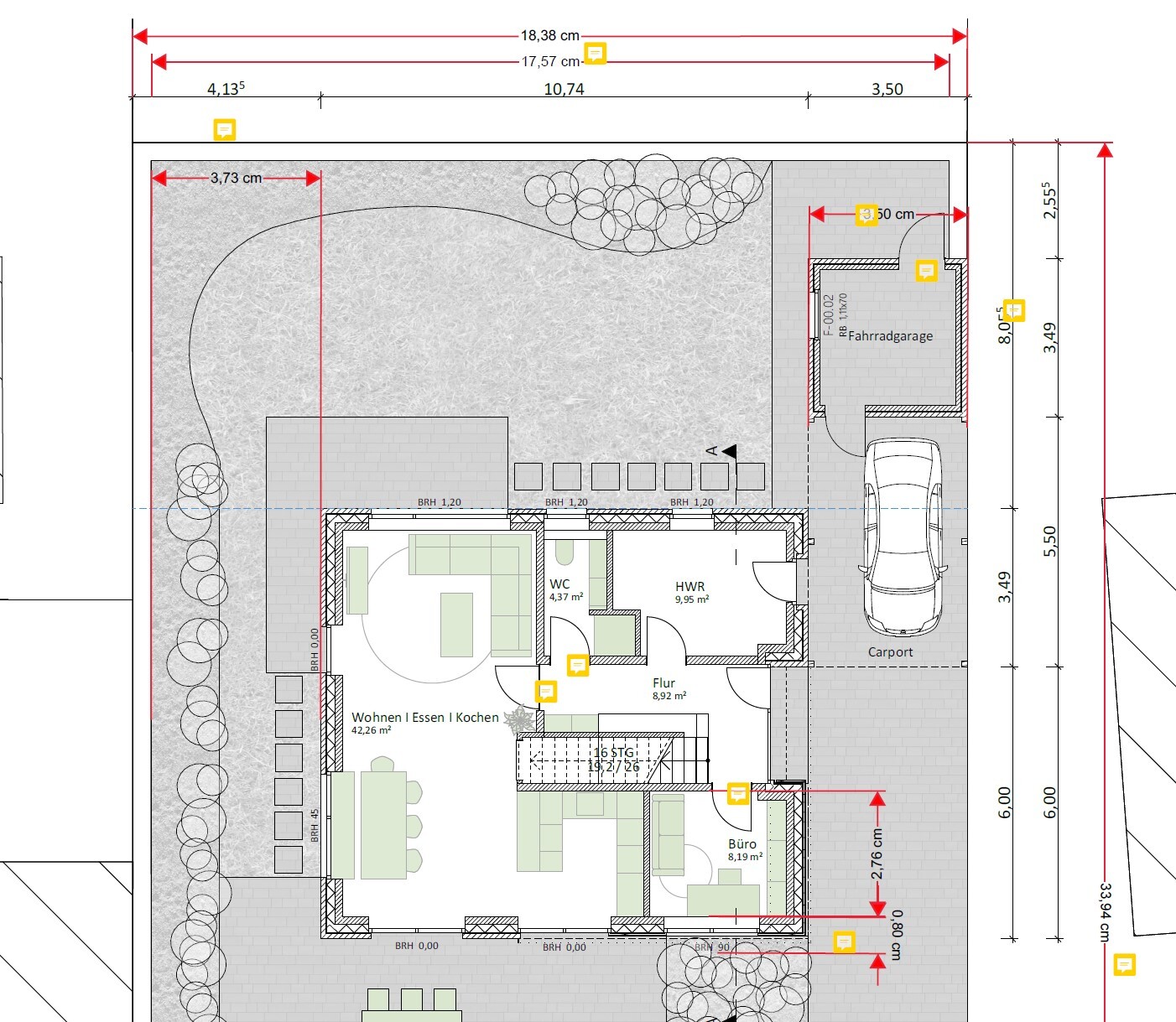

  • I am unsure whether we should reduce the number of rooms or slightly increase the floor area (e.g., extend the house by about 50–100 cm (20–40 inches) towards the south).
    • Ground floor: is 4.37 sqm (47 sq ft) large enough for the guest WC with shower?
    • Ground floor: is 8.19 sqm (88 sq ft) enough for the office for 3–4 days of home office? Would a sofa bed fit in?

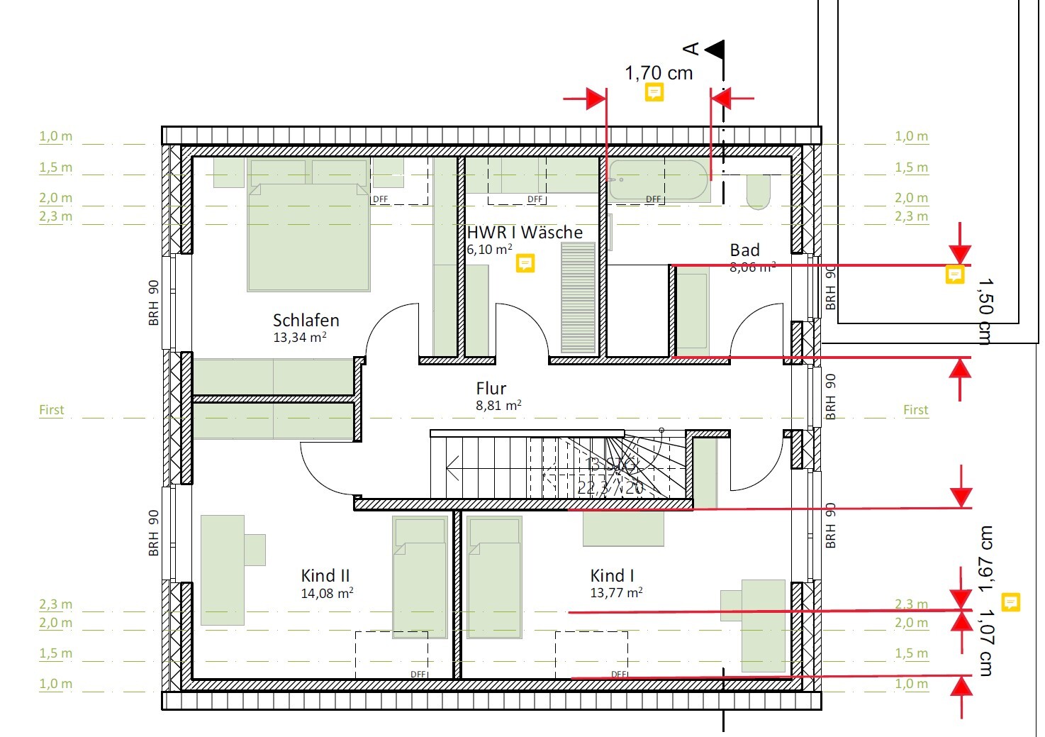

    • Upper floor: is child’s bedroom 1 too narrow? 1.98 m (6 ft 6 in) height up to 2 m (6 ft 7 in), 2.47 m (8 ft 1 in) height up to 1.5 m (4 ft 11 in), 2.76 m (9 ft 1 in) width to wall up to 1 m (3 ft 3 in) height

Floor plan of a house: living room, kitchen, WC, utility room, office, hallway, carport and bicycle garage.
Floor plan of a house, upper floor: bedrooms, two children's rooms, hallway, bathroom, utility/laundry room, stairs.
Floor plan of a building with two storage rooms (10.73 sqm and 6.52 sqm) and a staircase.

Unfortunately, I haven’t been able to discuss the points further because the architect is ill. However, I have added a few measurements to the floor plans.
... and the architect doesn’t seem to apply his own consistently. I dare say the ground floor was planned first here.
What exactly don’t you like about the upper floor?

Are the yellow speech bubbles meant as placeholders for footnote asterisks and all indicate an 80cm (31.5 inches) door width? That would be a bit tight; a construction standard dimension of 87.5cm (34.4 inches) is typical for interior doors.

That hasn’t changed since post #9.

2.67 meters (8 ft 9 in) or 2.76 meters (9 ft 1 in) is too narrow for the kitchen, office, and especially Child 1’s room, which also has sloped ceilings.
Just as an example with the kitchen at 2.76 meters (9 ft 1 in): that’s space for 4 cabinets 60cm (24 inches) wide plus one 30cm (12 inches) cabinet, which you can make full height in the current plan with the cooktop on the upper side. One of the 60cm (24 inches) cabinets tends to be a dead corner. There is also a maximum of 1.90 meters (6 ft 3 in) for the peninsula to still allow a decent passage on the lower side.
The available workspace is practically only on the peninsula if you want at least some storage space.
If the budget allows, I would also consider extending the whole area to the south.

I actually have no experience with construction plans and therefore still find it difficult to evaluate the architect’s design for myself. That’s why I will take the necessary time and gratefully accept any feedback as long as it comes. The speech bubbles mark the points I want to discuss with the architect (feedback from this forum, from friends, from myself, etc.). The doors are currently all 0.89m (35 inches) wide, except the living room door, which is 1m (39.4 inches). However, I would like to make the doors in the living room, guest WC, and home office on the ground floor wheelchair accessible — so probably a bit wider.
leschaf schrieb:
2.67m (8 feet 9 inches) or 2.76m (9 feet 1 inch) is too narrow for the kitchen, office, and especially child’s bedroom 1, which also has sloped ceilings.
Just as an example, the kitchen at 2.76m (9 feet 1 inch): that allows for 4 units of 60cm (24 inches) plus one 30cm (12 inches) unit that can reach floor to ceiling in the current plan with the cooktop on the top wall. One of the 60cm (24 inches) units will be mostly a dead corner. That leaves a maximum of 1.90m (6 feet 3 inches) for the peninsula to still allow a decent walkway on the bottom side.
Effectively, the countertop area would be mostly on the peninsula, if you want to have a reasonable amount of storage.
If your budget allows, I would extend the whole area towards the south.
The requirement to the architect was to keep the house ‘small’ at about 140sqm (1,510 sq ft). On the one hand, because of high construction costs, but also because we have been happy living in compact apartments before — working in the bedroom or living room, etc.
I am less worried about storage space in the kitchen. I would like a ceiling height of about 2.80m (9 feet 2 inches) on the ground floor and plan to have a kitchen wall with 4 to 5 tall kitchen cabinets. I am also skeptical about the available countertop space, as well as the size of the office. The child’s bedroom #1 really gives me headaches. However, I also keep thinking that this might be complaining at a high level.
Regarding the room layout, I see three options: (a) keep the current layout and extend the house about 0.60 to 1.00m (2 to 3.3 feet) towards the south; (b) remove one room and adjust the layout accordingly; (c) apply for a permit/planning permission to change the ridge direction and design the house to be more elongated.

It would be helpful to have an excerpt from the site plan to see the neighboring properties. The plot is almost 34 m deep (112 feet), and according to the latest drawing, you are planning a driveway of nearly 23 m (75 feet)... why does the house need to be positioned so far back?

I would like to have a clear ceiling height of about 2.80m (9 feet 2 inches) on the ground floor and am planning a kitchen wall with 4 to 5 tall kitchen cabinets.
That’s not really considering the perspective of someone using a walker, and the high ceiling will create a staircase that becomes a major challenge within the floor plan.
numerobis schrieb:
Regarding the room layout, I see three options: (a) keep the current division and extend the house 0.60 to 1.00m (2 to 3 feet) towards the south; (b) remove one room and adjust the layout accordingly; (c) apply for a building permit / planning permission to change the ridge direction and design the house with a more elongated shape.
Don’t ask your architect for details, but have them clearly explain their overall concept for the house.
