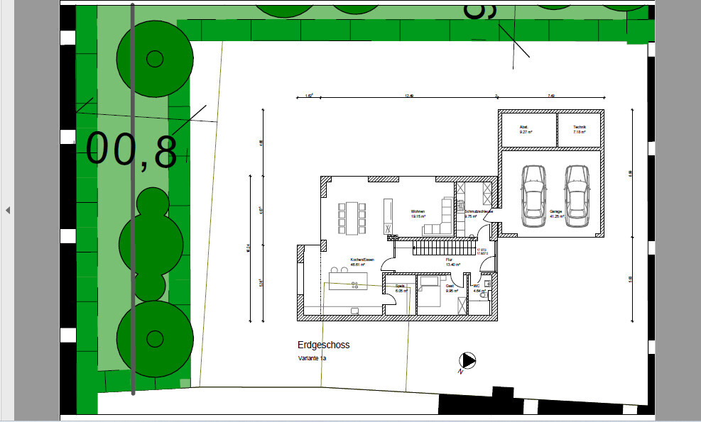

Site plan with plot boundary and red marking of building location.

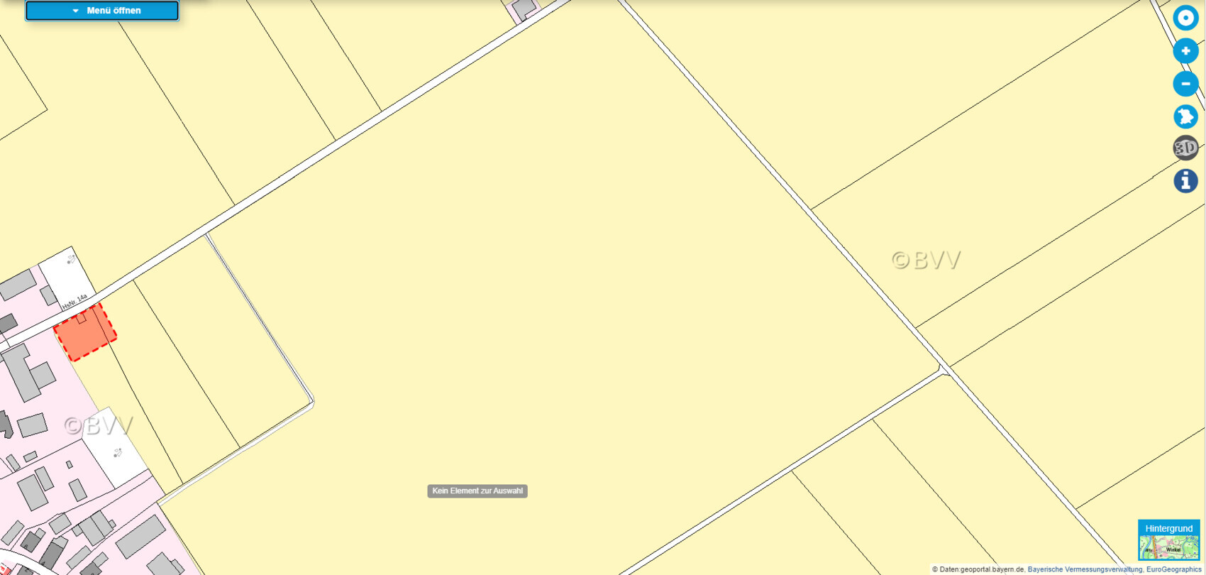

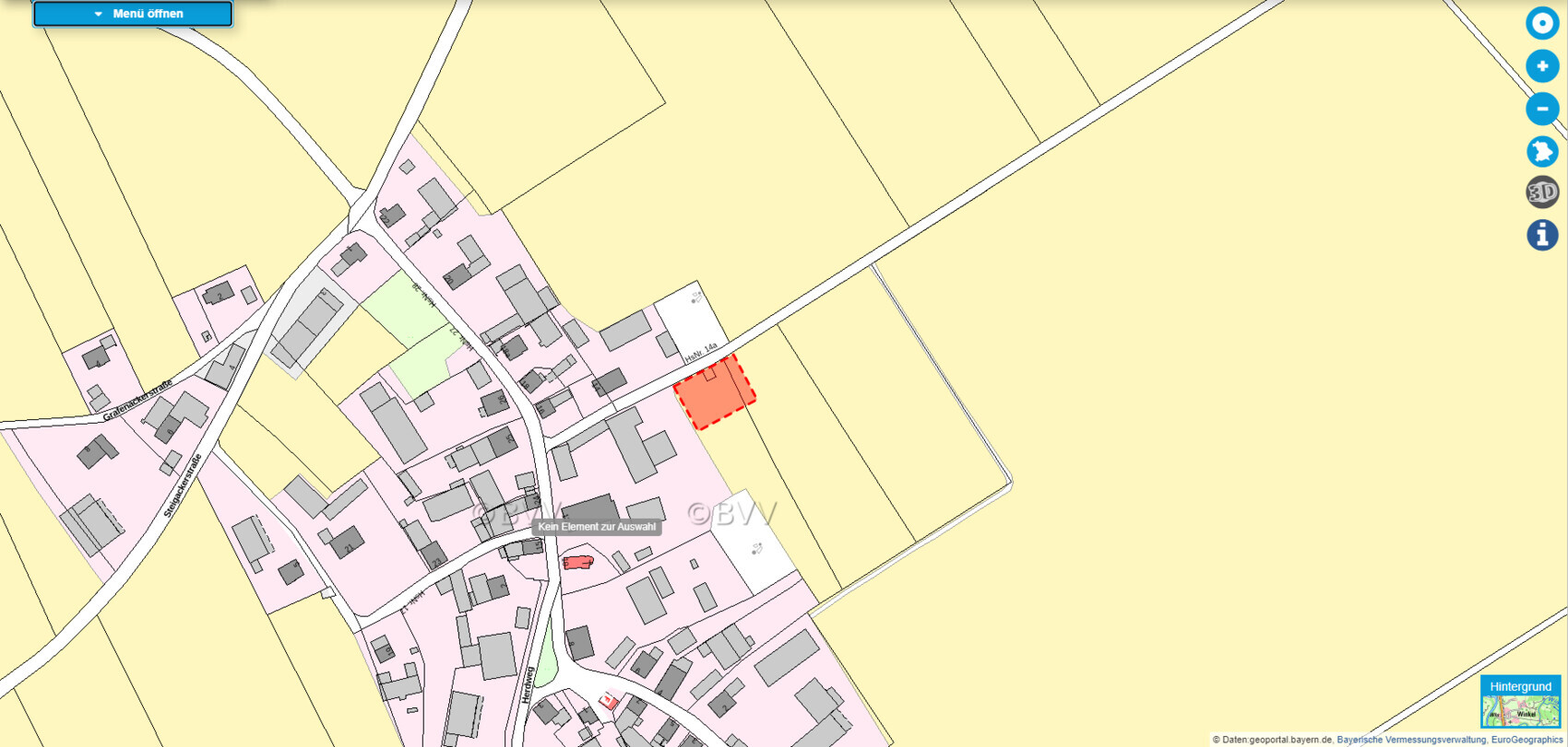

Cadastral map with yellow fields, left side built-up area, red parcel outline.

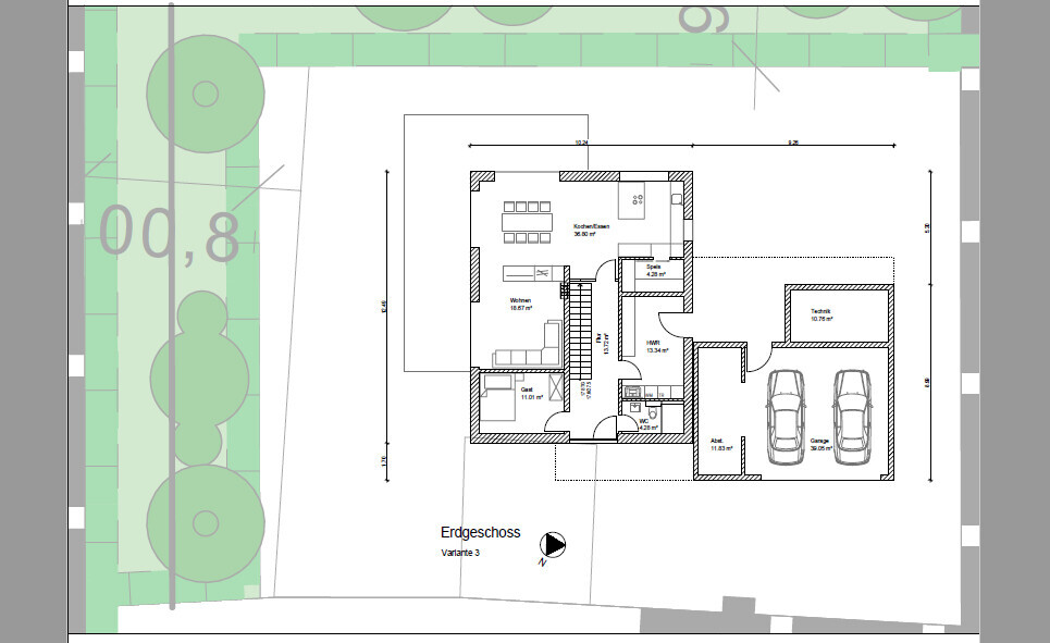

Ground floor plan with living room, kitchen, bathroom, hallway, garage, and garden.
Ground floor plan: living/dining area, kitchen, hall, guest room, WC, storage, garage (2 parking spaces).

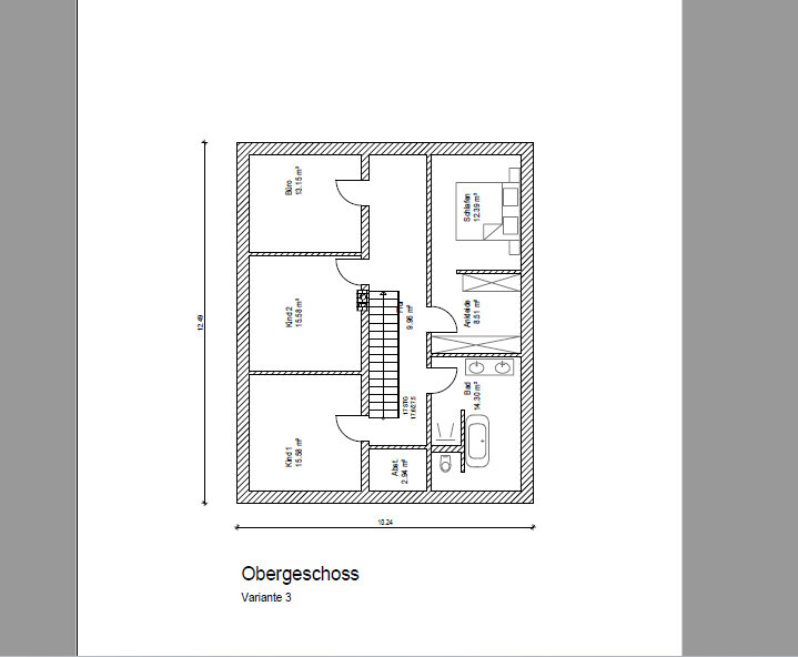

Upper floor plan: two children’s rooms, bedroom with dressing room, two bathrooms, hallway.

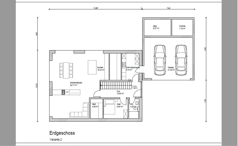

Ground floor plan of a house with living room, kitchen, utility room, bath, guest WC, garage for two cars.

Häuslebauer132
29 Jul 2023 06:10
Considering that these are "only" drafts from a draftsman and not a custom design featuring anything unusual, you can confidently upload the original drafts with the dimensions. Feel free to use higher resolution as well.
We wanted to upload the original drafts, but it was not possible..

Our main concern is the orientation of the house, so we know which option we should continue to develop and pursue.
29 Jul 2023 10:01
Häuslebauer132 schrieb:
The garage is on the west side because we believe that is the best location for it.
Usually, you want to still get daylight through west-facing windows in the afternoon. A recessed garage blocks that. In winter, it can then get quite dark during the day.
Where does the view go?
And I asked about that.
We also don’t plan to build turnkey, but to contribute a lot of our own work.
Yes, but you don’t just cover 100,000 or 150,000 euros with your own labor.
Our main concern is the orientation of the house, to know which design we should pursue and develop further.
That depends on the floor plan, and for the reasons mentioned, I wouldn’t continue with either option.
We wanted to upload the original drafts, but it didn’t work.
Then try again. As it stands, the upper floor doesn’t even have windows. Personally, I would place the garage on the east side with a short driveway. That way, there’s still plenty of “view” to the east and window options on the west side. I would skip the utility room vestibule instead of a corridor and locate the technical equipment within the thermal envelope, as mentioned before.
