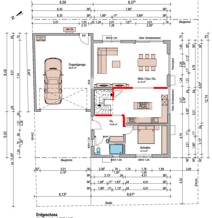

rotihexHello everyone,
We visited a general contractor to get a quote for a single-family house. We received an initial design that, in my opinion, is very good.
My husband still sees room for improvement. He doesn’t like that the kitchen cannot be closed off. Our preference was a kitchen that can be closed with a sliding door to avoid noise disturbance. Unfortunately, this didn’t fit with the floor plan. Separating the living room would be an option, but it would then be quite small—too small for my husband.
Upstairs, the master bedroom could be a bit larger.
Do you have any ideas besides enlarging the floor plan or moving the office to the basement?
Thanks in advance

Office in the basement? That really depends on how you plan to use it. If you regularly work from home and want to keep an eye on the kids, I wouldn’t put it in the basement. Maybe make it a bit smaller and add that space to the living room.
For the ground floor bathroom, I would remove the shower. The cloakroom feels quite cramped, and a cabinet can’t be fully opened in the shower area.
The storage room doesn’t offer much usable space due to the two doors. I would combine the storage room with the kitchen and add a few more cabinets there.
In the upstairs bathroom, I would add a second sink and a laundry chute. With five people, that really helps manage the laundry load.
What is the purpose of this airlock? Let’s think through the possible consequences, as well as the advantages and disadvantages of this passage.
Suggestion: Do without this airlock and move the living room to the area where the kitchen currently is. Then place the kitchen where the living room is now. This way, you can keep an eye on the play area while doing household and cooking tasks, and the kitchen is close to the terrace.
rotihex schrieb:
there is still room for improvement here... I couldn’t have put it better myself. Show the elevations, then we can tinker a bit. I wouldn’t want to have to set up scaffolding just to clean the window above the stairs. Just as an example of objective flaws. There are several other issues in terms of aesthetics; I find the entrance to the bedroom unsatisfactorily solved, and the bathroom looks unimaginatively “furnished.”But compared to the previous version https://www.hausbau-forum.de/threads/grundrissoptimierung-siedlungshaus.25074/, this is already a big step forward.
I hardly see a reason to make the bedroom larger. 18m² (194 sq ft) is quite generous, isn’t it? What are your plans for that space?
Otherwise, I agree with the previous comments. The airlock area is a poor design and should be removed. A covered entrance from the garage would be preferable. The downstairs shower is questionable, even if you make it larger than shown. It’s better to design an open wardrobe from the start with a large closet rather than that fiddly setup.
