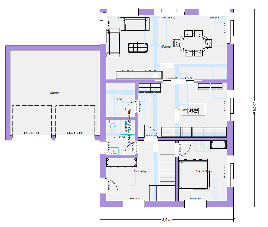

We visited a general contractor to get a quote for a single-family house. We received an initial design that, in my opinion, is very good.
My husband still sees room for improvement. He doesn’t like that the kitchen cannot be closed off. Our preference was a kitchen that can be closed with a sliding door to avoid noise disturbance. Unfortunately, this didn’t fit with the floor plan. Separating the living room would be an option, but it would then be quite small—too small for my husband.
Upstairs, the master bedroom could be a bit larger.
Do you have any ideas besides enlarging the floor plan or moving the office to the basement?
Thanks in advance

What do you not like? Why? – Kitchen cannot be closed off = noise disturbance in the living area
Do you have any ideas on this, apart from enlarging the floor plan or moving the office to the basement? I guess the main wish is for more closet space. Although I don’t like long narrow hallways, I sketched an option with a walk-in closet upstairs. However, this would require adding more skylights for the upper rooms. So far, I haven’t found any knee wall height. Depending on the height, you could also consider narrow windows there.
The stairs leading down to the basement are slightly offset under the other staircase (no landing – software error). The basement layout will surely be a bit tricky – that’s the price for having the walk-in closet upstairs. I haven’t spent much time figuring that out yet.
I left out the door to the pantry from the garage in protest. I still think that idea makes no sense.
I couldn’t fit a coat closet, only a large wardrobe – but it is at least 2m (6 ft 7 in) wide and 0.6m (2 ft) deep. Opposite that, a wall-mounted shelf with hooks for jackets would still fit.

If you ask me, you’re trying to fit too much into too small an area. Three children, one office, a separate kitchen, a large bedroom, a walk-in closet, a vestibule, and a shower downstairs. The feeling of spaciousness will probably never be achieved unless you significantly increase the floor area or remove some of these elements. Otherwise, living comfortably in several smaller rooms is also possible.
Maybe it would be helpful if your husband could find floor plans he likes, regardless of whether they fit on the building plot or not.

Is he even able to think spatially? I find that sentence quite odd.
Our suggestions are not fixed rules like “only this way and no other.” Have you ever tried moving rooms around yourselves? For example, cutting out small squares and rectangles and arranging them together as one floor of a house?
