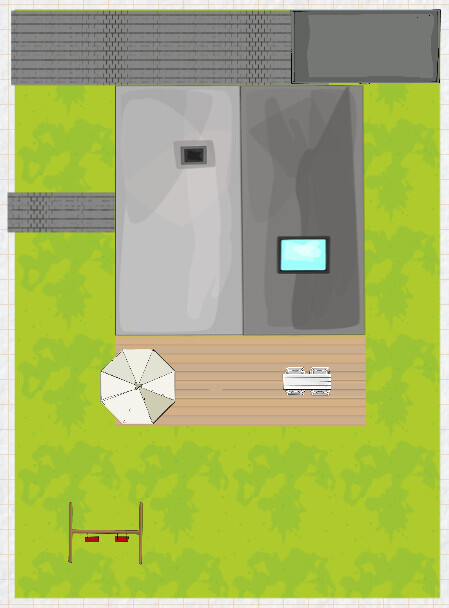

Do you mean like this? That would be perfect, but unfortunately it’s not allowed. I have to keep a 3m (10 feet) distance from the northern boundary. :-(
Garden view with house, gray roofs, wooden terrace, sunshade, and play area on green lawn.
11 Jan 2021 22:51
flitzpiepe schrieb:
Building envelope, building line, and boundary: Building envelope 10 x 12 m (33 x 39 ft), distances from the edge are 3 m (10 ft) to the north, 3 m (10 ft) to the east, 4 m (13 ft) to the west, approximately 9 m (30 ft) to the south.
Perimeter construction for a garage is possible on the east side. A 1 m (3 ft) clearance is required on the west side.
Please check that again.
The 1 meter (3 ft) on the west side doesn’t make sense to me because, in my opinion, there needs to be 5 meters (16 ft) of parking space in front of a garage.
Also, why isn’t construction allowed directly on the northern boundary?
Or did you misunderstand the boundary construction rules? That might be the case 🙄...

flitzpiepe schrieb:
The green box probably represents the property. Neighboring plots are to the north and east; streets are to the west and south. The blue box indicates the buildable area of the plot. The red box St/Ga may only be developed with parking spaces or garages. You can also see the one meter (3 feet) there.
Excerpt from building regulations: Parking spaces on non-buildable property areas
The sentence is from the development plan and is clear to me. The 3-meter (10 feet) strip along the northern boundary is neither "buildable plot area" nor "designated area for parking spaces or garages."
But you gave me some hope. I might ask the building authority if it could possibly be approved. The surrounding buildings are actually quite far away, and since it’s still a new residential area, there are no unusual fruit trees planted that I would be shading.
