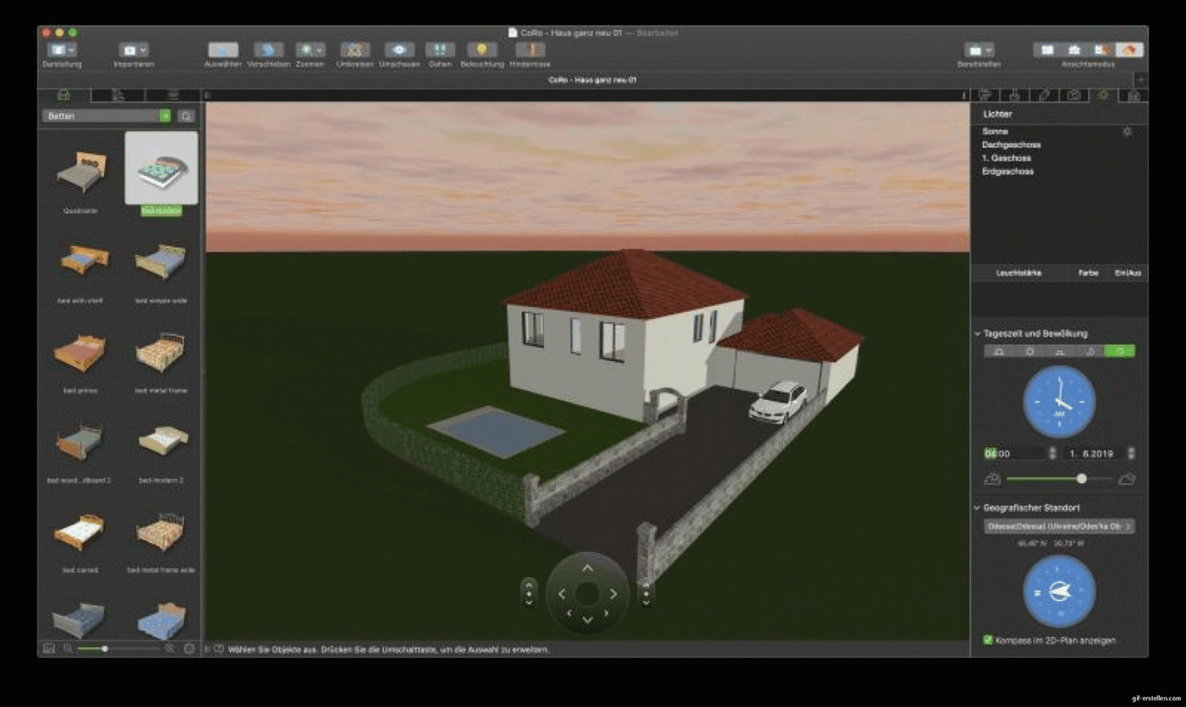

Attached is the sun path for June 1st, showing the house from the front.
3D-Hausmodell in Design-Software mit rotem Ziegeldach und Garten

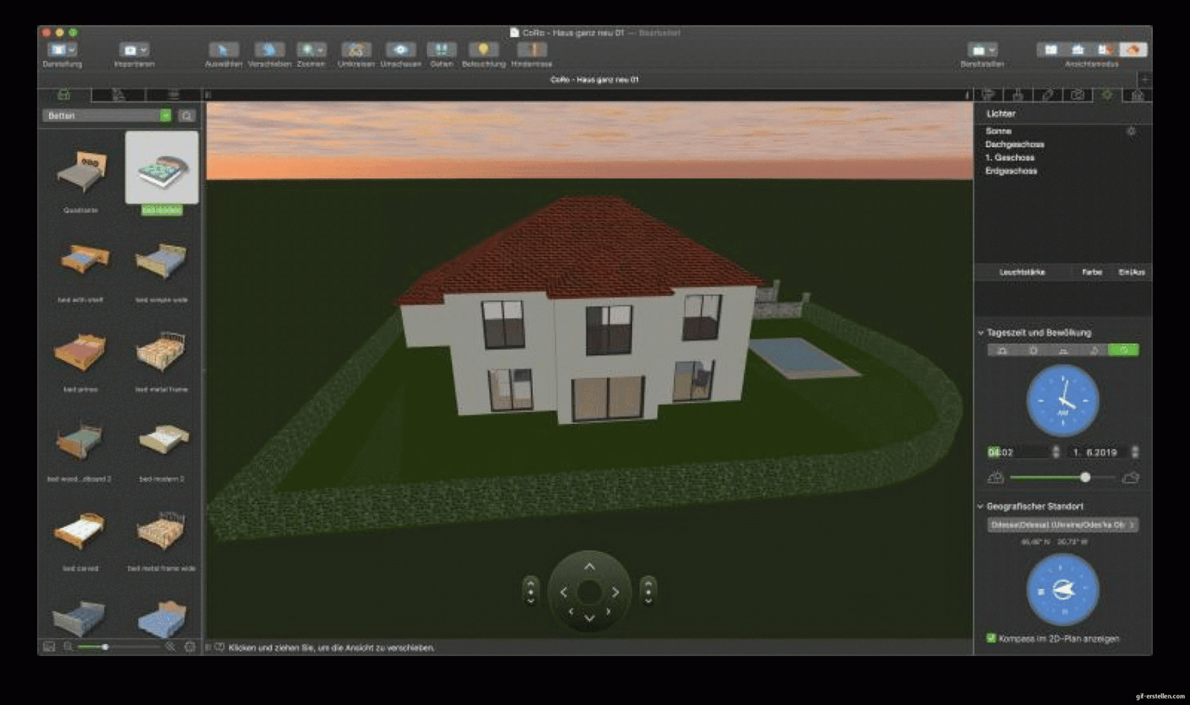

The same view now from the back side of the house. Garage driveway.
3D house model on plot with fence, driveway, and garden in design software

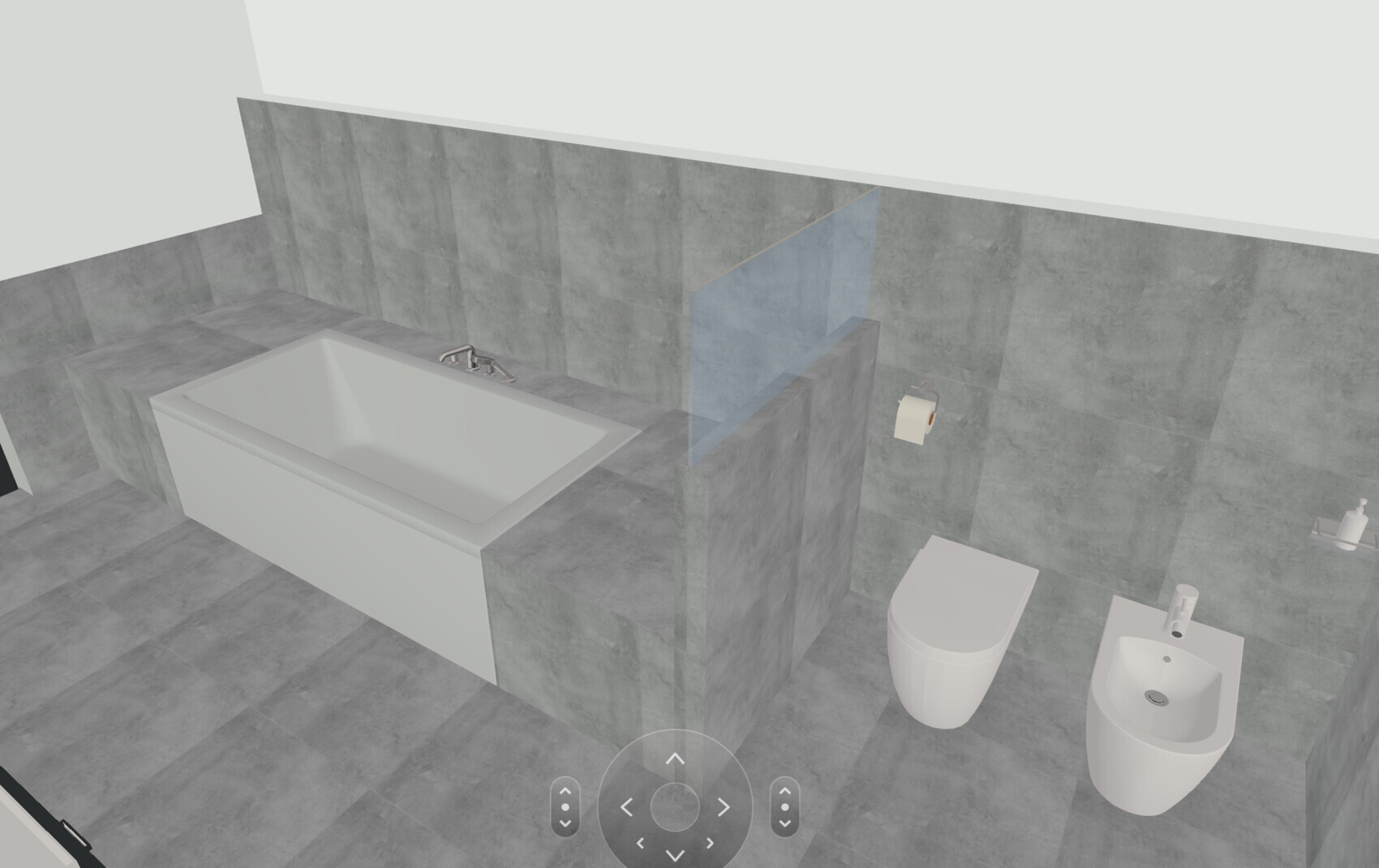

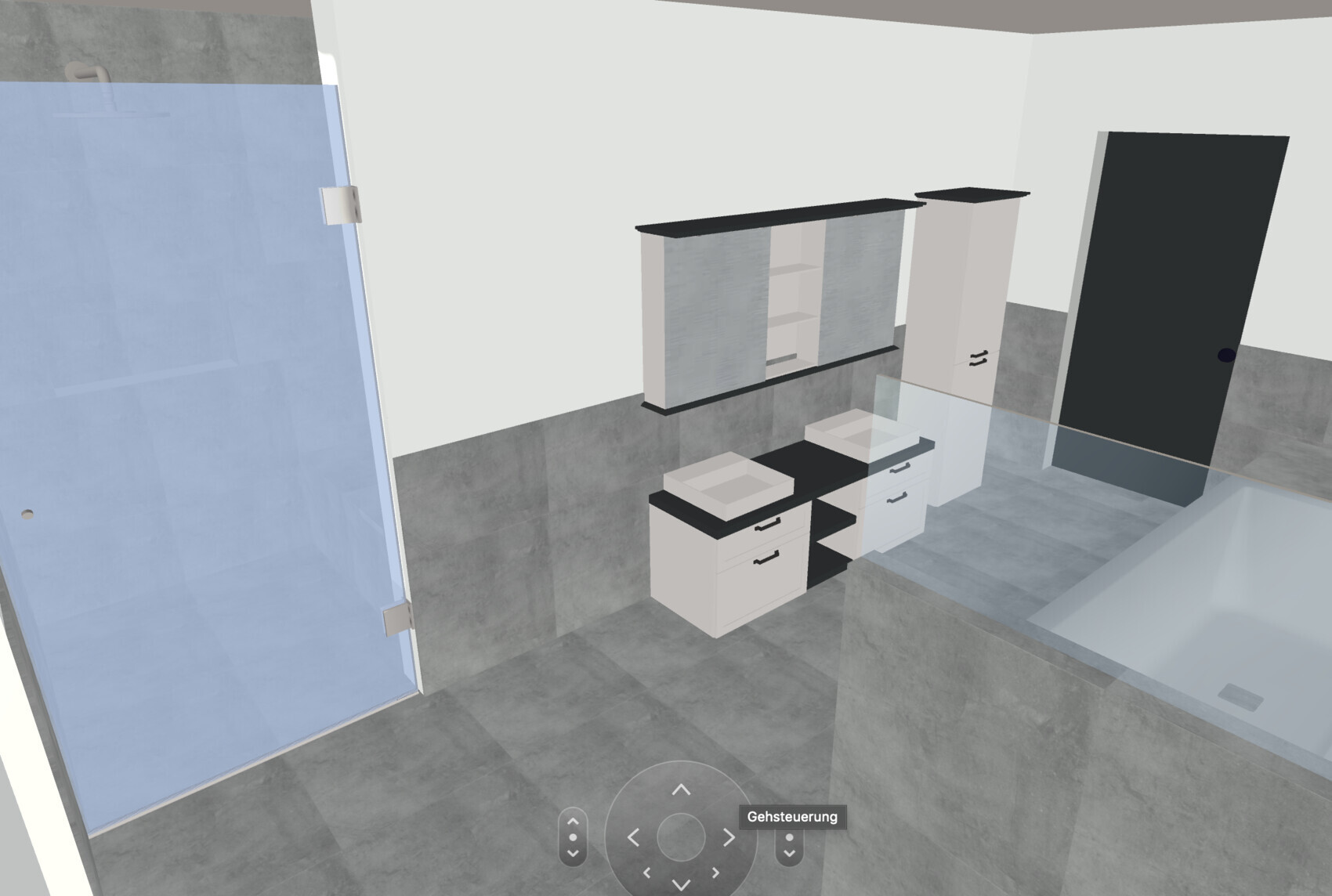

The bathroom should look like in the pictures. This is, of course, just a rough idea.
Three-dimensional bathroom with bathtub, gray tiles, and window
3D bathroom with built-in bathtub, toilet, and bidet in gray tiles
3D bathroom with vanity cabinet, wall shelves, bathtub, and door
Far too much detail for a preliminary plan.
