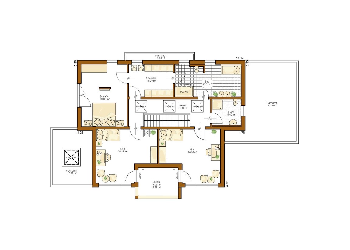

I will try it out this evening and share the new idea here.Something along these lines.Kitzlinger House Dornhan

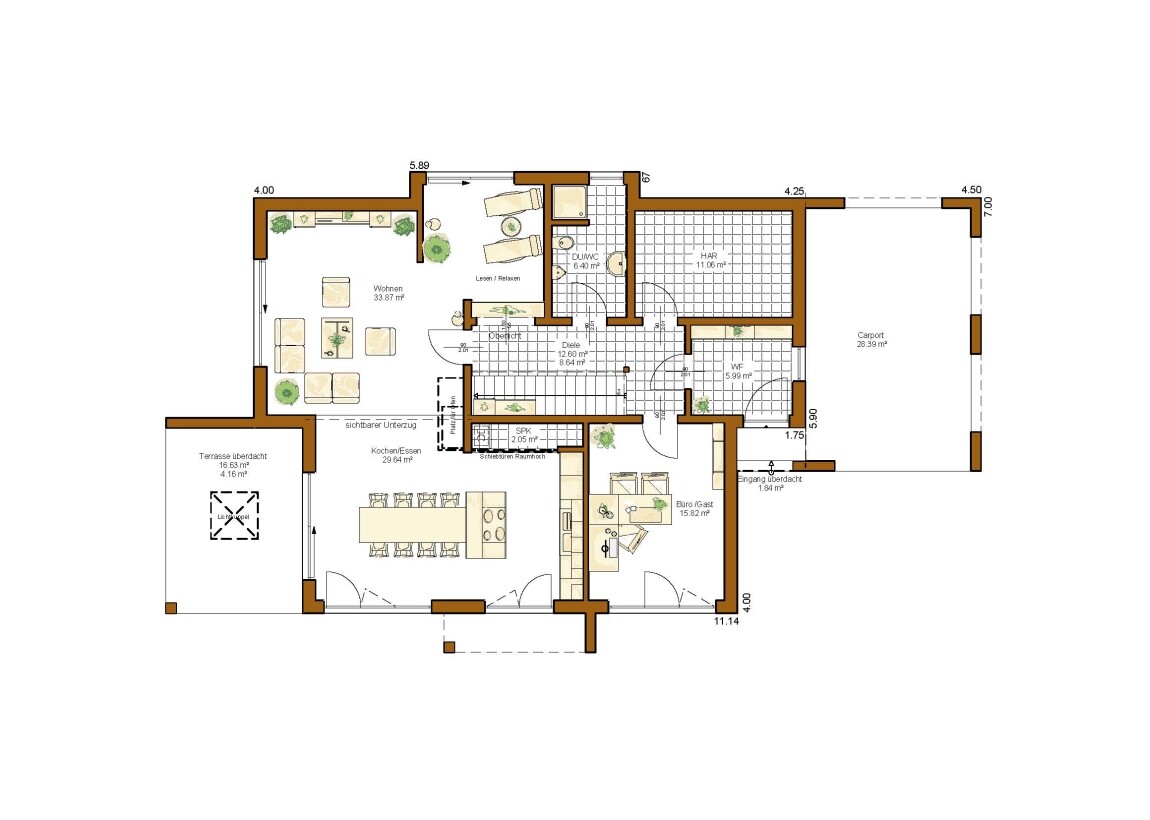

haydee schrieb:
I think the entrance for the office/living area is well separated in the Rensch-Haus Orlando Yes, not bad either – I’ll take the liberty.
