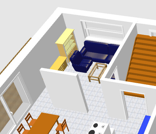

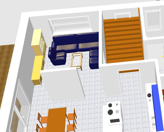

I keep thinking about the room divider in the living room. I would need to see it in 3D, which I would also recommend to you. The hallway in front of the stairs becoming so narrow also makes me uneasy. The narrowing does not feel very welcoming when entering through the door.
I think you need to fully understand the roof slopes before continuing with the planning on the upper floor.

The hallway in front of the stairs being so narrow also makes me somewhat uneasy.You find 1.4m (4.6 ft) narrow? The hallway in our rental apartment is 1.2m (3.9 ft) wide, and there we still have to hang coats and place shoes, which won’t be the case with the 1.4m (4.6 ft) here.Regards

Such partition walls can be seen in various model homes. People want an open layout. But somehow, the TV has to have a place. ;-)
I’m not a fan of them; they take away too many options (like extending the table, for example), and I don’t like having two doorways into the living room either. But that’s a matter of personal taste...
