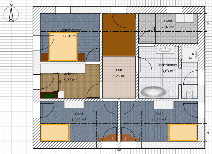

The sloping ceilings concern me a bit. On the upper floor plan, I drew a 1.2m (4 ft) line, where the ceiling height should be 2m (6 ft 7 inches). I assume a knee wall of 80cm (31 inches) (since 75cm (30 inches) is measured on the outside). Otherwise, we hope you can point out “blind spots” we no longer see 🙂

The kids’ rooms are too narrow – really poor room layout.ypg schrieb:
No quick fixes: Your kids’ rooms have an impossible layout.Zaba12 schrieb:
EDIT: The kids’ rooms are a disaster.WilhelmRo schrieb:
The kids’ rooms are "huge," and so far no one has felt like they’re narrow or cramped. (Or everyone is lying to our faces : )They’re now different in size and wider than your earlier attempts 😉 In your initial draft, the rooms were 2 meters (6.5 feet) wide, then just under 3 meters (9.8 feet) including the sloped ceiling. Now they have a more standard size of 3.5 meters (11.5 feet) including the slope.

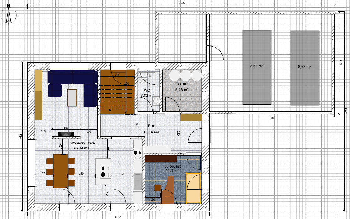

Nice to hear from you again and that you’re feeling well. It’s always nice to read that 🙂Thank you. Yes, it has grown a bit more : ) from 165m² (1776 sq ft) to about 185m² (1991 sq ft) in the end. I often read threads like these where people give updates, and I always find it very interesting to see how a "wish" became reality – and what changed from the original "wish" to the final outcome : )
WilhelmRo schrieb:
Yes, it has increased a bit more : ) from 165 sqm (1776 sq ft) it ended up being around 185 sqm (1991 sq ft)
Whoops, 20 sqm (215 sq ft) more – great salesperson. 😉Great that you’re sharing your finished floor plan and photos of the completed house with us! 🙂 Unfortunately, few people do this, and I always find it really exciting to see the final result. The bathroom with the tiles looks fantastic, and I also really like the staircase. I do find the small, tall windows in the living room a bit unusual. Was there a specific reason you designed them that way? Wishing you a wonderful time and lots of joy in your new, beautiful home!
WilhelmRo14 Jun 2022 12:53Würfel* schrieb:
I find the tiny, tall windows in the living room a bit unusual. Was there a reason you designed them that way?It was purely a matter of personal taste – nothing spoke against having standard-height and regular-sized windows. I always joke, "So the neighbors can’t stare at the top of my head while I watch TV" ;D
The original idea was to avoid having the windowsill at neck height, but my wife had a better idea – now the windowsill is flush with the wall. 🙂
