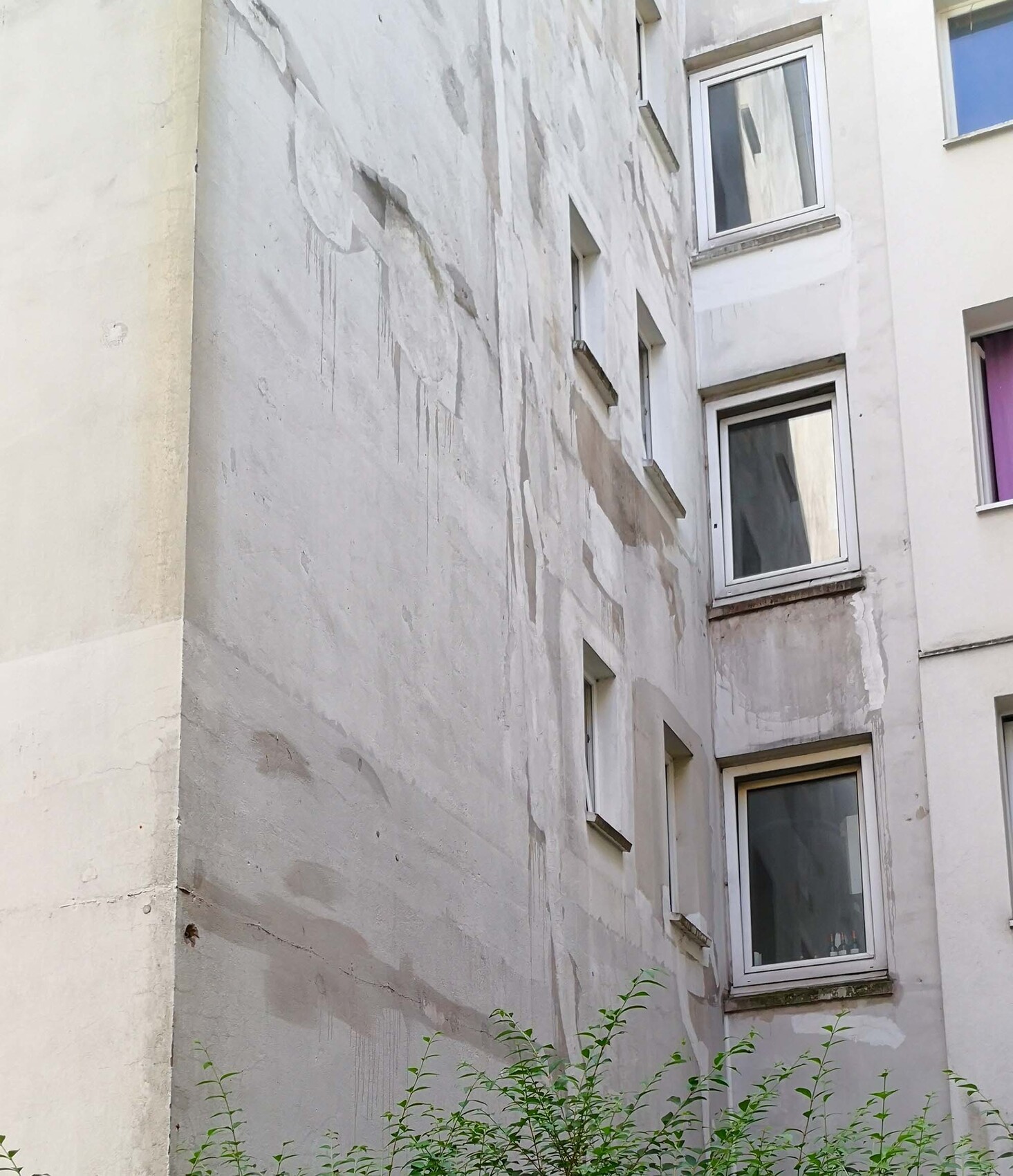

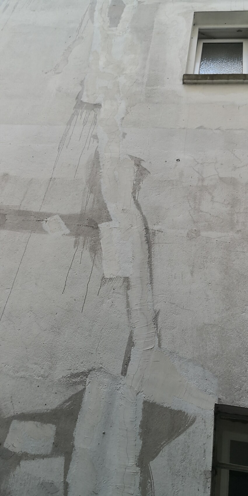

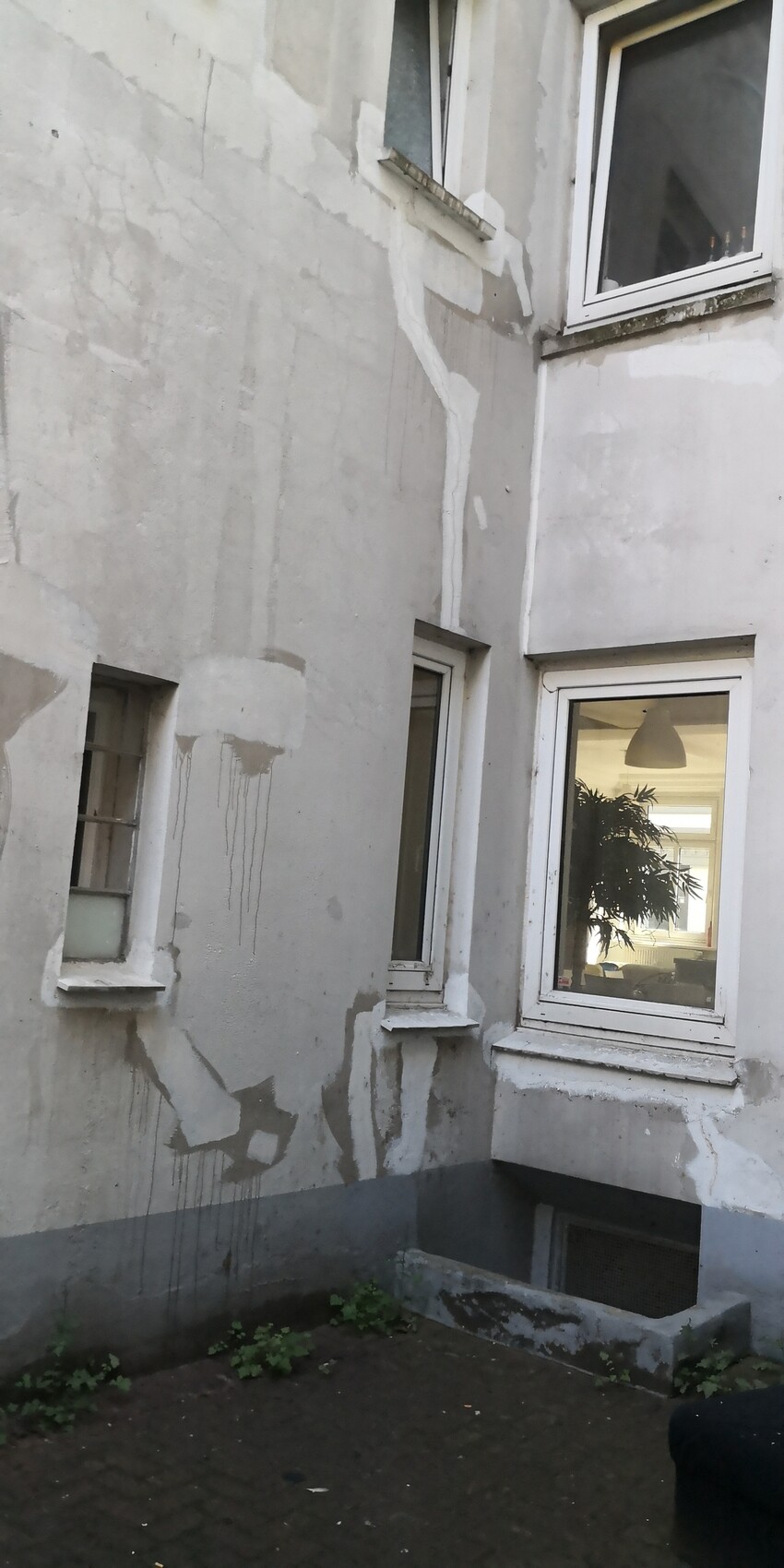

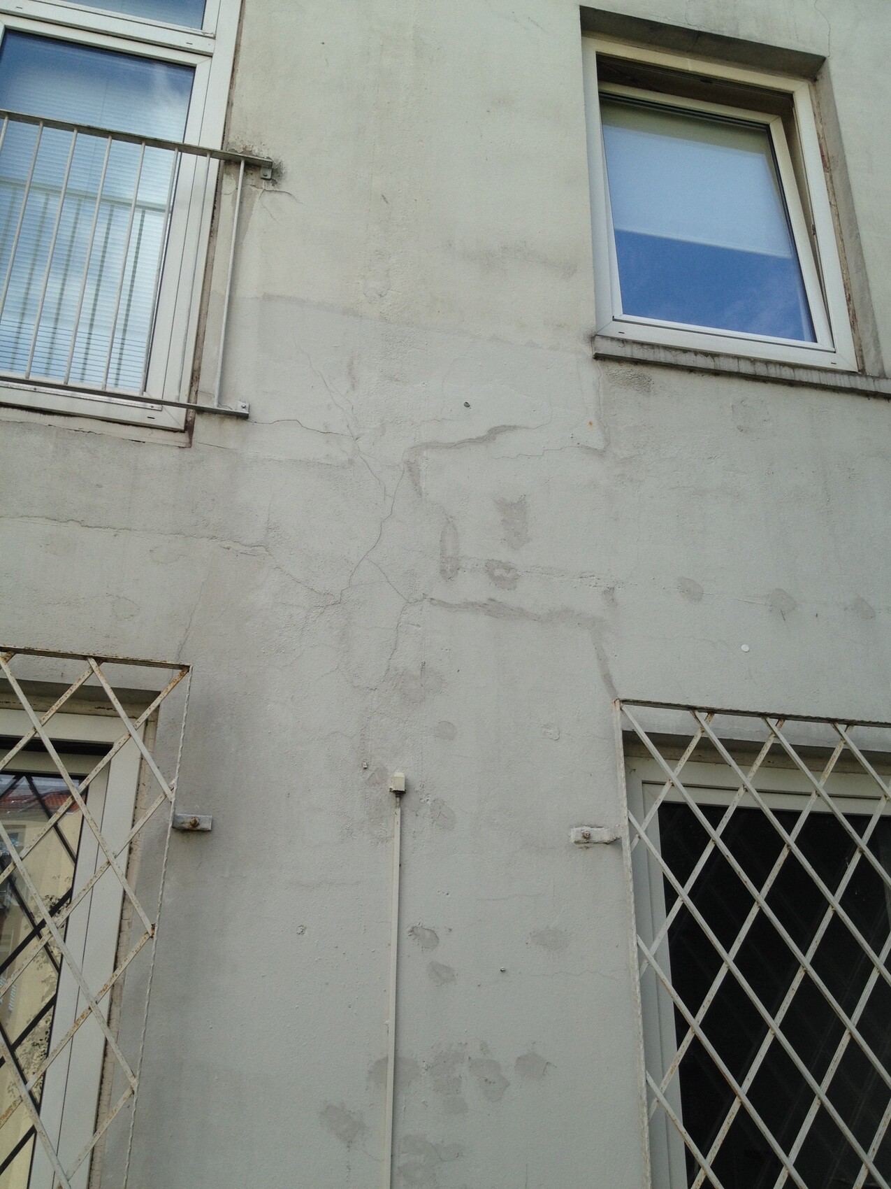

Hello, our house needs facade renovation. We have received very different offers and renovation methods, and it feels like every contractor recommends something different. What would be the best approach? Is paint stripping advisable or necessary? Has anyone had experience with (Kobau) elastic mesh, or does it cause the building to lose breathability? As you can see in the photos, the facade already has many patched cracks.

Moisture is partially entering through the cracks, causing mold indoors. This means the cracks need to be repaired and the facade should then be repainted. However, a tradesperson said that the old paint must definitely be stripped off beforehand. But as I said, it feels like every contractor tells a different story.

OMG – continuous cracks reaching all the way through to the interior...
More than just some filler and paint will be needed here. To be honest, I would consider a thorough renovation, including insulation. It won’t be much more expensive.
