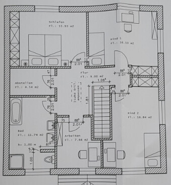

Hi everyone,
a quick question and I hope you can help us decide. We currently have a storage room on the upper floor (4.54sqm (49 sq ft)). Below it is a bathroom (11.74sqm (126 sq ft)). We definitely want to make the bathroom a bit smaller, around 10sqm (108 sq ft). That would leave the storage room with about 6.3sqm (68 sq ft).
Since our bedroom is above the storage room, we are considering converting the storage room into a bathroom with a toilet, sink, and shower. Access would be through the bedroom, and it would be just for us 😀

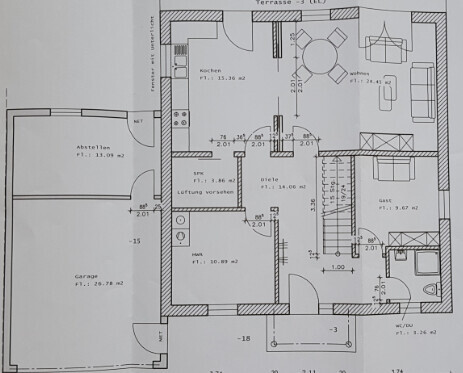

The bathroom downstairs would then be for the kids later on—our first child is just 6 months old now—for bathing or if there’s a queue. If needed, there would also be a guest toilet downstairs.
What do you think about this? The cost would be reasonable, around $3000.
We realize that this would be a luxury. Many people might prefer to keep the storage room for extra storage space. On the other hand, we have a large utility room and a spacious guest room where things can be stored. Plus, there is a big garage and a large shed on our property, about 60sqm (646 sq ft). Of course, some items probably won’t be stored in the shed or garage (like bed linens or towels).
Whenever we think about what might go in the storage room, not much comes to mind besides a vacuum cleaner, suitcases, or similar items. But those things could be stored elsewhere—vacuum cleaner in the home office and suitcases in the attic.
Of course, over time stuff accumulates that you want to store, things you don’t even think about now, but we don’t want to clutter the space unnecessarily either 🙂
What do you think?

Above, below...
You can never have enough storage space 🙂I have had quite different experiences, especially with houses that have basements. About 90% of these are cluttered storage rooms filled with stuff that could have been thrown away long ago or could still have been sold if handled in time. The remaining 10% are used for hobbies, wellness, and similar purposes.
Obviously, insufficient storage space is also a problem.

sauerpeter12 Oct 2016 13:02For now, let's not go into detail about the door to the bathroom (upper floor). If the wall of the current storage room is moved towards the bathroom, of course, a solution will need to be found for the bathroom door. But there is an architect here anyway 🙂
Do you or your wife want to clean three bathrooms?
Also, I don’t think you would spend only €300,000 (about $300,000) on remodeling a bathroom to current standards, unless you do it in an economical way.

I find the living space in such a large house relatively small. Have you looked at a living room of this size (show home)? If you plan an additional bathroom on the upper floor, I would definitely design at least one bathroom to be accessible directly from the bedroom.
