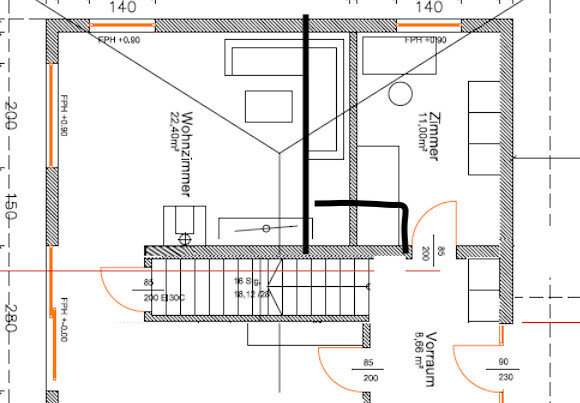

Hello!
- What do you think of our plan (carport is on the north side)?
- What could be improved or where do you see potential issues?
- We’re also not sure whether the access to the upper floor should be from the living area or from the entrance hall. What are your thoughts?

Nida35a4 May 2021 10:10
What I like about the new upper floor plan from @Würfel* is that there is no longer a line of sight through the house from front to back with windows, which means going to the bathroom with items in your arms is more comfortable.
4 May 2021 10:45
I would probably add a small storage room there as well.
Floor plan: living room on the left, room on the right; staircase in the middle; entrance area at the bottom; doors/windows visible.
