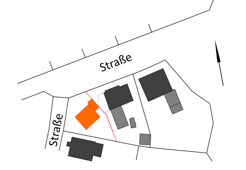

Property plan with road layout and building plot marked in orange
The house is quite small (9m × 10m (30 ft × 33 ft)). Whether that is sufficient depends on your requirements, which you have not detailed enough.

My advice: Build directly adjacent, possibly with an integrated garage. Anything else would waste space, as the plot isn’t that large after all.

The house is quite small (9m * 10m [30ft * 33ft]). Whether it’s sufficient depends on too few details about your requirements.
I’m afraid the setbacks on the left side toward the street might not have been maintained; otherwise, it’s certainly worth considering. The driveway would need to be looked at. But thanks already for the creative input.

Escroda schrieb:
My advice: Build directly adjacent, possibly with a garage integrated into the house. Everything else is a waste of space, since the plot isn’t that large anyway.
Yes, that’s probably the best solution. It might not fit my (not sufficiently detailed here) requirements at all (hello questionnaire, I guess I still need to fill you out).
