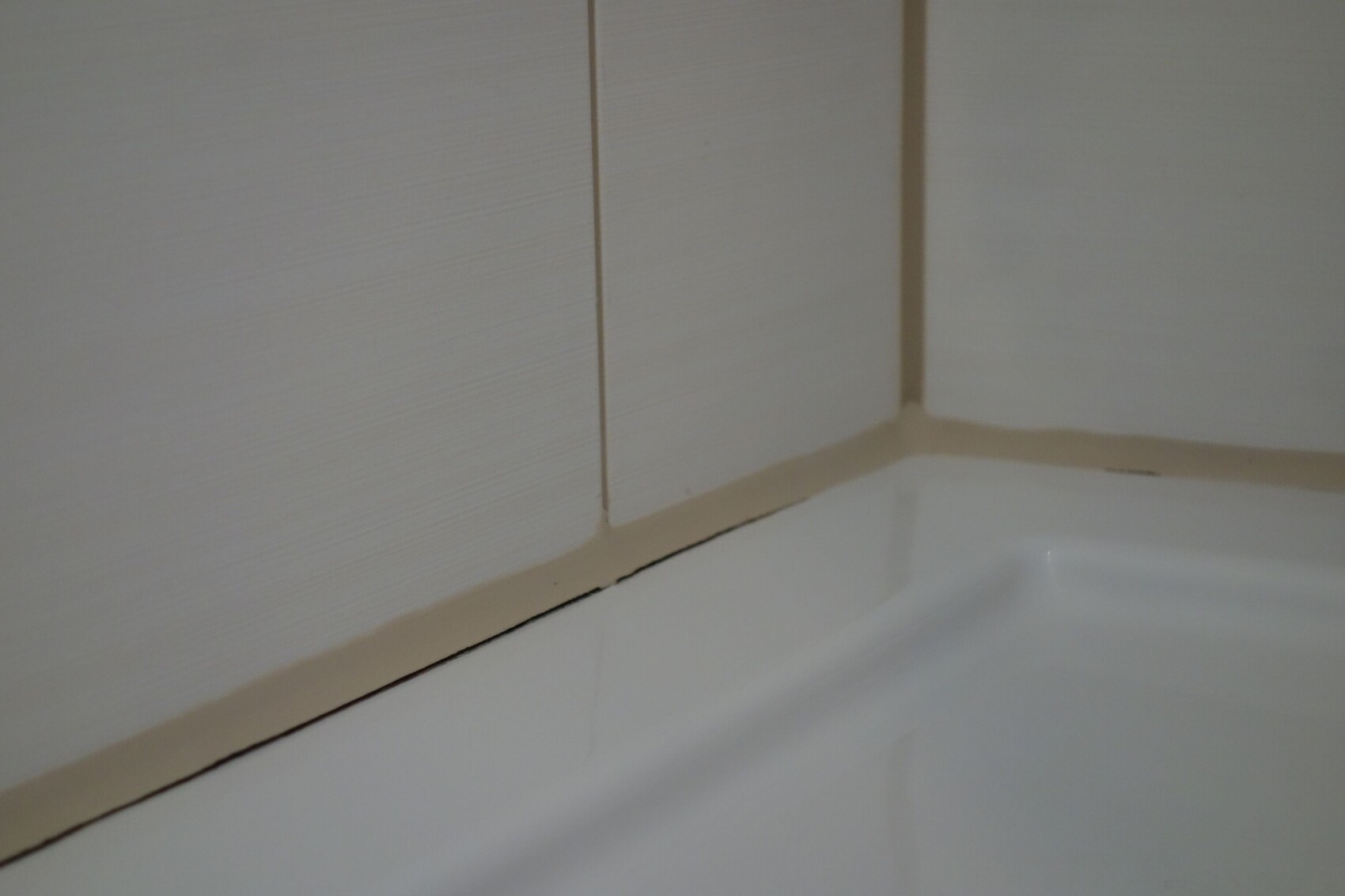

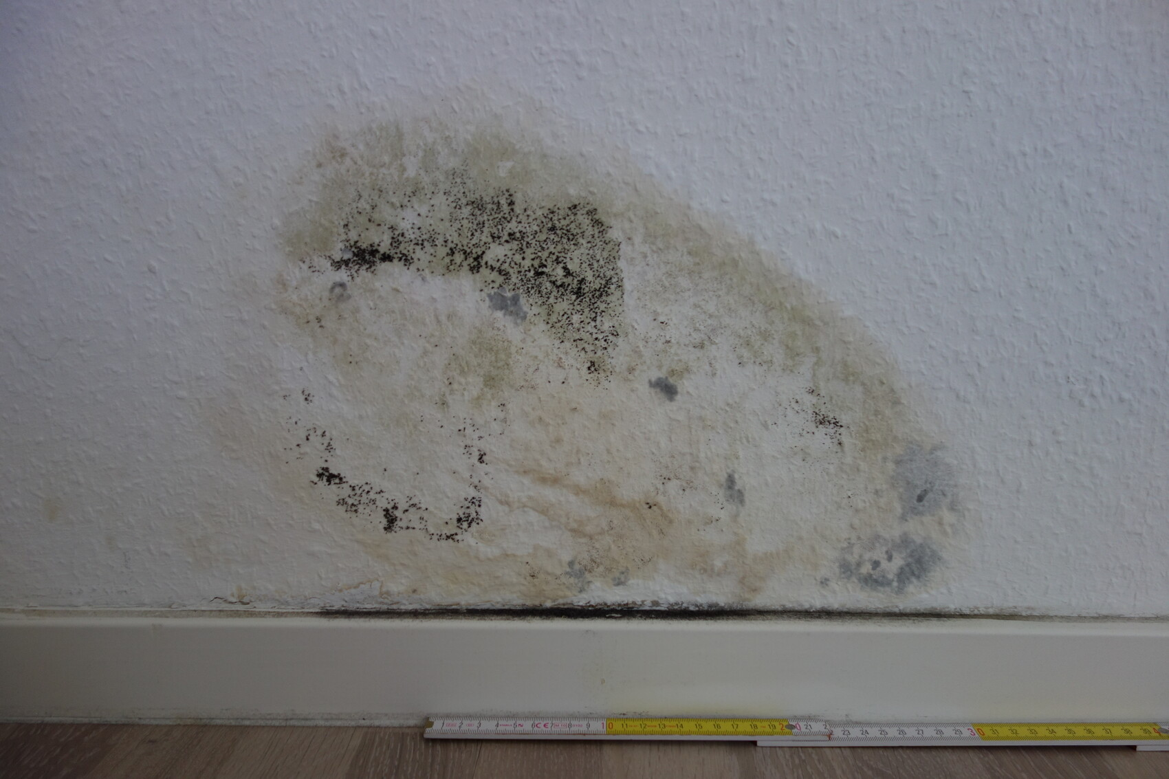

Our acrylic shower tray used to move a lot when standing on it. Then the grout came loose (see photo), water got underneath the tray, mold appeared on another wall, and the general contractor had to invest significantly for a renovation (now: tiles, see photo). The landlord got away with organizational trouble (however, there was a threat of legal action against the contractor). For us as tenants, of course, it was a lot of hassle, including several days with a construction drying device 🙂.
Close-up of a bathroom wall tile corner above the white bathtub; beige grout with gap.

Mold stains and moisture on white wall above baseboard, measuring tape on floor.
