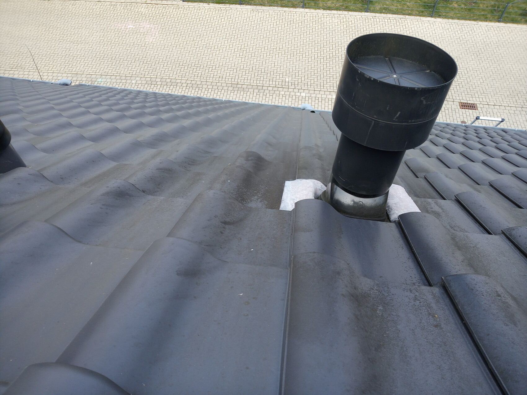

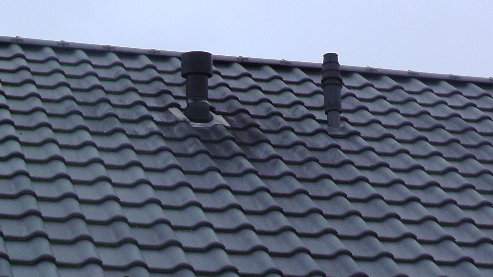

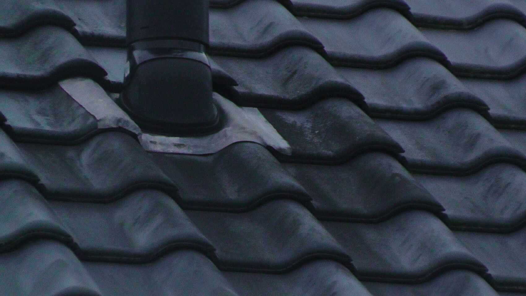

At the end of 2020, I discovered a much worse issue: The supplied roof penetration DH160-KS consists of a collar and a metal flashing. This metal flashing comes in two colors. We chose the black version to match the anthracite-colored roof tiles. What happened? The paint completely peeled off and spread onto the adjacent roof tiles. Pluggit has not commented on this. After several weeks, I unfortunately received no response. Anyone considering installing something like this should look at the photos. I estimate the damage at about 1000€, because Pluggit obviously used paint that is not weatherproof for outdoor use.
Maybe someone here has an idea how I can fix the damage as cost-effectively as possible?

The paint peeling off the lead flashing is also nothing unusual. If I were you, I would use a cold enamel to fix it. However, be prepared that this will need to be redone regularly. That’s just how external coatings behave.

Häuslebauer1246 Mar 2021 16:37Thank you for the response. It’s becoming clear to me that almost every tradesperson and manufacturer is focused on maximizing profit, which leads to disappointing customers. I never thought such behavior was possible. However, it seems intentional, which probably explains why prices are so high. Customers end up paying for incompetence, shortages, and defective products.
Fortunately, there is a proper fitting for my roof tiles. Since I have clay material, the color will not peel off. Imagine buying a car that loses 99.9% of its paint after just 5 years, and the manufacturer never comments on it. Anyone buying from or via Pluggit should reconsider carefully. In construction contracts, I would make sure some companies are explicitly excluded. A typical clause is "or from an equivalent manufacturer," which allows developers to install almost anything they want.
Does anyone here have experience with removing the ugly color, possibly using a pressure washer? I almost assume that I might still have to replace 30 roof tiles, and I want to emphasize again – the company Pluggit apparently cannot use a paint that withstands weather conditions. Unbelievable!

Yes, definitely. Many contractors specialize in using high-pressure cleaning to remove all sorts of things from roofs, making old (or dirty) roofs look like new again. So it’s possible—you just have to be careful with the pressure, just like when pressure washing a car or other surfaces.
