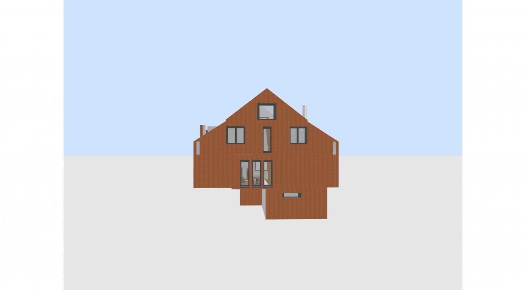

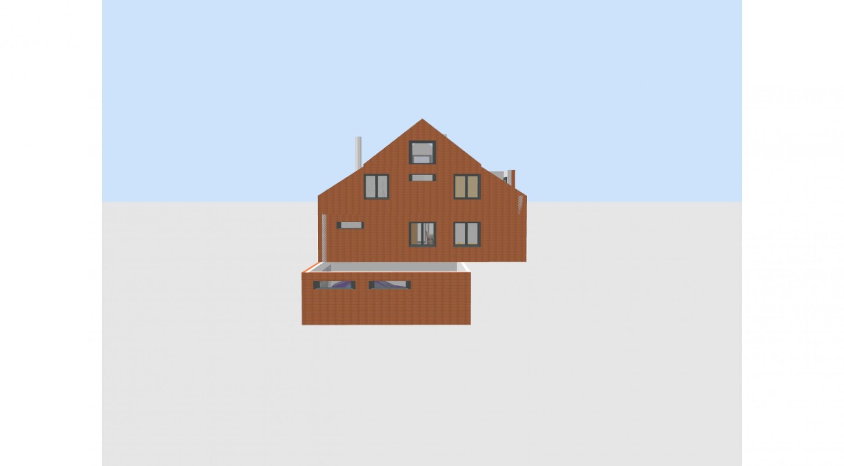

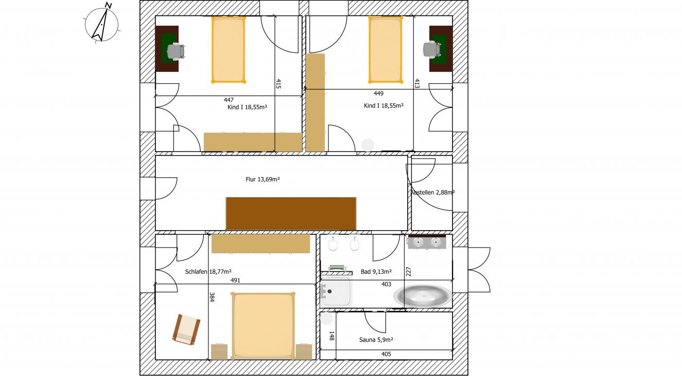

Hello Kisska,
to be honest, I still don’t find the orientation quite successful. Now, in the basement you have the bathroom and kitchen facing south, and the living room in the northwest...
On the ground floor, the bedroom and bathroom are also facing south. This means the bedroom will get quite warm, and the sunlight in the bathroom is somewhat “wasted.” I would prefer to swap the sides on the upper floor to give the children more light. After all, they will have to do homework or play during the day in their rooms. A northwest or northeast orientation might not be ideal for that.
Also, what is the reason for this “partial” basement? Is it more cost-effective than a full basement?

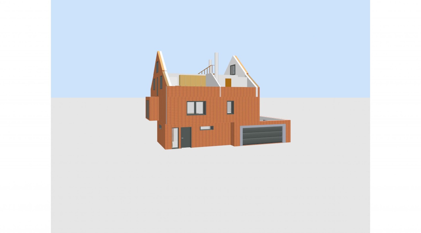

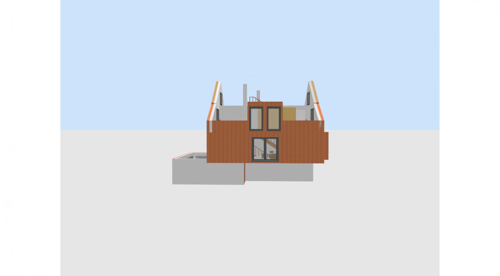

Thanks, WildThink, for the comments.
Unfortunately, there isn’t much we can do about the orientation. It is simply a north-facing plot. Our friends’ children’s rooms are quite similar, and because of the large windows and the dormer, it’s not dark at all. Our office in the apartment right now also faces northwest and has two large floor-to-ceiling windows, and it’s not dark either. We don’t really have any true south-facing rooms since the ridge runs south to north. Well, having the living room face south just doesn’t make sense. Why would we want to spend all our time looking at the street when we have such a beautiful garden? 🙂
The partial basement is considerably cheaper for us. It’s a sloped plot, so very little excavation is needed at the front for the basement. And actually, we didn’t want a full basement at all. This way, it’s a sufficient compromise.
The entrance door is located right next to the garage. We can’t enter through the garage because of thermal bridging. There is also double insulation between the garage and the house. We didn’t want cold air and moisture from the garage directly entering the house.
