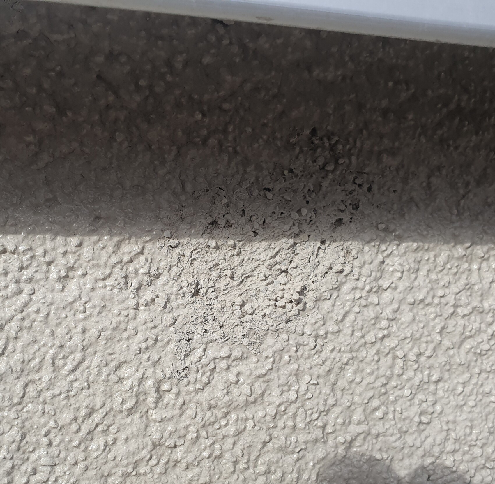

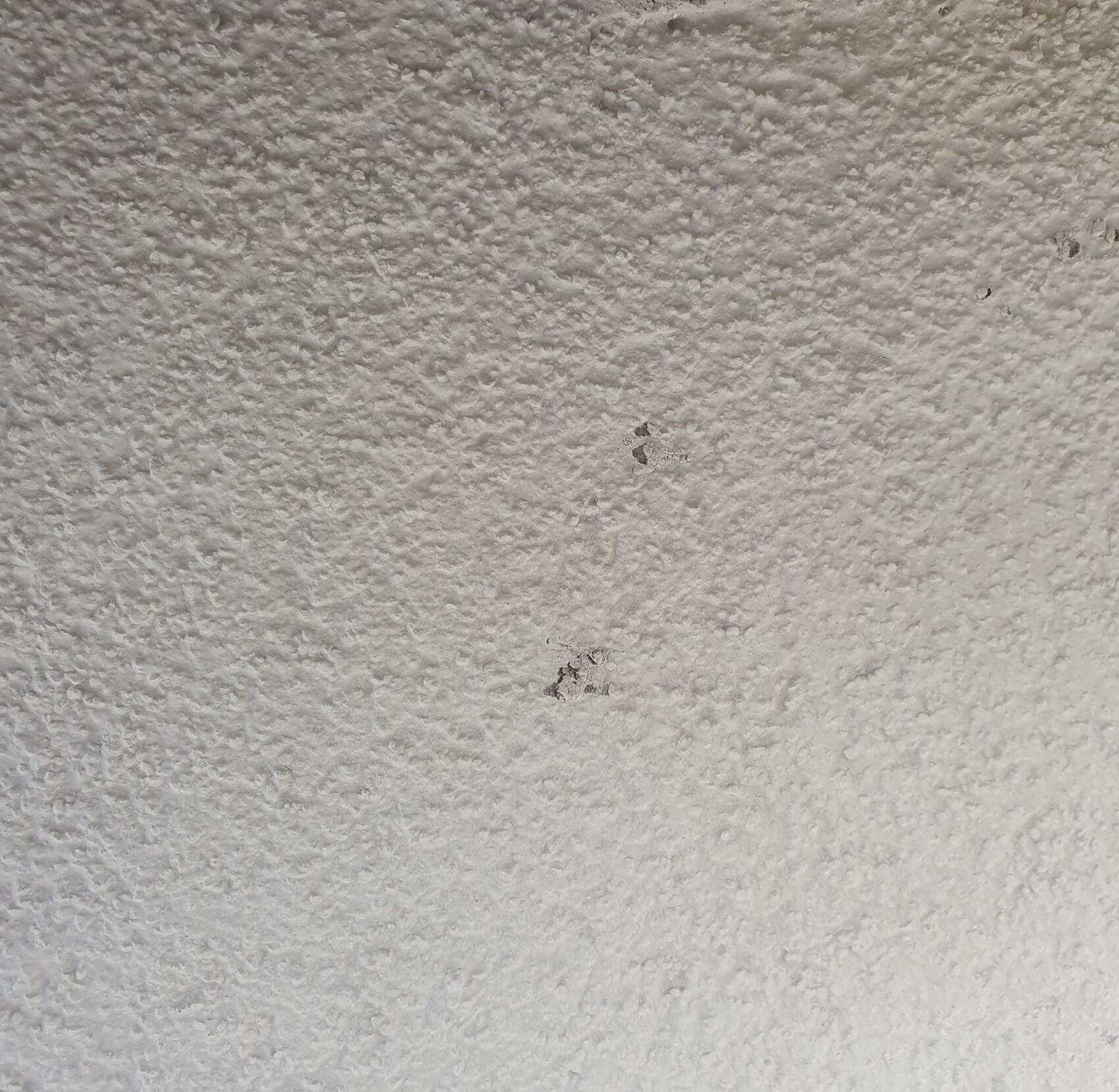

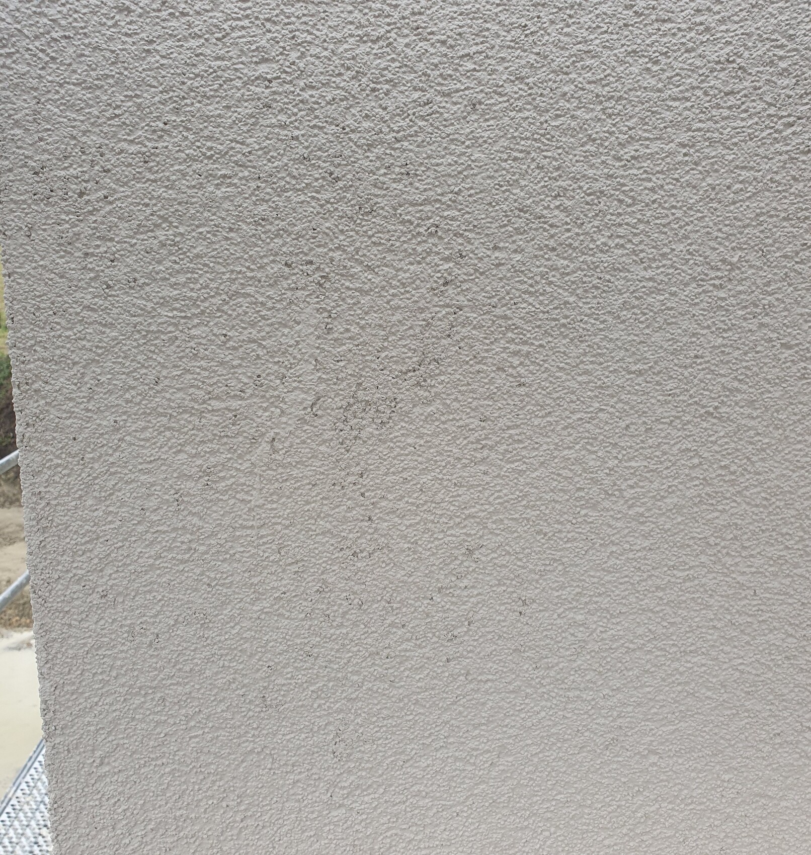

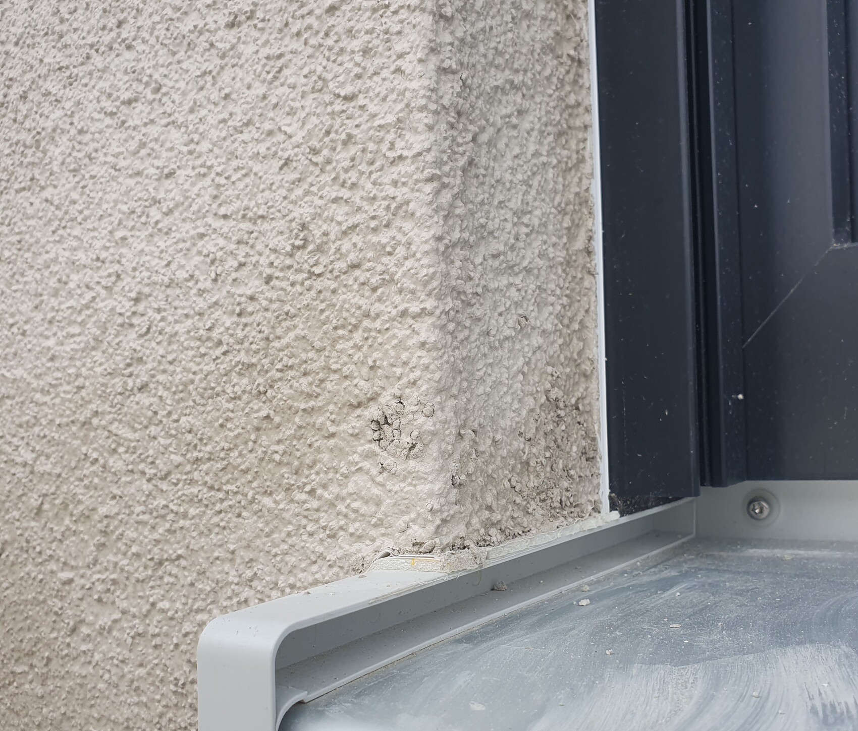

attached are some example photos showing the condition around the house... According to the contractor, a leveling coat should fix this... Is that possible? The "texture" already seems insufficient.
If not, what should be done?
Thank you

Before you get overwhelmed again with a flood of expert knowledge, here is the perspective based on my modest experience.
You had a ready-mixed pigmented silicate render applied, probably with a 2 mm (0.08 inch) grain size. Please correct me if that’s not the case.
The problem: the render in the bucket was not diluted with water—about one glass of water per bucket is needed. Because of this, the applied ready-made render is too thick and harder to smooth out. It was probably also rubbed too late, after the render had already started to set.
And now it looks the way it does.
One coat of paint will cover it, of course. But with a 2 mm (0.08 inch) grain size, not much of the original texture of the render remains. That’s the disadvantage of a fine grain size. If you paint over twice, the wall becomes smooth.
What do you want to do now? A legal dispute is risky. Paint over it? Basically, these things tend to fade from notice after a few months.
Who looks at your window reveal from 10 cm (4 inches) away?
I would leave it as it is. Karma is a bitch. Make a contract with the painter or construction company that they will repaint the house for free in 5 years.
Of course, you pay for the materials. In my experience, the exterior render always gets some dirt or marks in the first few years.
If you have to do it, you might as well paint the entire surface. Touch-ups always show.

Mineral-based topcoat plaster has been applied...
Yes, it is becoming smooth... and this is already partly the case now
