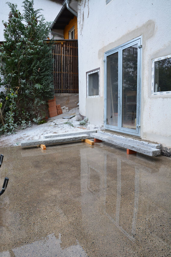

I designed a terrace like this and am very happy with it, among other reasons because it is so solid. Tiles can’t loosen or anything like that—the surface does not need "extra" finishing. The material is visible (and looks good to me). Here is a picture of the unfinished structure:
The surface was not polished to avoid slipping when it’s wet. If you have some basic DIY skills, you could also consider grinding it yourself. In my opinion, an angle grinder with a grinding disc is enough. My terrace was ground by a professional using machines costing several thousand dollars, but this wouldn't be necessary for an area of about 2 square meters (22 square feet).
Of course, a surface finished with an angle grinder won’t be as precise, but “handmade” has its own charm—which varies depending on the person doing the work. You can largely control the color using this method. Concrete can be easily pigmented, and if I remember correctly, there is even white concrete available, which is probably more expensive but allows for more color variety. (Otherwise, like a painter with a canvas, you have to incorporate the natural gray of standard concrete.)
