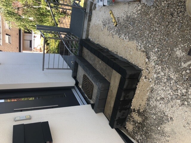

Patrick-BW27 Apr 2020 14:16trendyandi schrieb:
I’ve recently been working on our entrance platform… Here is the current status:Everything looks quite good. I would probably do it like this with porcelain stoneware tiles. Place boundary stones all around and fill with gravel, then add some crushed stone, and finally lay the porcelain stoneware tiles on top.
trendyandi27 Apr 2020 16:08Patrick-BW schrieb:
Everything looks pretty good. I would probably use porcelain tiles for this.
Set boundary stones all around and fill with gravel, then add some crushed stone, and finally place the porcelain tiles on top. As you can see in the picture, I have finished the edging and the "crushed stone base" at the platform. Once our paving stones for the driveway arrive, both the driveway and the platform will be paved... Until then, I have laid wooden boards on the platform.
