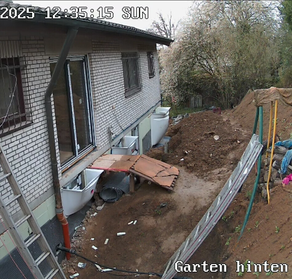

Additional images for clarification:
1. Before the work started 2 years ago – west side
2. Almost completed after 2 years – west side (-> The insulation at the problematic corner probably still needs to be extended!)
3. Before the work started 2 years ago – north side
4. During the work 2 years ago – north side (->The blue pipe still serves as emergency water supply for the lower garden area but can be removed, however, the slope transition is supposed to happen right at this CORNER!)
5. During the work 2 years ago – north side
6. During the work 2 years ago – north side
7. Early spring this year (preparation before second phase – organizing, cistern, some filling etc.)
8. Current status

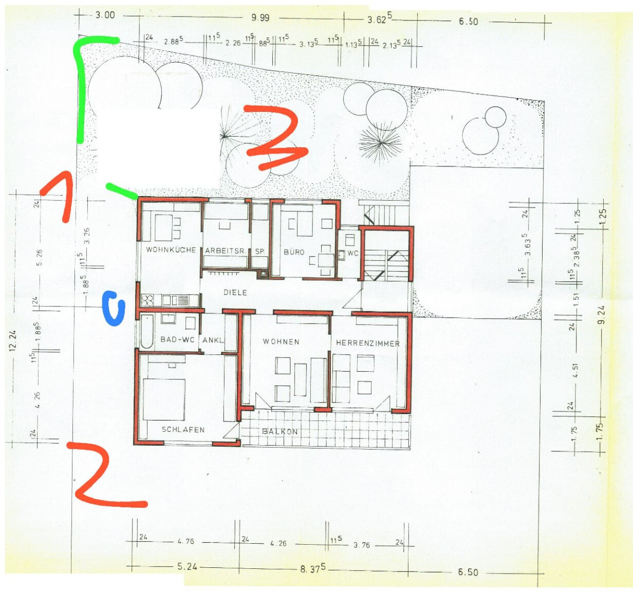

How I envision it in the future:
- Referring to the site plan, the green lines roughly mark where the garden would end at ground level. At "1" I would like an access path for the excavator (hopefully rarely needed) and probably more often to transport materials with a wheelbarrow. From the pictures, you can see that before I took over the property, everything simply sloped down to the west neighbor’s land; now the transition should start at point 1 on the site plan and later only a fence or hedge will separate us.
8. Current status
