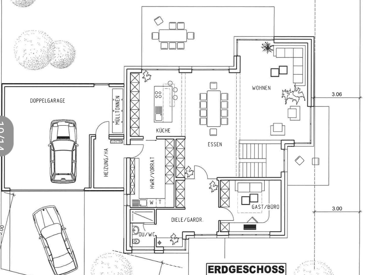

Large open living-dining area, integrated garage with access to the utility room, utility room directly connected to the kitchen, and a large roof terrace with a nice view
What do you not like? Why?

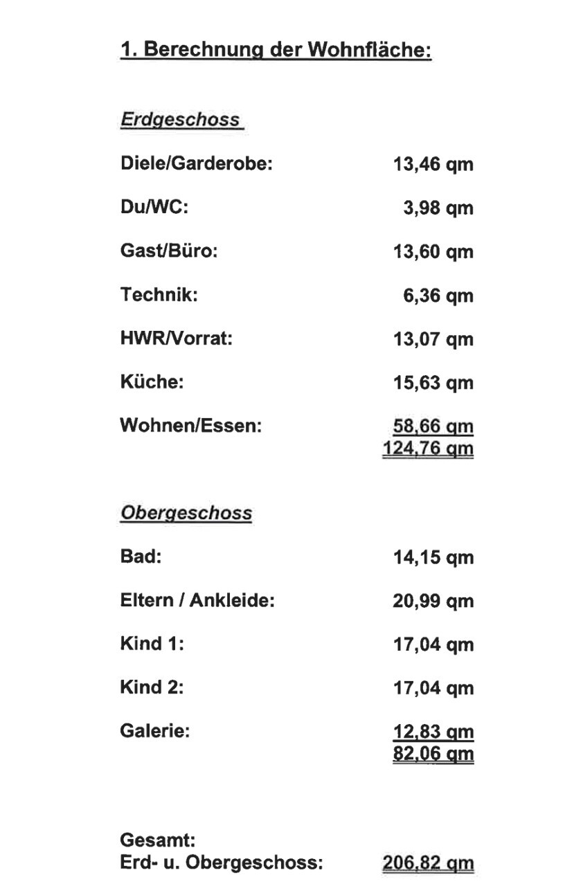

The house should be 170-180 sqm (1830-1940 sq ft), now it is 206 sqm (2215 sq ft). Only one corner of the upper floor was set back.
Why did the design end up like it is?
Our wishes were partially implemented by the architect
Good: large living area
Bad: living space increased by 30%
If you had to give up something, which details/expansions
-could you do without: separate heating room
-could you not do without: open architecture and roof terrace

- Where can further optimizations be made?
- What do you find problematic/would do differently?
- Is there another way to access the terrace without the awkward setback of the corner?
- TV wall in the living room? Best location?
- What do you think about the floor plans and overall design? I am open to ideas and suggestions

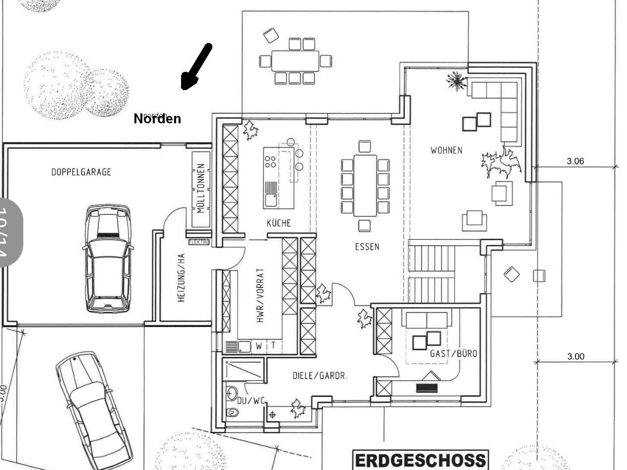

The plot slopes approximately 3 meters from the street (west-northwest side) towards the southeast. So the street drops about 1.5 meters towards the north and then another 1.5 meters towards the southeast. This would have been the perfect opportunity to add the site plan with a north arrow and slope orientation to the thread. My mind already has to do a little flip and imagine a layout.

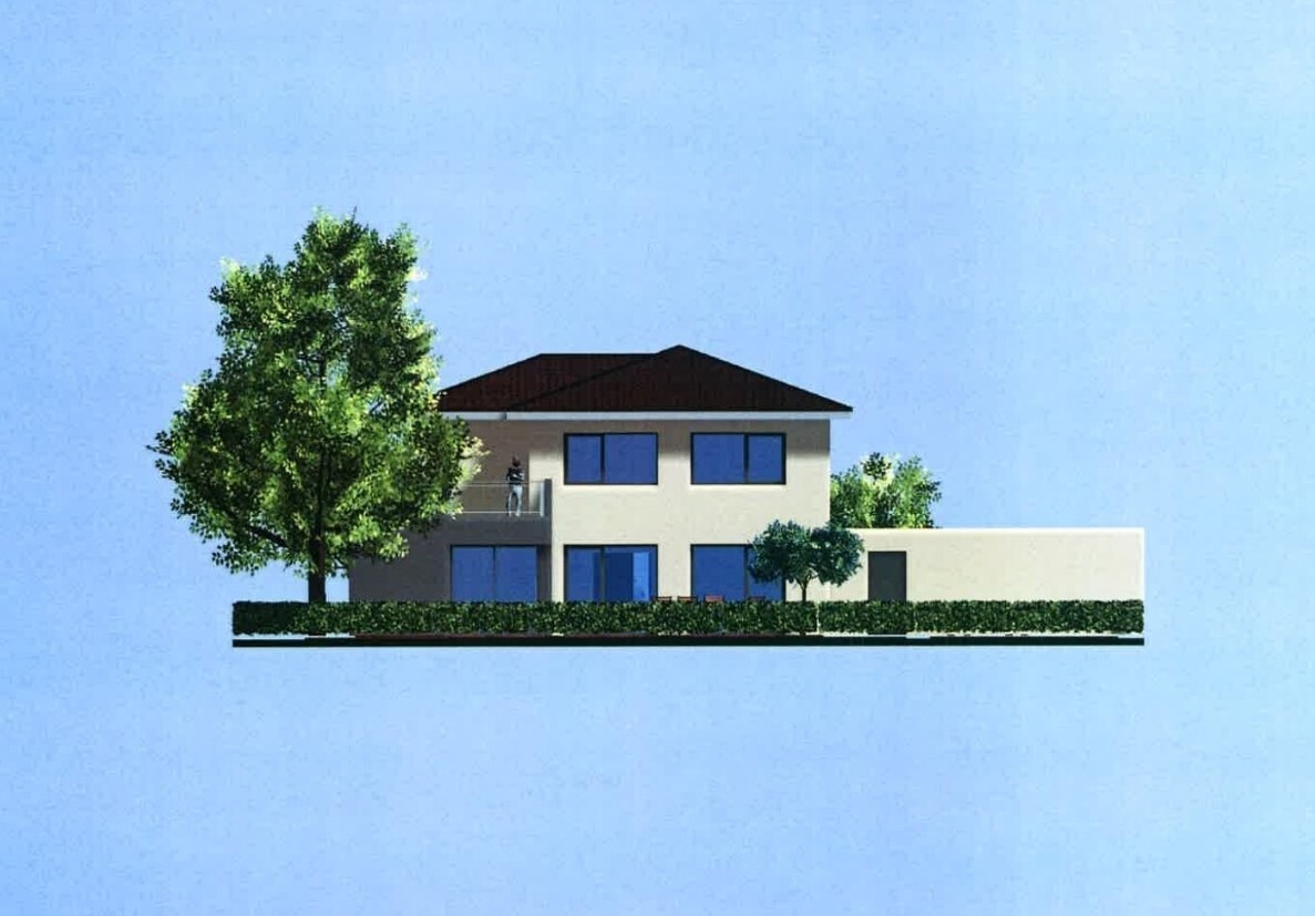

The slope has to be retained with a retaining wall, and the house will be lower than the street level. I’ll be straightforward: this is the wrong house on the wrong plot (if I understand correctly).
You seem to have gotten tangled up wanting a two-story house that is not allowed. So the ground floor is simply enlarged and the upper floor given a roof terrace to get your city villa. It seems somewhat acceptable that about 30 m² (320 ft²) are not really needed but must still be paid for.
But then ignoring the slope, which could be retained (and that doesn’t cost the builder’s money), I find overall a shame for the plot.
It would be good if you really look at YOUR plot, study it, and work with it (including the zoning/building regulations), instead of working against it. And don’t stubbornly fixate on something that shouldn’t be.
The basic idea here is obvious: a city villa with a basement and ground floor, where the basement is embedded into the slope so that it counts as a half-story. The basement then contains utility and living rooms, while the bedrooms are on the ground floor.
Alessandro6 Aug 2020 08:51I think the floor plan is excellent! Just build below street level if you don’t want to add fill. I don’t see any problem with that.
pagoni20206 Aug 2020 12:18Regarding your questions:
Independent of the important topics mentioned earlier about the development plan, slope, etc., I find the floor plan basically very good.
The living room layout obviously depends heavily on your furniture choices; I am less fond of these L-shaped sofas facing into the room. The same applies to those two armchairs; however, you probably have a specific idea in mind, otherwise, I would find furnishing the room with the current window and room proportions rather challenging.
I could imagine relocating the TV entirely to the guest room.

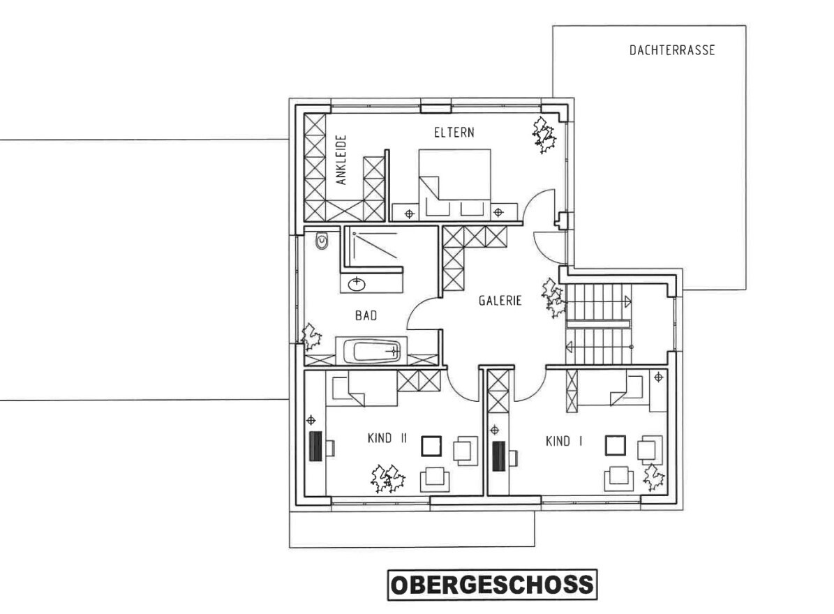

Upstairs, the toilet strikes me as being pushed quite far into the corner.
Are the children's rooms on the north side? Unfortunately, I can’t quite make sense of the plan. In that case, I would definitely add windows on the east or west side. I’m not a fan of only having north-facing windows. A walk-in closet behind the bedroom seems to be what you want.
Otherwise, it’s a nice design, but it’s no use if it’s too large for you.
