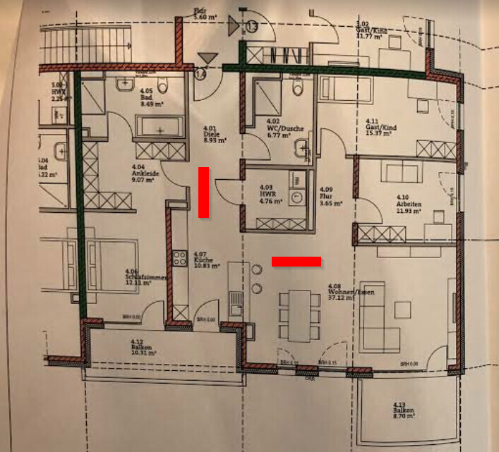

Hi,
How would you lay the parquet flooring in this apartment layout? Uniformly across the light direction in the living room, or uniformly along it? The parquet will be installed uniformly, meaning there are no plans to change the orientation in different rooms. It is also decided that the hallway and kitchen areas will have parquet, just to clarify that in advance.

24 May 2021 14:21
We applied it uniformly perpendicular to the direction of light in all rooms.
Tassimat
24 May 2021 14:25
I installed the flooring consistently parallel to the incoming light. This is more common practice, as it makes the joints less visible.
If you want to highlight the joints, install the flooring perpendicular to the main light source.
Hausbautraum20
24 May 2021 14:28
I would install it lengthwise to the direction of the light, as this makes the joints less visible and your room is narrower in that direction, giving it a visually elongated effect.

Hausbautraum20 schrieb:
I would lay it parallel to the light source, as the joints are less noticeable then and your room is narrower in that direction, making it appear visually elongated.
I want to emphasize a hallway about 10 m (33 feet) long and about 1.50 m (5 feet) wide—lengthwise?
