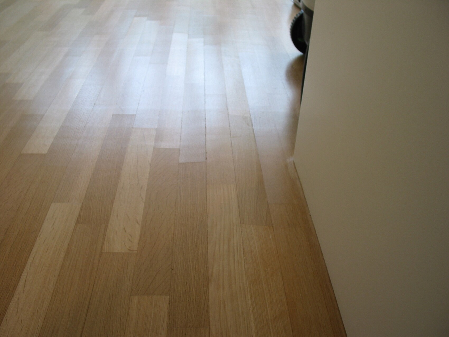

Floating (or installation on an underlay) multilayer parquet panels have the characteristic that inevitable deformation caused by moisture absorption from the air, which is somewhat restricted in a positive way by the adhesive on the underside in floating installations, can now occur unhindered.
To show you how parquet can look if certain installation rules are not followed, I have attached a photo from my own expert practice.

@Neige:
Scratch marks on parquet surfaces look different; however, the ways to "wear out" parquet by sanding are nearly limitless....
The attached photo is intended only to illustrate how side or grazing light along the long edges of the panels can appear very unfavorable as soon as the panel deforms even slightly.
Deformations themselves are not defects but—of course, within reasonable limits—should be considered typical characteristics of wood and wood-based materials!
