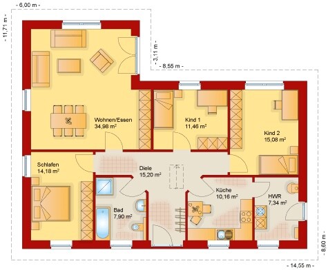

If you plan the following rooms on the ground floor:
20 m² (215 sq ft) living room
15 m² (161 sq ft) dining room
12 m² (129 sq ft) kitchen
16 m² (172 sq ft) child's room
16 m² (172 sq ft) bedroom
10 m² (108 sq ft) bathroom
10 m² (108 sq ft) hallway
2-3 m² (22-32 sq ft) guest toilet
2-3 m² (22-32 sq ft) wardrobe
and put the rest in the basement (technical room, storage, office, guest area), then 100 to 110 m² (1,076 to 1,184 sq ft) of living space should be sufficient. Maybe the child's room could be smaller if it won’t be used much longer, or the guest toilet could be omitted or moved to the basement.

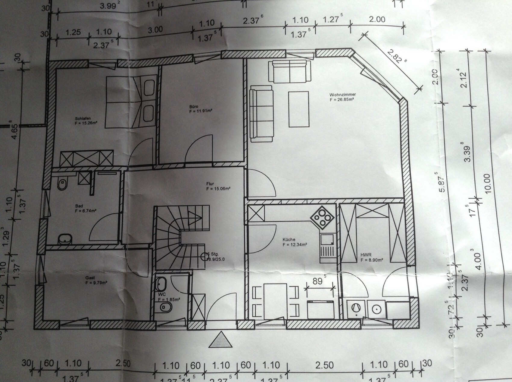

I don’t think the floor plan from Nordlys is bad, but I would imagine some rooms larger, and the staircase to the basement still needs to be considered.
If you need to convert the attic, then skip the basement and use the attic as a basement replacement.
On one hand, it seems you have to expand anyway; on the other hand, basement space is more expensive than living space above ground.
You can install technical equipment and appliances on one side at the top, and on the other side, have a bedroom with a shower bathroom—either for guests, as an office, a master bedroom, or a children's area.
