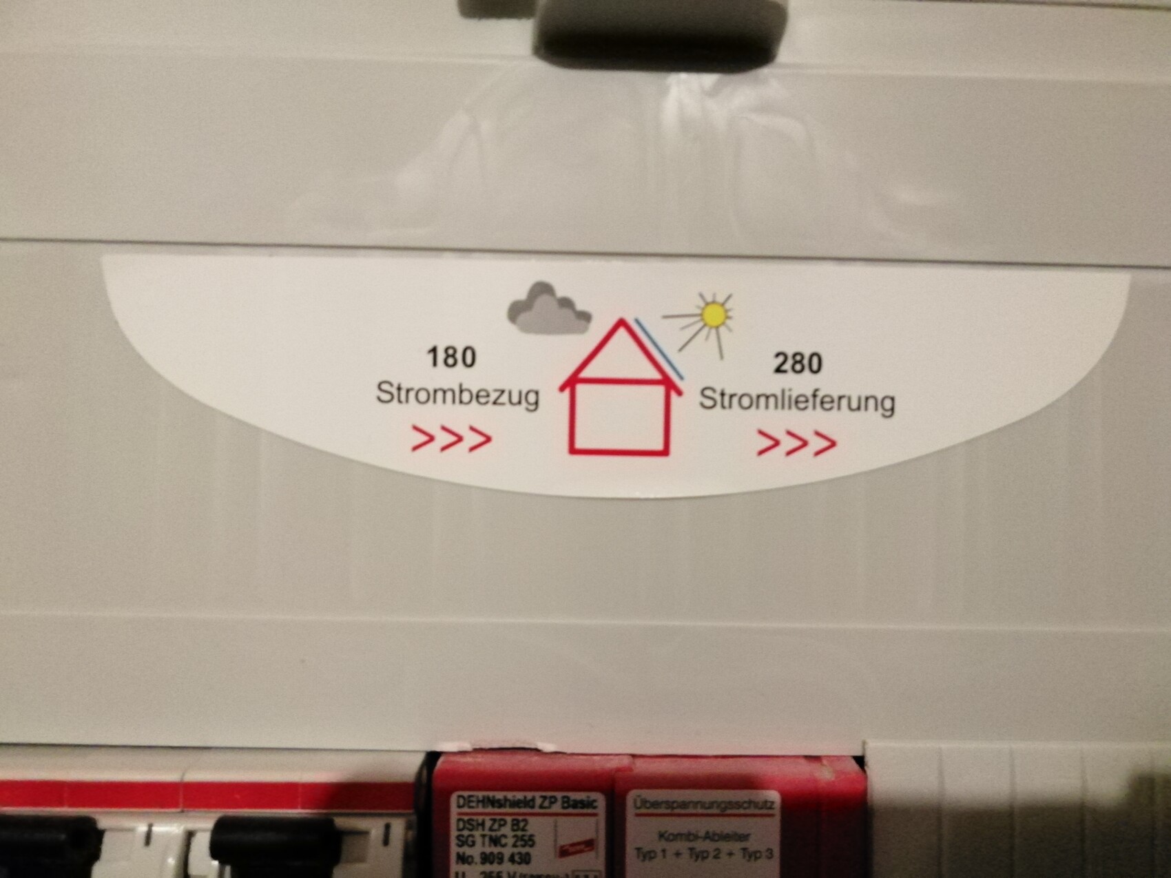

Actually, see the picture... the display keeps switching back and forth..
Red house between a cloud on the left and the sun on the right; power consumption 180, power feed-in 280.
KingJulien9 Jan 2022 11:35
The power feed cannot be correct, obviously. Why is there such a high reading on the meter?
The difference would result in a realistic value.
What does the information E21 on the meter mean?

Badener1970 schrieb:
I have a question on this topic, independent of the original post. We have been living in our new KFW55 house with 9.9 kWp photovoltaic system since the end of October. We have two meters as shown in the picture: the left one currently shows 1324/4691 kW, the right one 442/4912 kW. How should this be interpreted? The SMA Homemanager was installed at the end of December, but with it I can only read the photovoltaic output and the consumption without the heat pump.
1. The meter shows kWh (kilowatt-hours).
2. Why wasn’t the electrician asked during handover?
3. There seems to be an obvious wiring problem if the heat pump meter is also recording feed-in below 280 (kWh).
=> This should be reported to the general contractor and documentation or correction requested.
The forum, like you, can only speculate.

OWLer schrieb:
3. It seems that something obviously went wrong with the wiring if the heat pump meter is registering feed-in below 280
No, everything is correct; this is called meter cascade, also known as measurement concept 8.
The reading from October 21 does not indicate when the photovoltaic system and the meters were activated... given the high values, it is assumed that this happened already during the summer.

guckuck2
9 Jan 2022 13:19
Self-consumption is calculated as generation minus meter 2.8.0 at Z1 (feed-in point).
So, it works exactly like a system without a cascade.
