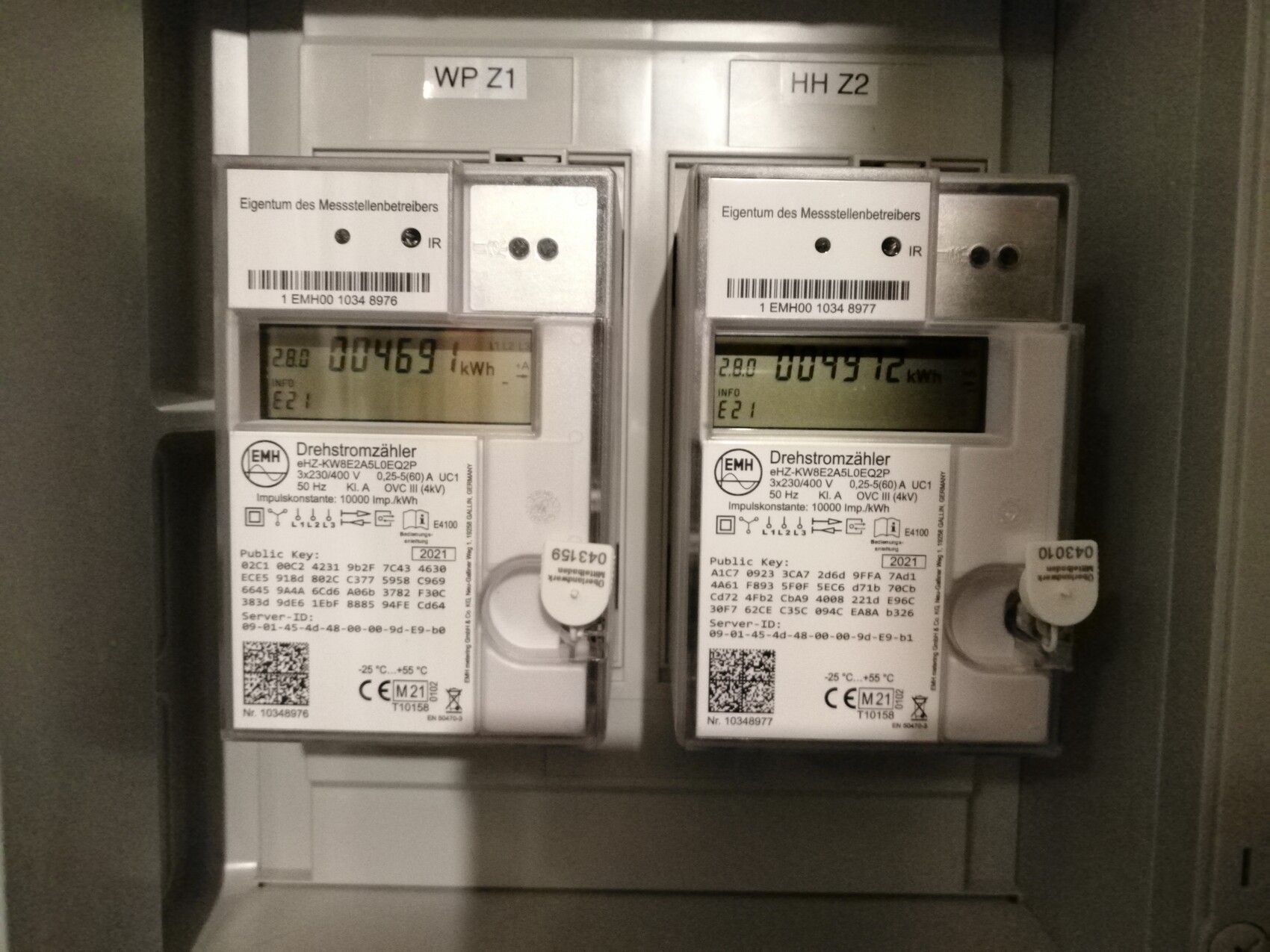

I have a question related to this topic, independent of the original post. We have been living in our new KFW55 building with a 9.9 kWp photovoltaic system since the end of October. We have two meters, see the picture; the left one currently shows 1324/4691 kWh, the right one 442/4912 kWh. How should this be interpreted? The SMA Homemanager was installed at the end of December, but with it, I can only read the photovoltaic output and the consumption excluding the heat pump.
Two digital electricity meters side by side in a distribution board, displays showing kWh values.
U
User0815
8 Jan 2022 17:32
On the left is the heat pump, on the right Hamburg: I would assume you have a heat pump tariff, with the left meter showing the heat pump’s consumption and the right one showing the household electricity usage. Was that your question?
Badener1970
8 Jan 2022 17:43
User0815 schrieb:
On the left is the heat pump, on the right Hamburg: I would assume you have a heat pump tariff, and the left meter shows the consumption of the heat pump while the right one shows the household electricity. Was that your question?
That’s clear, we have two tariffs, but I don’t understand the different feed-in values... left 4691, right 4912
U
User0815
8 Jan 2022 17:53
Aren't these consumption figures rather than feed-in values?
