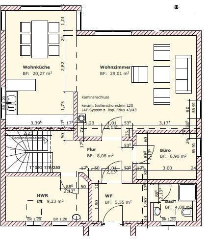

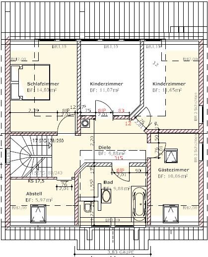

Here are the floor plans I promised.

- We really like the open living/dining area, which suits us well. The path through the living room to the kitchen works fine for us.
- The chimney was moved slightly.
- We changed the staircase as suggested here. That tip was invaluable and it looks fantastic! Now you enter the hallway upstairs straight on. The hallway upstairs is almost a bit large, but looks great.
- A small storage room will be built under the stairs.
- The upstairs storage closet is now a bit larger and more usable.
- The children’s rooms are small, yes, but they face south, have the best view, no sloped ceilings, and will be sufficient.

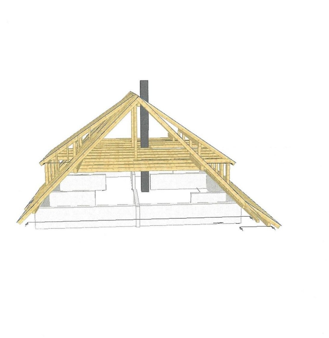

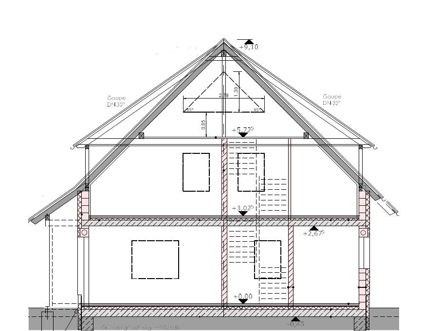

In the main roof area (45° pitch), a person 1.80m (5 ft 11 in) tall can stand upright over a width of 2.5m (8 ft 2 in). Where the dormers are, standing space is over 4m (13 ft) wide.

Sparfuchs7724 Feb 2020 17:58The stairs are aligned from the ground floor up to the attic. Yes, a WC would be an option (I had considered it before), but it’s not really feasible on the north side (bottom of the floor plan). On the top side of the plan, the drainage would have to go through the bedrooms, which is also very unattractive.
I would say: 3m (10 feet) to the stairs, and 3m (10 feet) from the stairs to the upstairs WC is, in my opinion, acceptable. But thanks for your input!

Sparfuchs7725 Feb 2020 16:31I do have a question related to the floor plan, since we will start the electrical work soon. Outlets and network/TV connections are already planned. I’m still considering the lighting though. Especially the living/dining area is giving me some trouble.
Do you have any ideas? I was thinking of one ceiling light in the center of the living room, one on the wall near the balcony doors (opposite the chimney), and one above the dining table. But somehow, I’m not completely satisfied with this plan yet.
