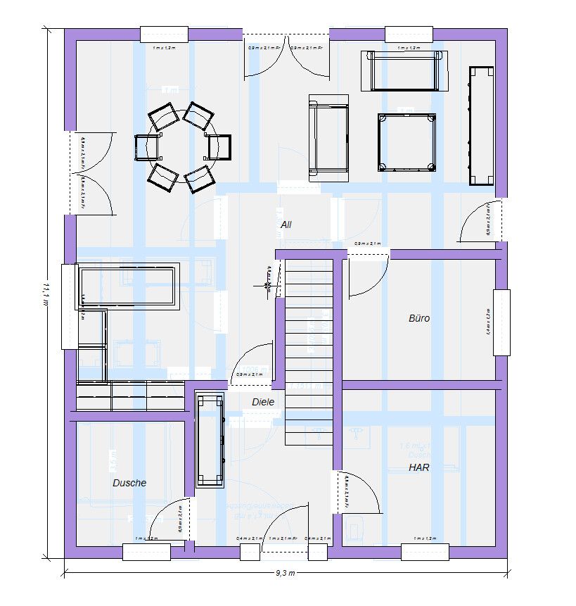

Sparfuchs_:P schrieb:
[ATTACH alt="Variante1.JPG"]36850[/ATTACH]
- All rooms have been rearranged except for the bathroom and utility room
- Staircase rotated – it no longer extends into the utility room but into the office
This is how I imagine it and could live with it
[ATTACH alt="Variante1büro.JPG"]36851[/ATTACH]
- The living room could be separated if needed
- The kitchen is the first room, so the living room is no longer in a through-way

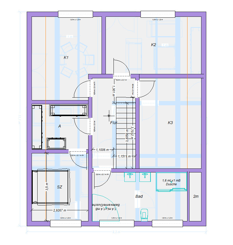

Upper floor
[ATTACH alt="efh-150qm-für-5-koepfe-336811-1.JPG"]36852[/ATTACH]

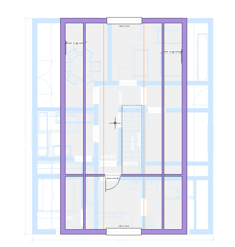

Sparfuchs_ schrieb:
As far as I understand, a wall with a higher knee wall must bear more load because the leverage from the roof increases. That is basically correct – but it does not mean that the house will automatically be more expensive because of a higher knee wall. As mentioned: overall ... more knee wall, less roof pitch / no bay window, but spread over the building depth – these elements are interconnected and tend to be "rebalanced" rather than making the total cost higher or lower.
We haven’t considered the Neo yet. With dimensions of 11.1m x 9.3m (36.4 ft x 30.5 ft), we would roughly end up with the same base floor area. Knee wall at 1.30m (4 ft 3 in), ceiling heights: ground floor 2.60m (8 ft 6 in), upper floor 2.50m (8 ft 2 in). For K3, we could reconsider a shed roof or something similar. For cost reasons, initially only double casement windows. Stairs again offset above each other (no landing) – please put on your glasses!
