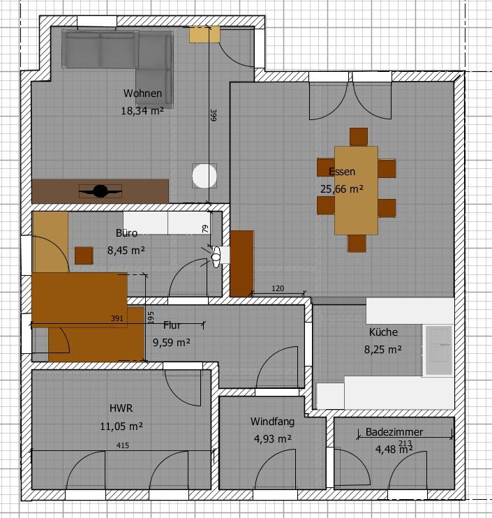

We are currently (once again) working on the floor plan. We started by optimizing our layout. I still need to redraw the other suggestions calmly. My wife doesn’t have to watch over me for that. But @Niloa was right. The kitchen didn’t work.
After playing around with our floor plan, this is what we came up with. The idea was to swap the office and the kitchen.
Floor plan of a house: living, dining, kitchen, hallway, utility room, entrance area, office, bathroom.
- swapped all rooms except the bathroom and utility room

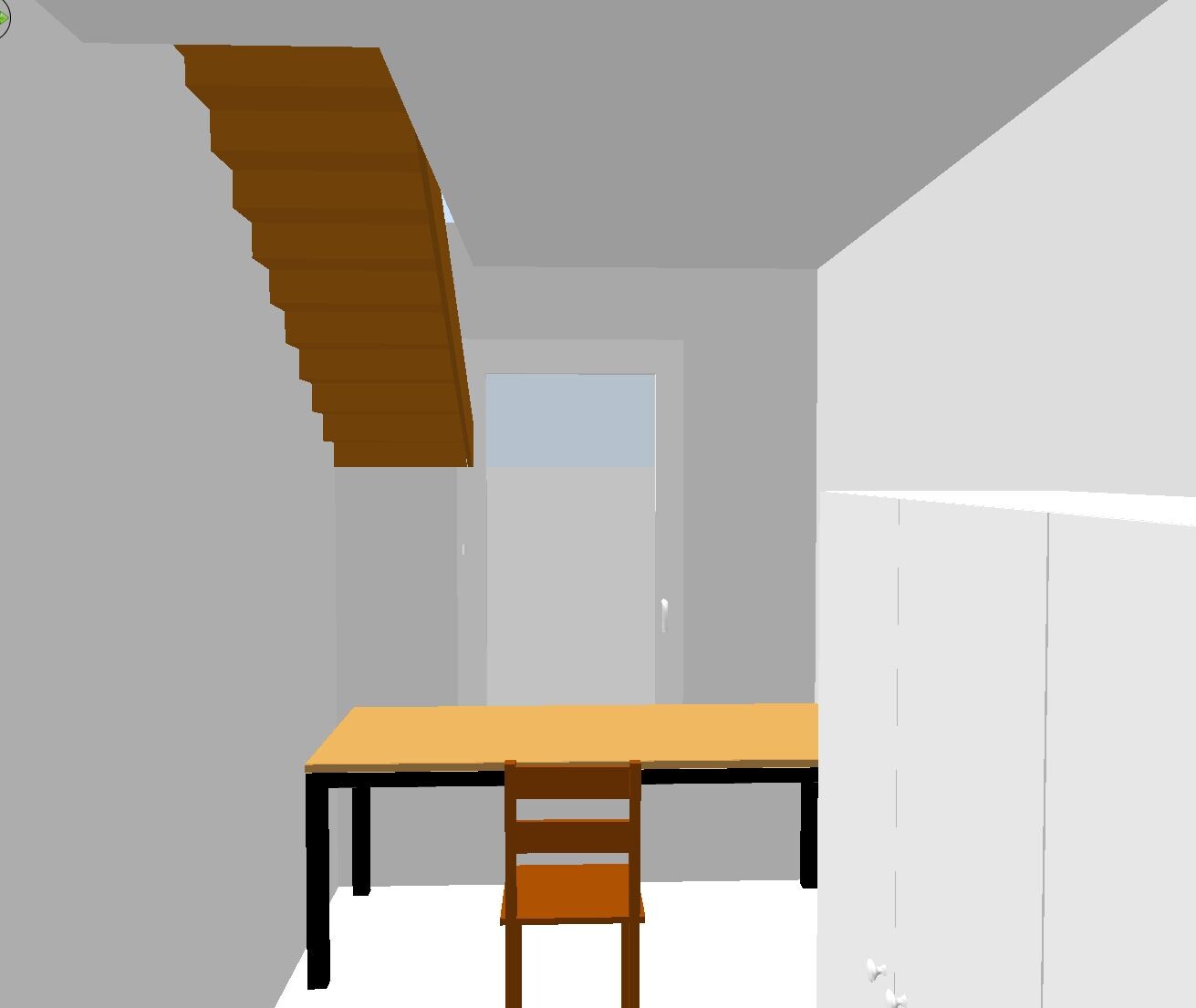

- rotated the stairs – they no longer intrude into the utility room but now lead into the office
This is how I imagine it and could live with it.
Gray interior with wooden table and chair, cabinets on the right, stairs and door in the background on the left
- The living room could be separated if needed
- Kitchen is now the first room, so the living room is no longer just a passageway

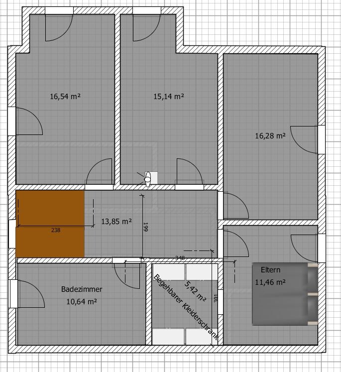

Upper floor
Floor plan of an apartment with multiple rooms, bathroom, master bedroom and walk-in closet.
Cozy or cold (or a disaster)?
