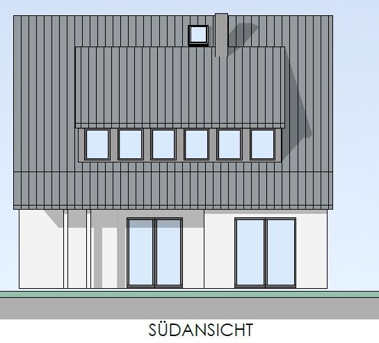

Sparfuchs7723 Jul 2019 11:01I would like to present three options for discussion. I’m not focusing on the floor plan for now, as most of that has already been addressed and we will review it this evening. This is more about the dormer / bay window / knee wall. Possibly also which solution would be the most cost-effective.
1. The house could be built as originally planned. Covered bay window dining area and the large dormer. Knee wall 75cm (30 inches) in the plan, 1m (40 inches) if compromises are made on the dormer – we will clarify this with the architect.

The floor plan (with possible modifications) could be implemented with any of these options. My main concern is the implementation with dormer and lower knee wall or a solid bay window and higher knee wall.
What are your thoughts? Or are these questions too fundamental for this kind of thread?

Sparfuchs_ schrieb:
Or are these too basic questions for a thread like this?Well, this really gets to the heart of the matter. Anyone just skimming the topic probably wouldn’t understand what you mean.I’m afraid these are also questions largely influenced by personal taste and budget. That’s why everyone will have a different opinion.
My personal view: I think it’s absolutely wrong to justify poor construction on the upper floor by adding or offsetting a gable.
I assume that dormers will be cheaper for you. It probably comes down to a matter of money. If you install many dormers, the low knee wall becomes hardly noticeable. However, the areas under the dormers often cannot be used as floor space anymore. The room then feels bigger and brighter, but you’re not sure where to place the bed. Of course, that depends on the situation. That’s why you should plan the furniture layout and see if it works.
At the peak, the dormer also widens the room slightly—which I hadn’t considered. You’re right about that. As I said, having 2-meter (6.5-foot) height lines would be very important to get a better impression.
The exterior appearance shouldn’t be forgotten either. Personally, I prefer gables—I only find batten (shed) dormers attractive among dormers. In that case, I’d accept loss of knee wall space right away…
Sparfuchs7723 Jul 2019 11:42kaho674 schrieb:
Anyone just skimming through probably won’t understand what you mean. Well, they probably won’t post anything either ^^ I think those who have been involved from the start will understand, right?
kaho674 schrieb:
My personal opinion: I think it’s absolutely wrong to try to justify the mess on the upper floor by adding or shifting a dormer. As I said, the floor plan is on the agenda for tonight if we make it. For example, if we choose option 3, the stairs could be moved easily to “untangle” the upper floor.
kaho674 schrieb:
I guess the dormers will be cheaper for you. It will definitely come down to money. If you add that many, the low knee wall height hardly matters anymore. However, the areas under the dormers often can’t be used for furniture. The room feels larger and brighter, but you don’t really know where to put the bed. Of course, it depends. That’s why you should plan in the furniture and see if it works. Yes, in the end it will be a matter of money. A bat dormer would definitely get very expensive.
kaho674 schrieb:
At the peak, the dormer also widens the room a bit – I hadn’t considered that. You’re right. As I said, having the 2m (6 ft 7 in) height lines would be very important to get an impression of that. We’ll take it again to the architect who can probably show us that clearly.
