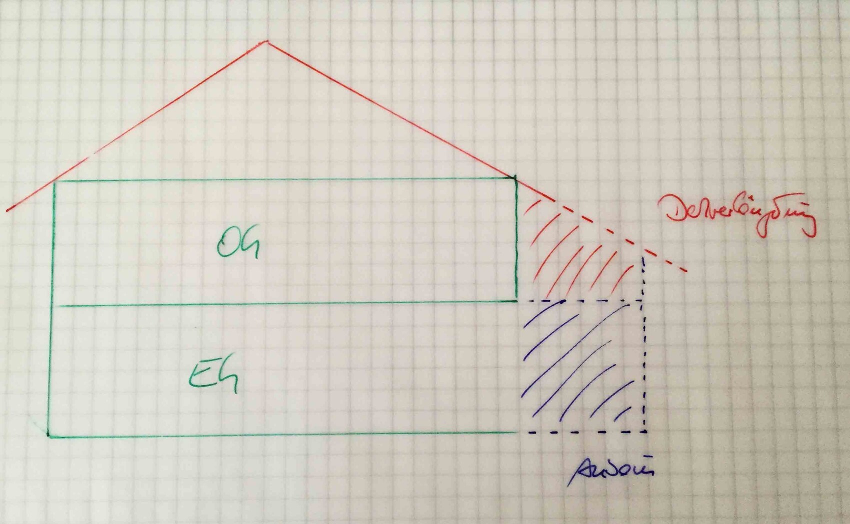

So, there is an existing extension on the ground floor. We would basically replicate this above. Nothing would need to be built up with masonry; rather, the roof would be placed or extended in the same way as on the rest of the house.

Schnuck schrieb:Something like what is outlined in the attached sketch? Apart from the fact that I would not build the extension entirely out of timber, this option doesn’t really gain you much usable space. Have you even checked with the building authority whether adding another floor to the existing structure is likely to be approved?

Schnuck schrieb:More details are definitely needed for that; a section drawing of the existing building wouldn’t hurt either. Depending on the area you’re considering and the adjustments needed for the existing structure, a carpenter specializing in timber construction could quote as high as a mason.
