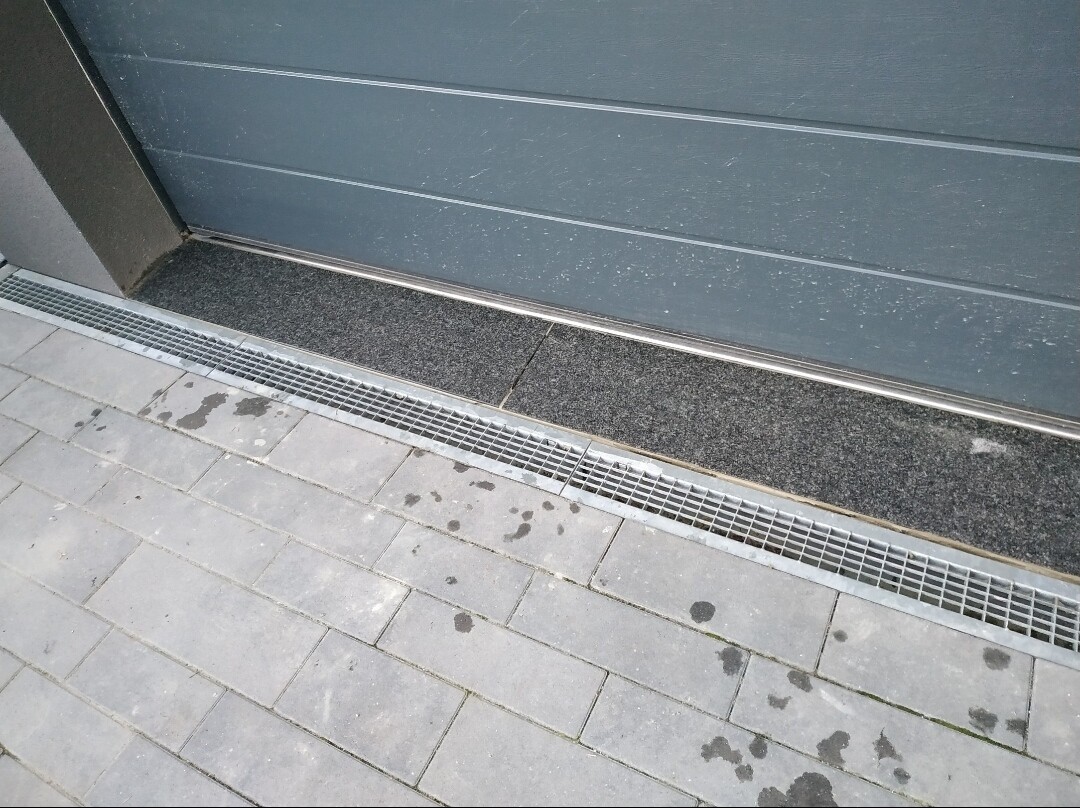

tomtom7915 Mar 2021 17:00
We installed 4cm (1.6 inch) thick granite directly on adhesive, so nothing will break anymore and it looks good.
The joints are also sealed with adhesive.

tomtom79 schrieb:
We installed granite slabs 4cm (1.5 inches) thick, directly onto adhesive; nothing breaks anymore and it looks good.
[ATTACH alt="IMG_20210315_165838.jpg"]58804[/ATTACH]
Great idea. I like it. For me, it was tight in some areas. The Hilti and angle grinder helped to remove the concrete.
What happened to your car? Are those oil stains?
tomtom7915 Mar 2021 18:50
This is water. I also had to repair the edges beforehand because the concrete had come loose in the corners, so I ground and chiseled it. The rest was dust, which fortunately was cleaned away with the pressure washer.
