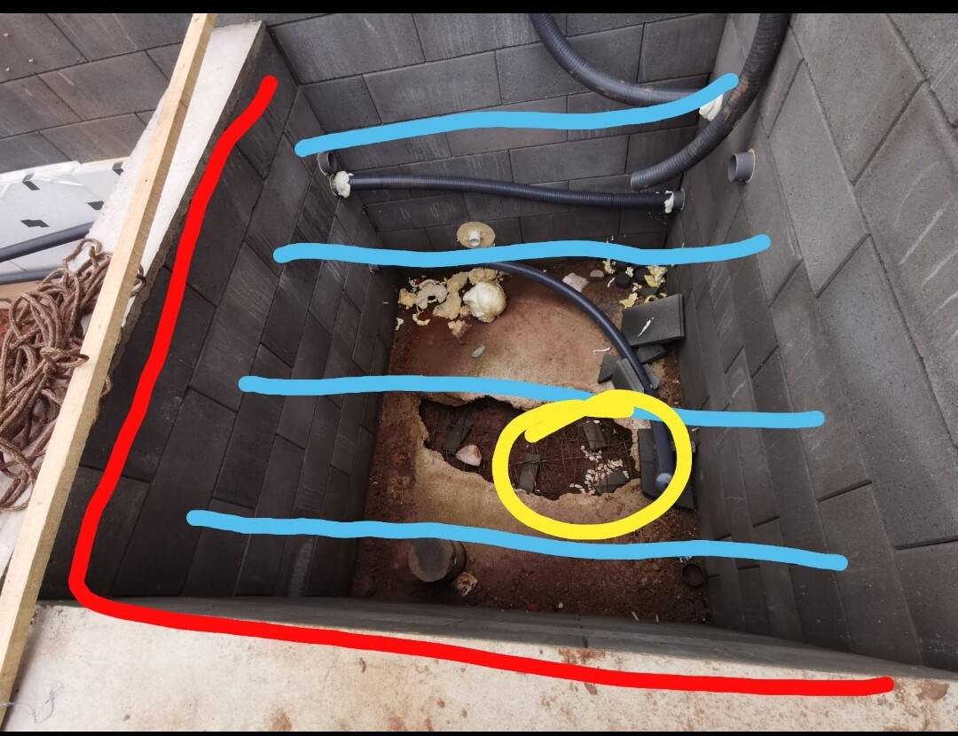

I have a shaft (see attached picture) where I need to cast some kind of cover.
Explanation:
The red row of bricks will be removed.
The blue area will be the cover.
The yellow area is an access opening into the shaft.
It will be filled completely with water later on.
Do I need to install steel beams and then cast concrete with a thickness of about 20cm (8 inches)? I was thinking of drilling holes by core drilling and then sliding the steel beams in and embedding them into the wall with concrete.
Thanks for your feedback.

Without an existing plan, it is difficult to make any recommendations here. Are these basement walls above and to the right? Are they made of concrete formwork blocks?
Is that a rainwater collection shaft?
The concrete works fine without steel beams; just add reinforcing steel bars and it will be fine.
Of course, shaft covers are available as factory-made parts. As a DIY project, it might not be suitable due to the lack of lifting equipment.

Sorry, I thought I wouldn't write a novel. It is a collection basin for water that will be properly sealed later.
All four walls are made of 25cm (10 inches) concrete formwork blocks with 14mm (0.55 inches) reinforcement.
Now a cover needs to be put on or inserted. Later, the whole thing will be covered with soil and planted, with a cover serving as an access point for cleaning and maintenance.
