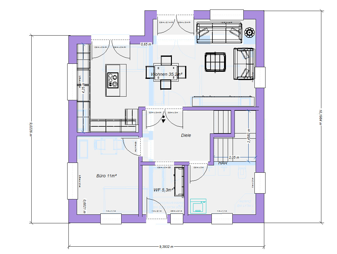

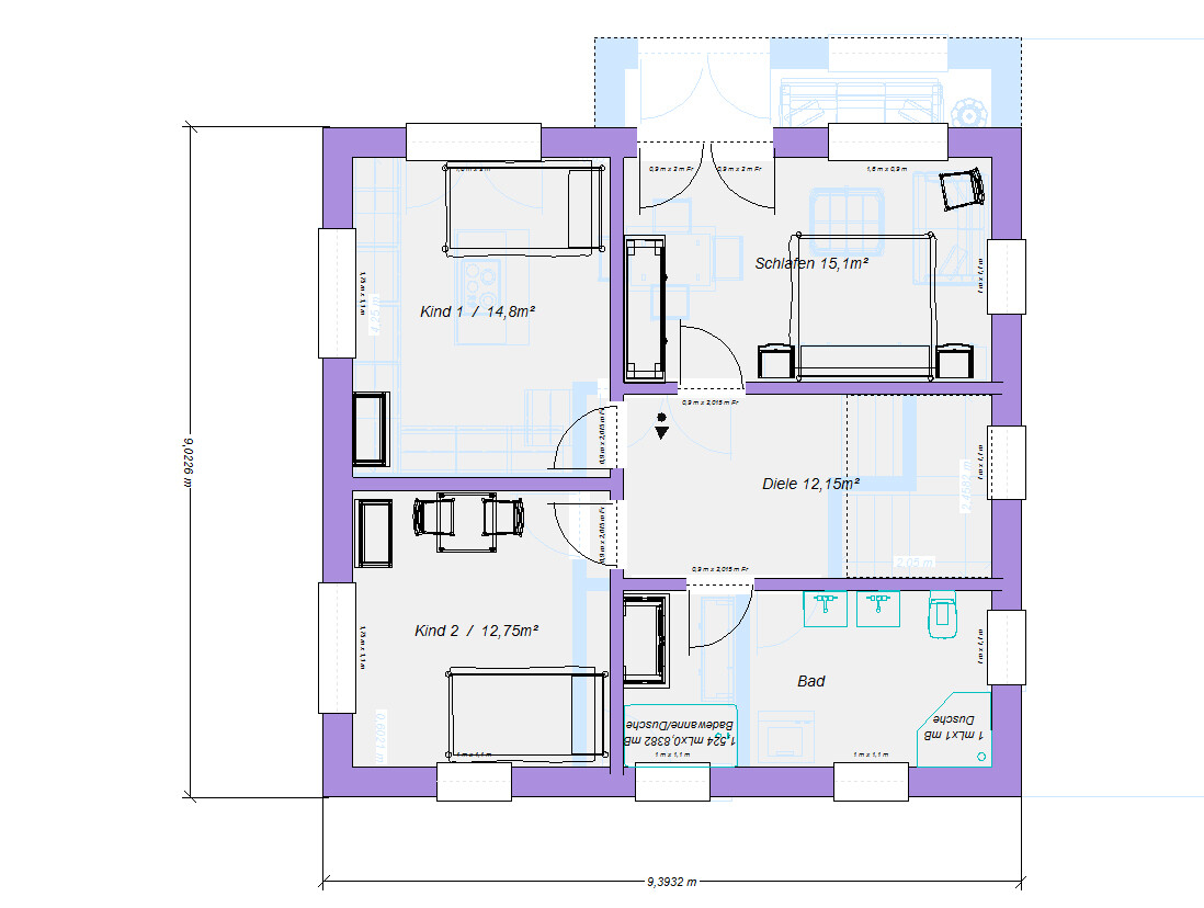

I find the right side (bathroom, living room, bedroom, staircase) very cramped.
Bathroom
no room for a cabinet
only a small washbasin possible
narrow passage
Bedroom
access to the rear bed is too tight
Living room
sofa in front of the patio door
dining table in front of the corner doesn’t look good to me
Staircase
does the staircase even fit there?
There is no guest toilet on the ground floor.
Overall, the dimensions are missing.
Bathroom
narrow passage
Bedroom
Living room
Staircase
Hmm, well, I consider rearranging furniture just a pointless hassle. Everything fits fine. See?
But I totally forgot about the guest toilet. Haha – there isn’t one. Just hold it at home!
Upstairs, you could move the laundry room and add it to the bathroom. Downstairs, one half of the staircase could be for the utility room.
But it’s just playing around, without a guest toilet, we’d have to start over... blah blah
