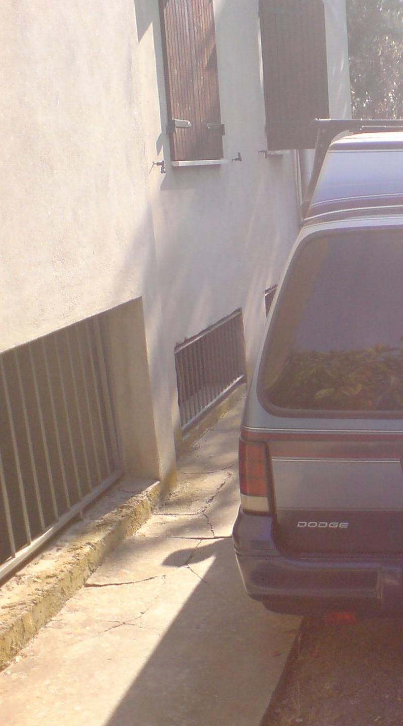

I have a more or less open basement that I now want to close off. There are large basement windows, but they are only covered with bars, so there is no actual window! This means that dust, rain, animals, etc. all get into the basement.

I am a tenant, but I am in Italy, where things are somewhat different. I didn't actually rent the basement, so I can't expect the landlord to waterproof it.
Attached are two pictures of the basement windows.

Hi,
I had a similar problem with my house and ended up using louvered grilles as a solution. They block dust and prevent animals from getting in, but it doesn’t feel damp or musty because air can still circulate. The slats also allow enough light to come through.
