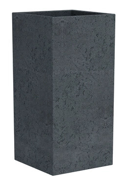

I might even place taller planters (very stylish, for example made of Corten steel) on the ground against the wall and run the cladding along them. Similarly, you could stack black planter boxes or concrete blocks and plant them… or place a fire bowl on top of each. There are no limits to the romantic possibilities.
Rectangular, dark concrete planter in the garden.
