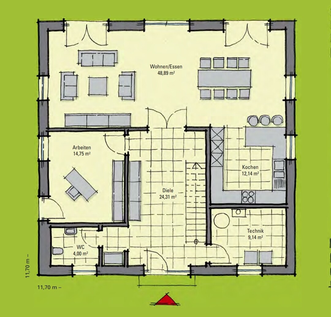

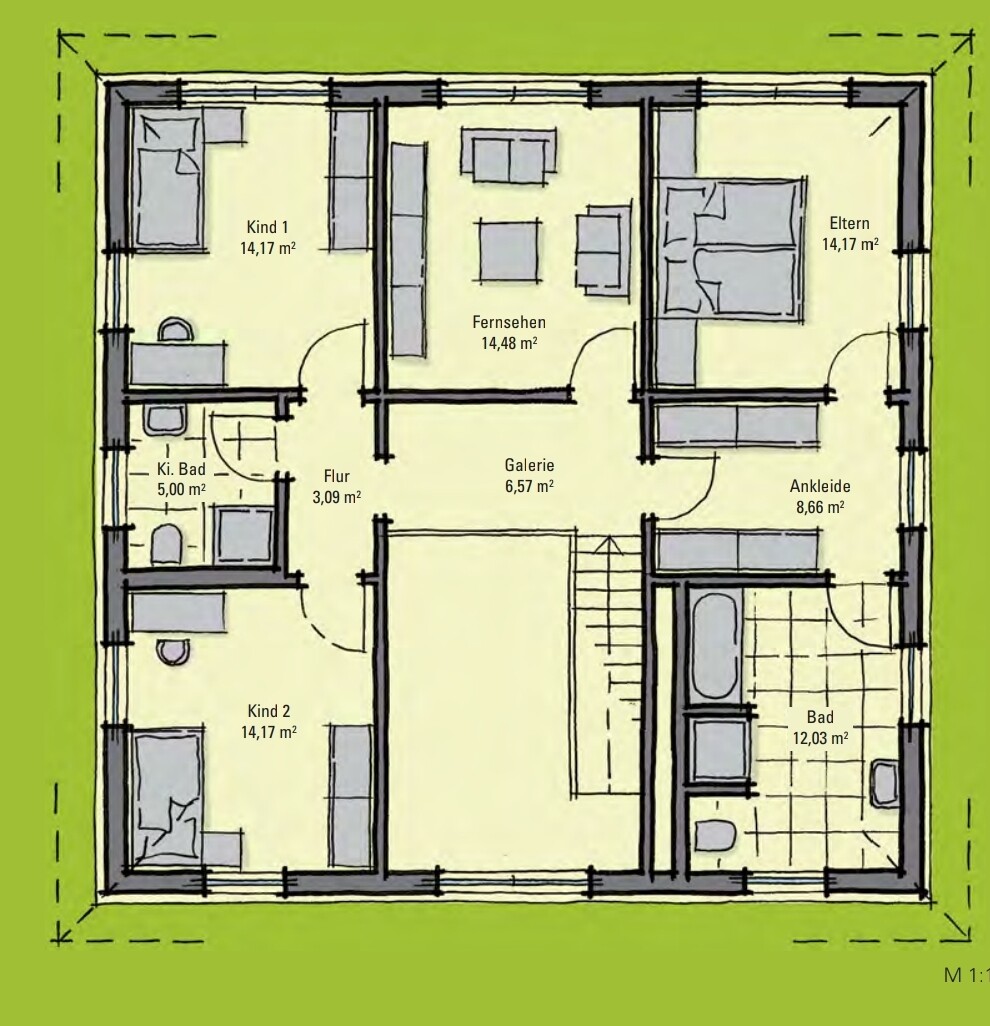

saralina872 May 2020 23:51I think the basic layout is not wrong in principle, but the kitchen as it is won’t work. Depending on whether an island is important to you, it will need to be designed differently.
What I notice on the upper floor is that a lot of space is wasted on the hallway, so I would reconsider the layout there. For five people, the bathroom might also be a bit small, although that is quite subjective.
With dimensions like these or similar, I would really like something like this (just as inspiration):
It doesn’t make sense to make the hallway on the upper floor so large; it can be reduced in size to allow for bigger rooms instead. Without artificial lighting, the hallway upstairs is completely dark. The bathroom would be definitely too small for me with five people.

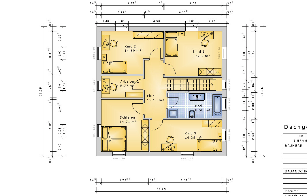

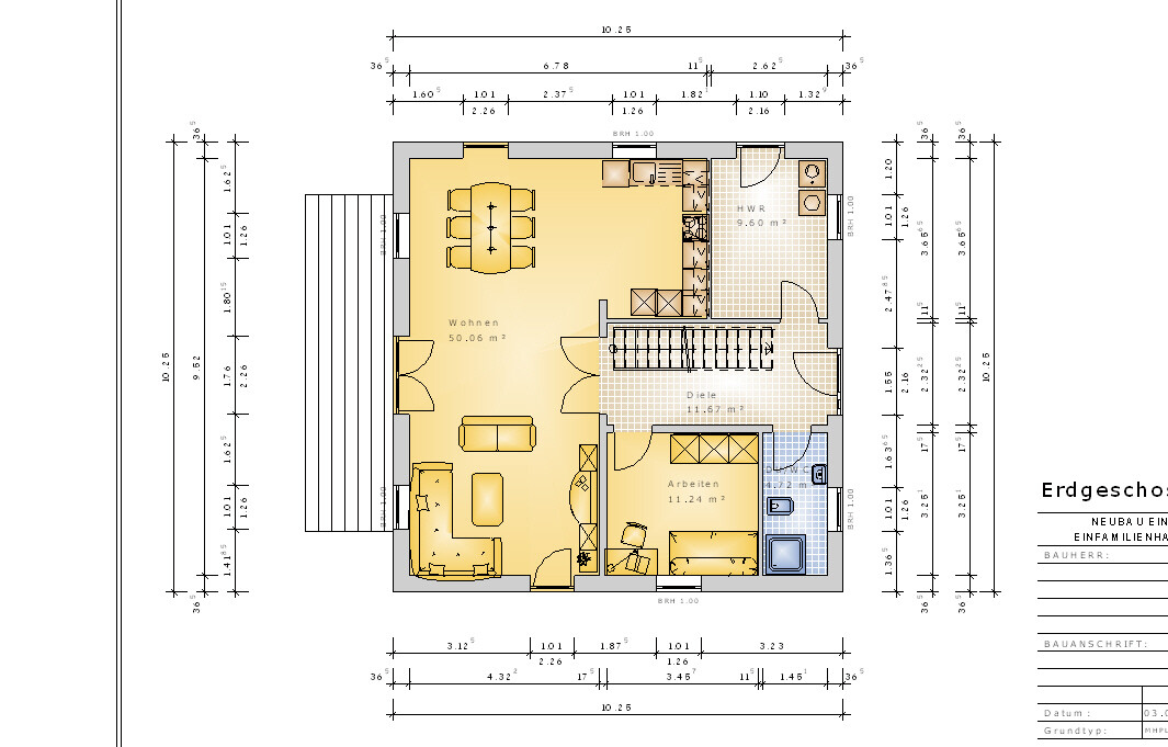

Thank you for all your suggestions. My husband has been working on the plans a bit more. Currently, our bathroom is under 7sqm (75 sq ft) — it would of course be nicer if it were larger, but for us, the children’s bedrooms are more important.
Do you have any further ideas regarding this rough layout?
We want the children (who are still quite young) to have their own "children’s floor" upstairs when they get older. That’s also why the shower is definitely planned for the downstairs guest toilet, so the (rather small) bathroom upstairs will effectively be for the children only.
