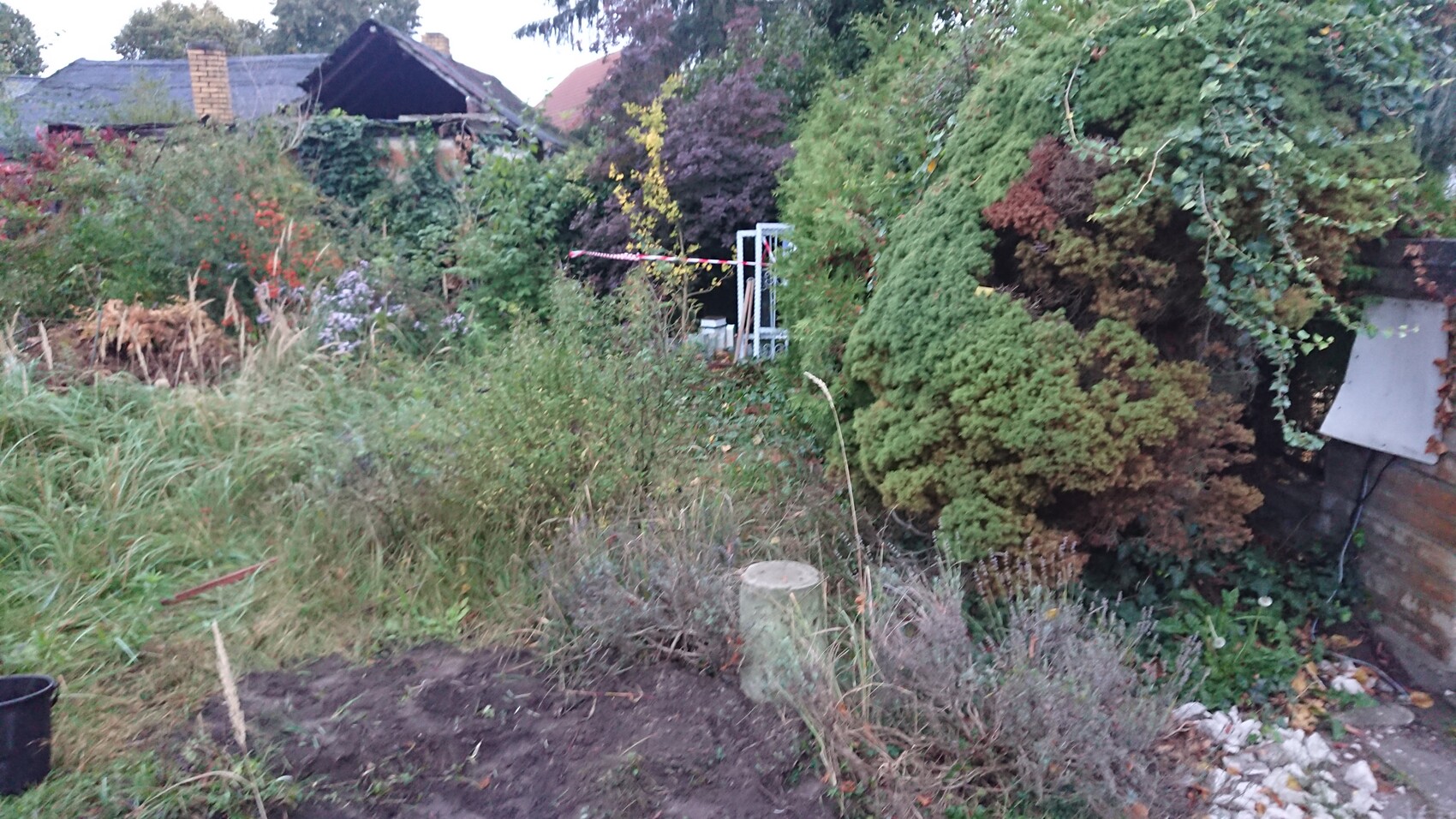

Hello dear forum members,
the demolition has now been carried out at my construction site (https://www.hausbau-forum.de/threads/lage-stadtvilla-oder-efh-auf-500-m2-rechteck.33505/post-442751).
In addition, a temporary access road for construction vehicles has been established, which unfortunately ends directly at an (empty) (PE) cistern (https://www.hausbau-forum.de/threads/lage-stadtvilla-oder-efh-auf-500-m2-rechteck.33505/post-442845).
My neighbor and co-builder (but with his own house located at the rear of the overall property) is now concerned that the cistern could be damaged if a 40-ton truck drives all the way down the access road. The load is said to be distributed at a 45° angle downward, according to our site manager’s explanation. This would mean that part of the cistern would definitely be subjected to some of the load. There is maybe about 1 meter (3 feet) of soil between the access road and the cistern. The cistern measures approximately 2 x 1.5 x 1 meter (6.6 x 4.9 x 3.3 feet) and is installed vertically, with its longest side buried underground.
Is his concern justified? Would it be enough, for example, to simply fill the cistern? Or would it be better to dig it up and relocate it? Here, I am worried that the access road at the back might then become unstable, even if we refill the hole. We probably won’t be able to compact it properly (the neighbor wants everything done with excavation and loading, EL).
Does anyone here have experience in civil or geotechnical engineering, or could even calculate this? What data would be needed for that?
