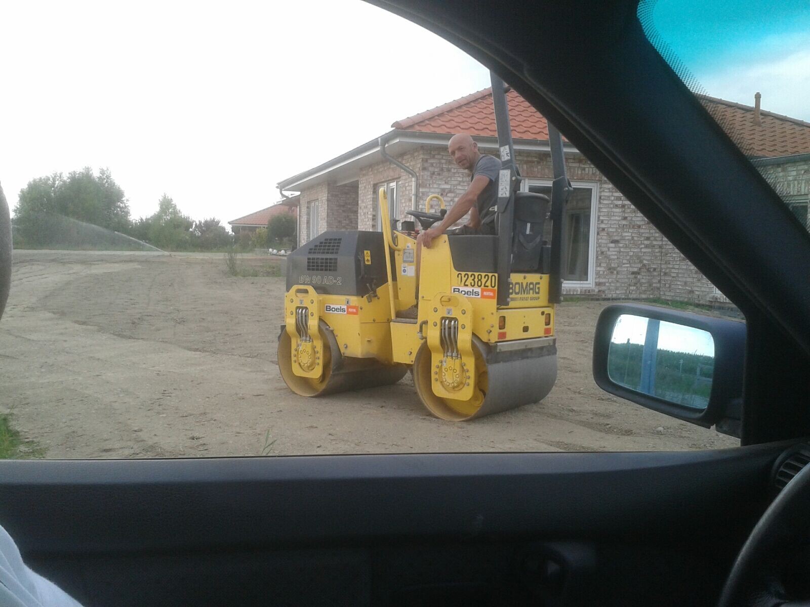

I had a farmer/contractor come with a rotary tiller attached to a tractor for about 1400 m² (15,070 sq ft). They tilled in different directions for just under an hour, and the area was almost level and well loosened. I did some additional finishing work with a rake and then seeded the lawn.
This was done at the same time as a neighbor’s area, and then both were rolled.
