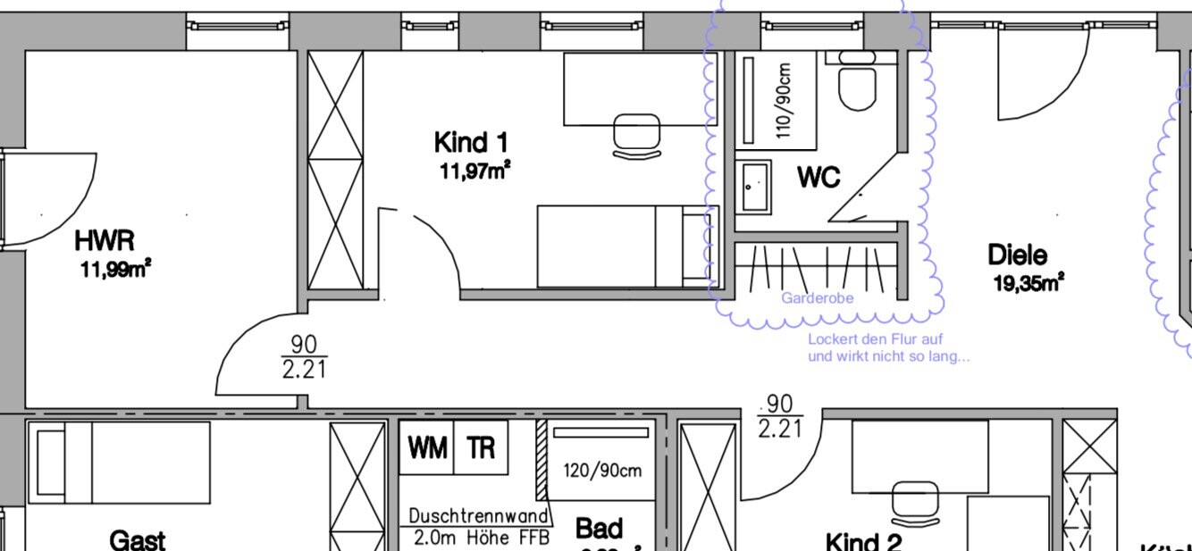

blaupuma1 May 2018 14:41
That could be another option.
(See image)
But somehow it doesn’t make much sense.
The hallway would feel a bit shorter.
The bathroom would be smaller (already very small anyway) and a cloakroom
Floor plan of a house with hallway, entrance area, WC, cloakroom, utility room, bathroom, guest room, child 1, child 2.
that nobody wants [emoji57]
And the bathroom door would be awkwardly positioned.

Alex85
1 May 2018 14:55
(See picture)
But it feels a bit pointless.
The hallway would feel somewhat shorter.
The bathroom smaller (already very small anyway) and a cloakroom
And the bathroom door awkwardly positioned.
Now mirror the children's room so that the door is closer to the living area/entrance. The utility room door can be moved 1m (3.3 ft) into the hallway.
