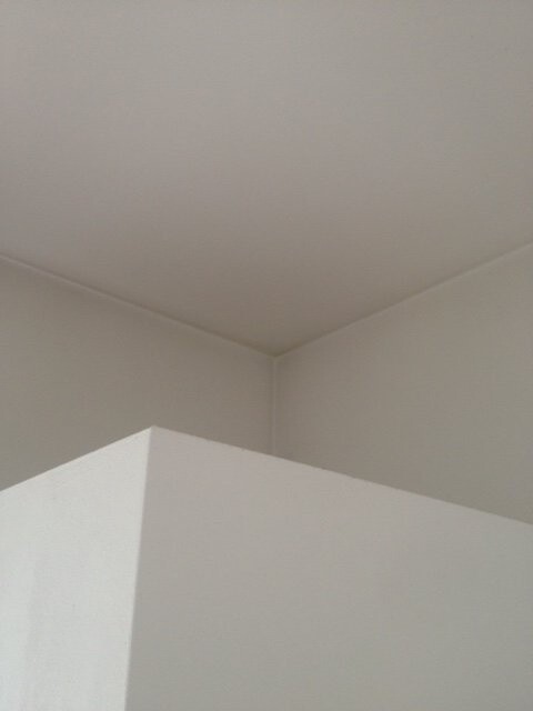

After 1.5 years, we have noticed yellowish/grey soot stains forming on the walls and corners near the chimney.
When we moved in, we did not paint with a white paint that includes a nicotine blocker. We now need to address this. Basically, the heat outlet/seating area is on the chimney. Is there possibly a solution, such as a soot filter or something similar?

Do you have any pictures of the wall?
OlliI will do that and upload them...
HilfeHilfe15 Mar 2016 20:30B
Bauexperte16 Mar 2016 10:27The substances involved in the formation of black deposits come from various products brought into living spaces. These products were usually introduced by different people (residents, building managers, contractors). Generally, it cannot be assumed that these individuals acted negligently, as they are often unaware that the products may contribute to the development of black deposits. On the manufacturers' side, there are still few suppliers who label their products for problematic substances—such as plasticizers. Since not every product containing plasticizers is likely to promote the formation of black deposits, most manufacturers see no need to disclose the content of their products, for example, the plasticizer content.

Based on current knowledge, black dust deposits do not pose an immediate health risk. The concentration of problematic substances—such as semivolatile organic compounds like plasticizers—is only slightly higher in affected homes compared to unaffected ones. These concentrations remain significantly below the threshold of any potential acute health hazard known to date. Nevertheless, for precautionary reasons—and not to mention the "aesthetic" problem of an unsightly living environment—it is advisable to identify the causes and remove the deposits. However, if the deposits contain elevated levels of polycyclic aromatic hydrocarbons (PAHs) or soot (both produced by combustion processes), a health risk may exist.
Damage removal
Before starting to remove the deposits by cleaning or attempting to eliminate them through renovation, it is important to identify the causes of the contamination. It is usually not necessary to eliminate every contributing factor in each case. Often, addressing individual factors is sufficient. For example, when renovating, choosing a paint that is solvent- and plasticizer-free can help. In some cases, adjusting heating habits may also be beneficial.
Repairing structural defects (thermal bridges) helps prevent the deposits from forming preferentially in those areas. Also, reducing the use of candles and oil lamps can alleviate the problem. Removing the deposits often requires intensive wet cleaning using detergents, synthetic cleaners, or similar products. Simply painting over the greasy deposits usually does not work. During cleaning, affected wallpaper, for example, may be so damaged that it has to be completely removed. In some cases, flooring must be removed or more significant structural measures (reducing thermal bridges) undertaken. However, such extensive actions should only be considered if the "simpler" renovation steps (using solvent- and plasticizer-free paints, thorough ventilation after renovation, avoiding soot-producing candles, etc.) have not been successful. To clarify individual cases, site inspections by experts and questionnaire evaluations are carried out, along with chemical analyses in the affected homes. Such analyses are only meaningful if, after site inspection, there is suspicion of a "fogging" phenomenon and the deposits have not been present for a long time. An analysis is also recommended if it is unclear whether the deposits are black dust or soot from combustion processes (or both).
