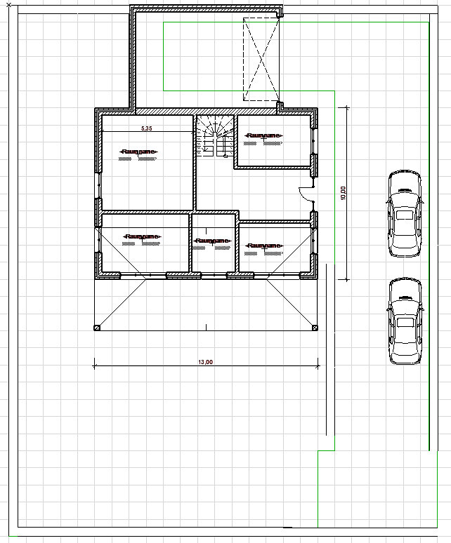

partyarti3 Apr 2016 20:36Fenix2k schrieb:
I’m curious about how the driveway to the garage will look. The street connection is shown at the bottom right in the picture. Your garage is positioned at the top left. Are you planning to pave half of the property?Since you’re so interested, here is a first draft attached.
If I were to build the garage on the south side next to the driveway, unfortunately half of the garden (which faces south) would be blocked. If you have any ideas on what would be best to do with a property like this, feel free to share.
PS: The plot is approximately 31m x 25m (102ft x 82ft).
You will curse the garage for 50 years or stop using it by the third day at the latest. Or are you not aware that you’ll have to back out around the corner every morning, or in the evening reverse in and then turn around the corner into the garage? Or turn around in 18 moves every time in the northeast corner!?
Place the garage on the eastern boundary; anything else is madness unless you buy an additional 5–10 meters (16–33 feet) of land to the east.
