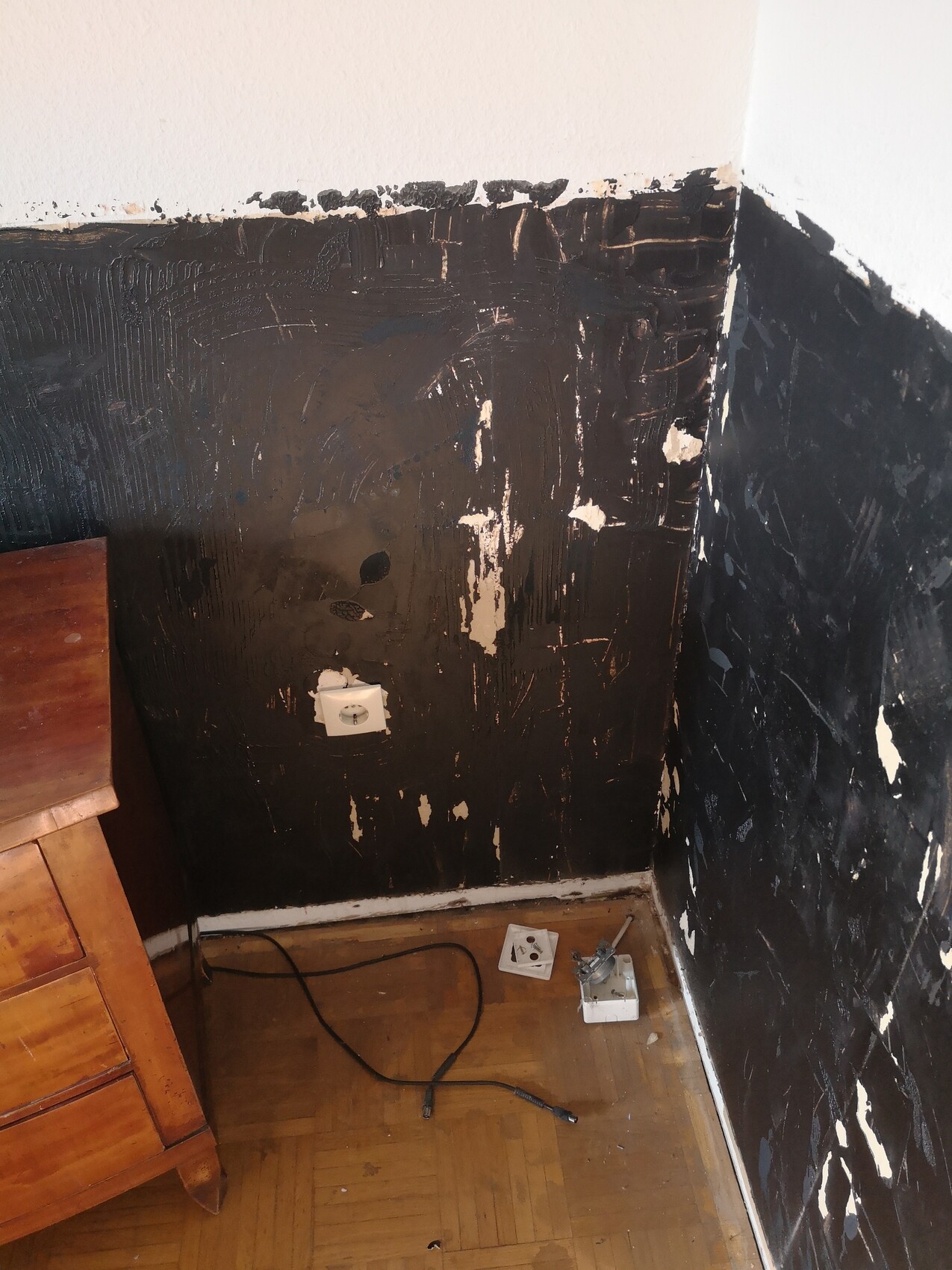

JulBo90Hello, my husband and I recently bought an end-of-terrace house built in 1971.
In one room, there was wooden paneling covering the wall up to about halfway. We have now removed it and discovered this black adhesive-like substance.
What is it, and could it possibly contain asbestos?
The interior masonry is not plastered but covered with drywall. The black substance is on the drywall.
Thank you very much

nordanney25 Jul 2024 08:45JulBo90 schrieb:
Could it possibly contain asbestos?Only a test can tell you that. It cannot be ruled out by remote assessment, especially given the age.JulBo90 schrieb:

Thank you very much What is the best way to remove this adhesive? Should I sand it off? Soften it somehow or remove the lower part of the drywall? The drywall panels are attached with cement? Spot-fixed.
Thanks in advance!!
nordanney26 Jul 2024 09:00JulBo90 schrieb:
What is the best way to remove the adhesive? Sanding it off? Soften it somehow, or remove the drywall in the lower part? The drywall panels are spot-fixed with cement.
Thanks in advance!! What is your goal?
P.S. If asbestos is present, any action is extremely dangerous and sanding it off is equivalent to a suicide attempt.
