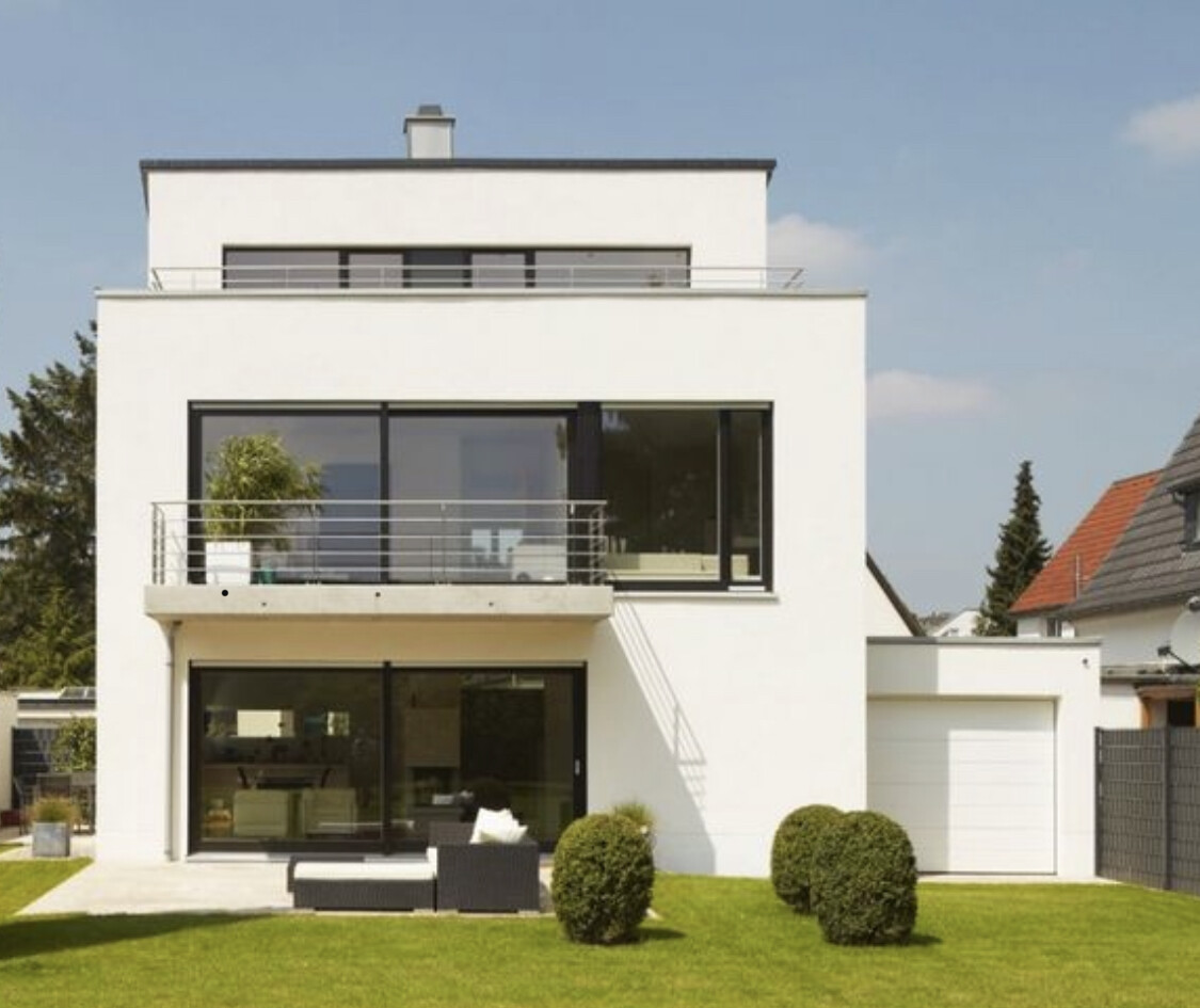

Here in Munich, the setback top floor (known as a recessed or stepped-back story) is quite common, mainly because the plots are usually rather small. When you stand directly in front of such a house and look up, it appears much less bulky than on the drawings, due to the different perspective. However, this only applies if the recessed top floor is set back on all sides. That’s why I would definitely recommend this to you (which you have already realized yourself). The same goes for pushing the garage back, as also suggested by 11ant.
Here is an example image where you can clearly see what I mean. The main building volumes of the ground floor and upper floor appear in the foreground, while the recessed top floor and garage recede into the background. If you highlight them with color, the effect is even stronger.
Otherwise, I would reduce the size of the utility/technical room and add that space to the living room, and rather create an extra storage room upstairs. For that, the office could be slightly smaller. Increasing the length from 11 to 12 meters (39 to 40 feet) would also create more spaciousness in the combined living-dining-kitchen area. The kitchen is currently too small (distance between kitchen run and island, as well as the island depth). If you add one meter (3 feet) to the width of your house, you will need a different layout toward an L-shape. Otherwise, in my opinion, it won’t bring much improvement.
In the recessed top floor, there is not enough space for the walk-in closet, and the sauna is far too small. But since it has to be new anyway due to the setback, this inevitably leads to a new position for the staircase. This needs to be carefully considered to find the best solution. I could also imagine an open staircase running across, separating the kitchen-dining area from the living room. Obviously, it doesn’t bother you that the staircase is open and not enclosed in a hallway, does it?

because the plots are usually quite small.That might be true for a semi-detached or terraced house. But you want to fit 200 m² (2,150 sq ft) detached on a 700 m² (7,535 sq ft) plot. Apart from simply "wanting to," I don’t see any real need for a setback or stepped floor.
@Würfel*
In Munich, on a 400m² (4300ft²) plot where you want at least 200m² (2150ft²) of living space, I’m with you.
The perspective you blame for the design in your example photo is actually quite flattering.
Also, take a look at the proportions between the lower floors and the recessed top floor.
I don’t think anyone said it’s fundamentally a bad idea. However, in the initial design, it wasn’t well executed, and here it’s unnecessary.
Whether you end up with 380m² (4100ft²) or 400m² (4300ft²) of pure garden left (just an estimate), you hardly notice the difference, and it still requires plenty of work.
