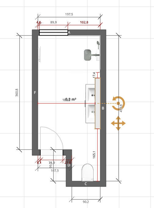

The bathroom is currently just adequate, with about 8 sqm (86 sq ft) it is rather small and in an outdated condition, so it definitely needs to be replaced. For completeness, I’m attaching a floor plan here since I have already looked through many bathroom threads, but I’m hoping for some collective wisdom and maybe a few more ideas before we get more specific with the planning.

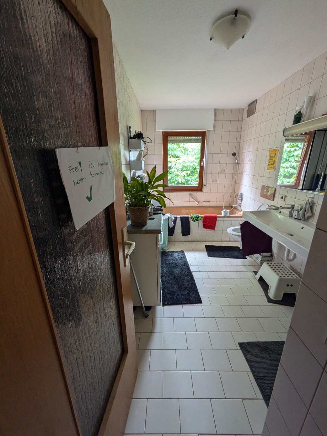

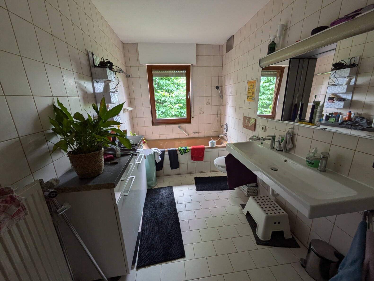

Here are also some current pictures of the bathroom:

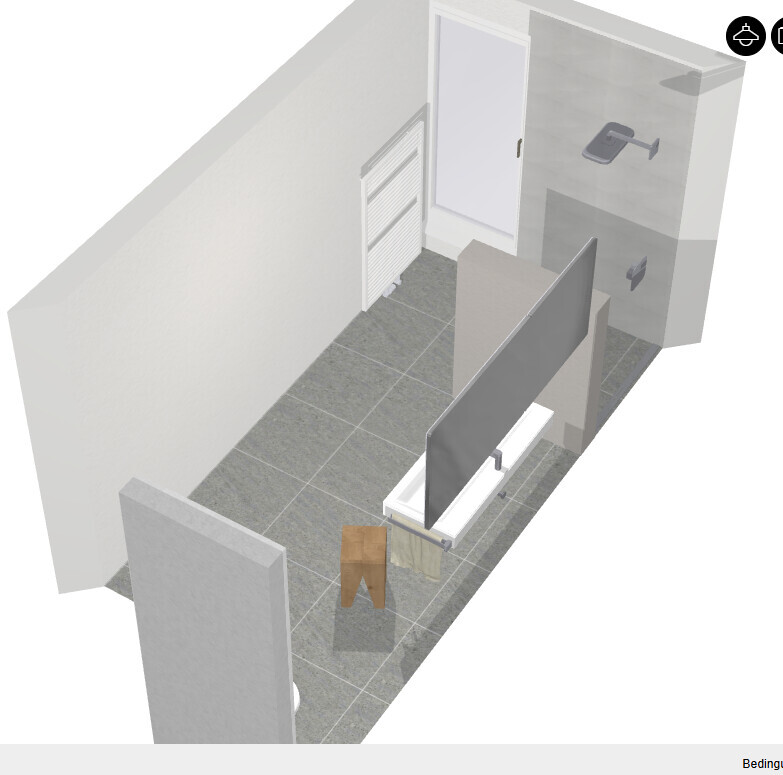

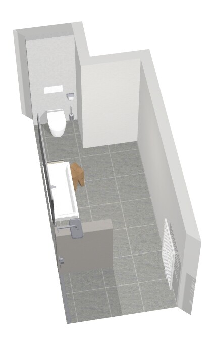

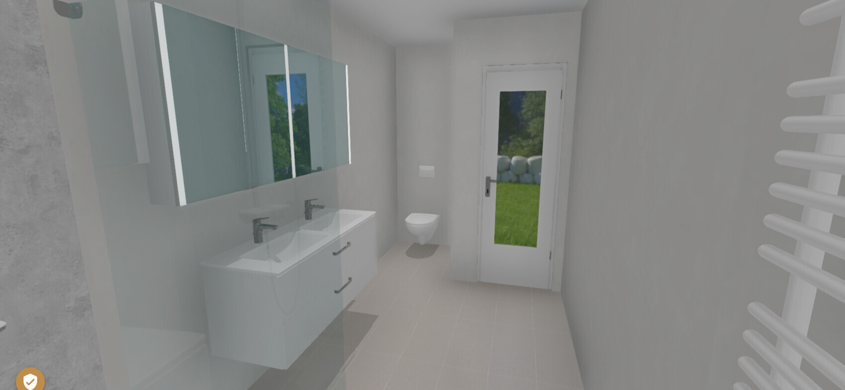

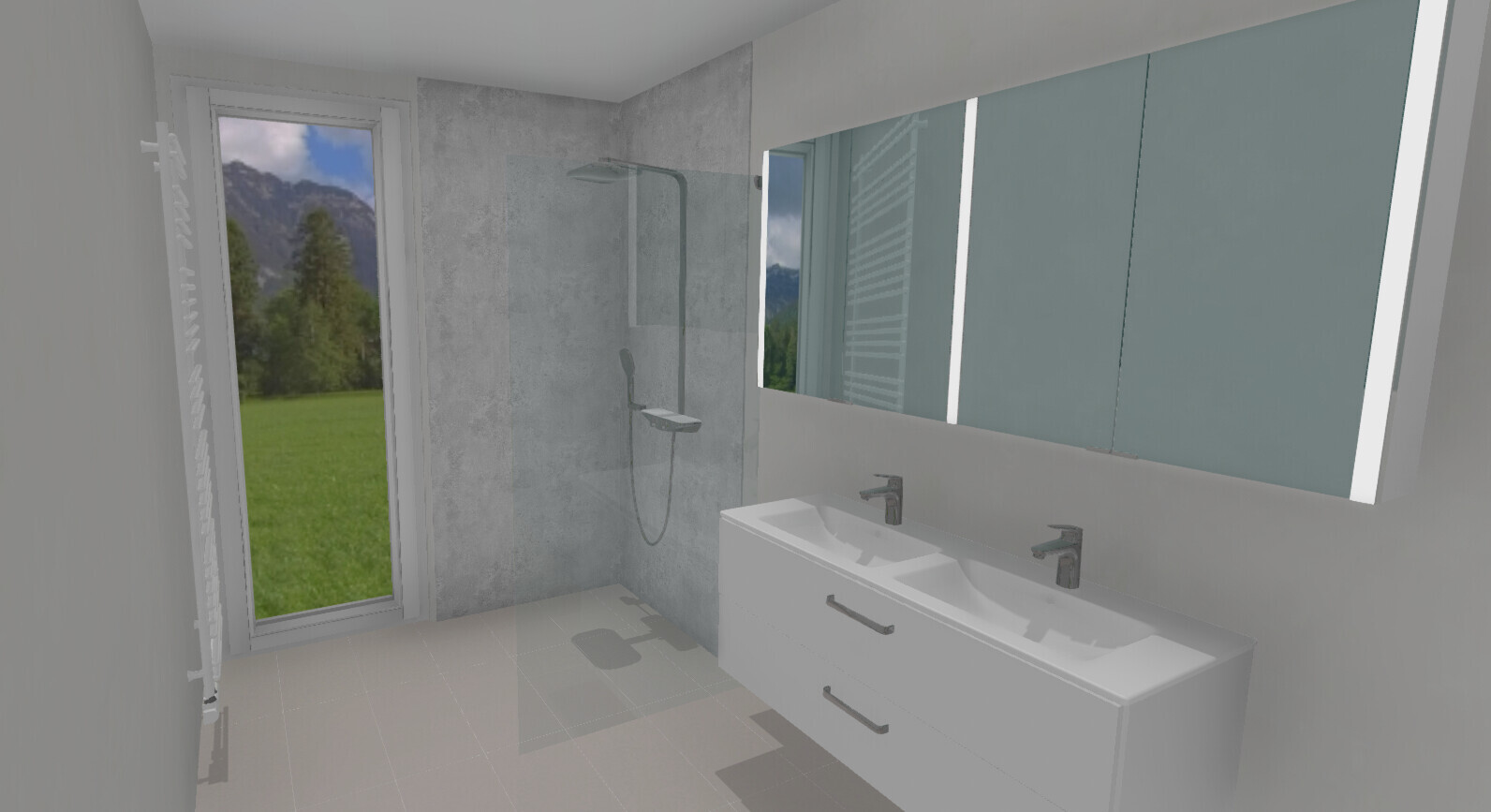

Sandra&Thilo23 Jul 2024 15:25I tried using the free planner from Kaldewei. This software is practically unusable for most purposes, but well, I created something with it.
The idea is to install a glass panel on the wall in front of the shower, extending all the way to the top, and possibly extend the wall with glass as well, which this tool does not support. Maybe make the entire wall out of glass, with frosting or a film on the lower part.
Sandra&Thilo23 Jul 2024 16:35I actually think the location of the shower is quite good where it is now.
I would try to place a cabinet under the existing washbasin instead of the space-consuming unit on the left.
With the cabinet, the toilet would be somewhat shielded. If that’s not enough, a privacy screen could be installed.
I wouldn’t want to do without a bathtub—there are plenty of other uses for it. However, it could be rotated and placed in the left back corner. If you want to skip it, then that’s your choice.
I would always prefer the toilet to be by a window, if possible. Also, having short pipe runs from the drain to the exterior wall provides reliability.
motorradsilke24 Jul 2024 04:42Sandra&Thilo schrieb:
The planner from Elements is clearly easier and faster to use.
I would like the bathroom like this. I would make the glass partition a bit wider to prevent water splashing out.
I wouldn’t keep the shower in the recess either; it feels too cramped for me.
We also don’t have a bathtub and haven’t missed it for three years; we hadn’t used one for years in our previous house either. For the few times a year when I need it, for example for washing large laundry items, I have a plastic tub that I keep in the laundry area. I wouldn’t sacrifice the rather limited space for a bathtub that isn’t used. Plus, it needs regular cleaning.
