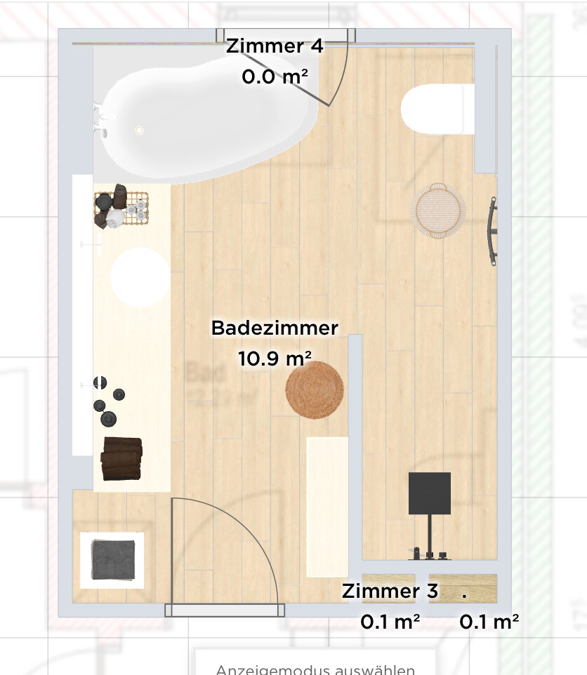

Image 1: a slightly different floor plan, optimized shower (length 160cm (63 inches)), toilet with view out the window, softer bathtub shape
[ATTACH alt="IMG_0735.jpeg"]83266[/ATTACH]

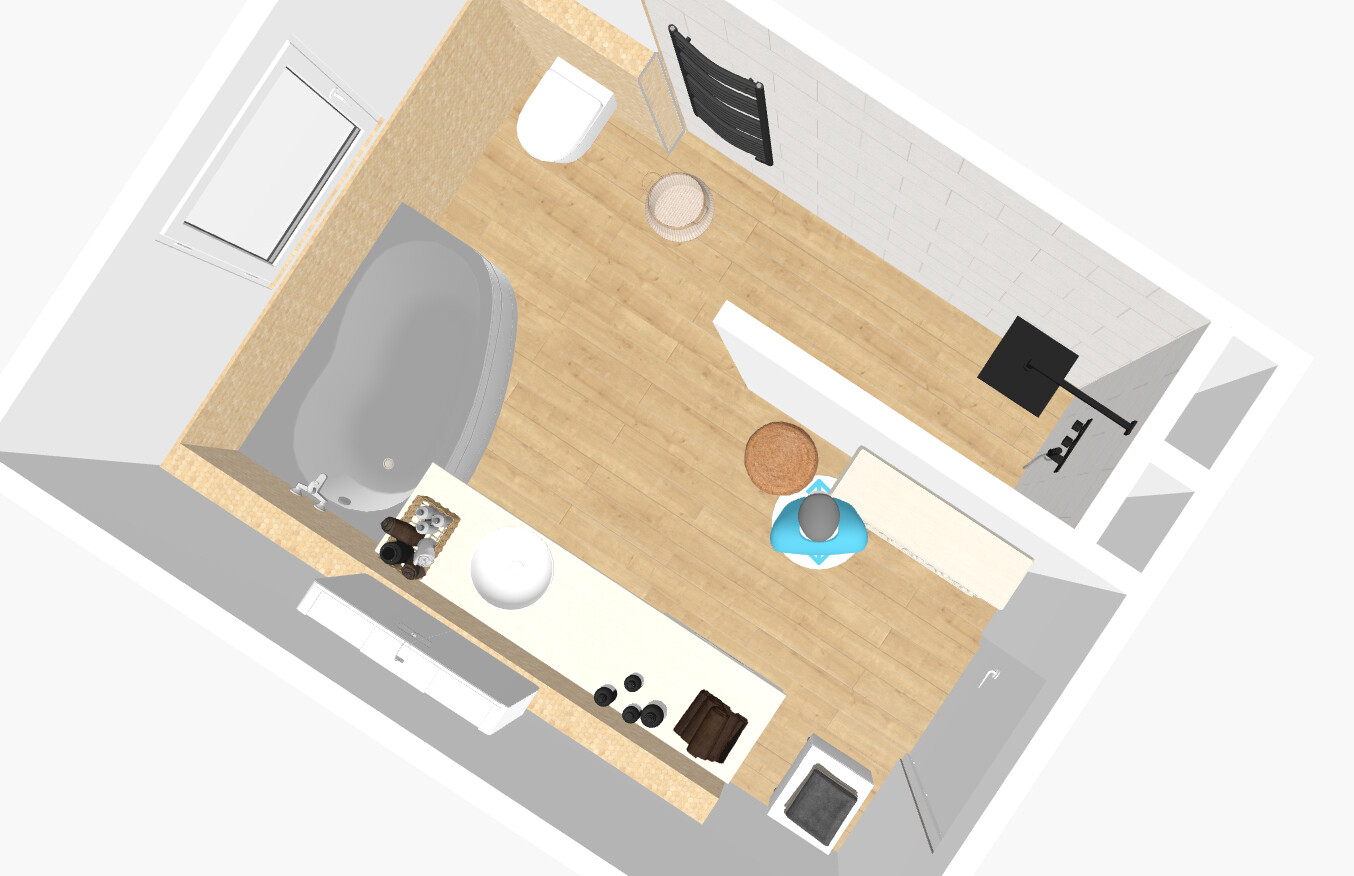

Image 3: here it’s more the opposite: framing the focal elements in natural tones like the floor
[ATTACH alt="IMG_0731.jpeg"]83268[/ATTACH]

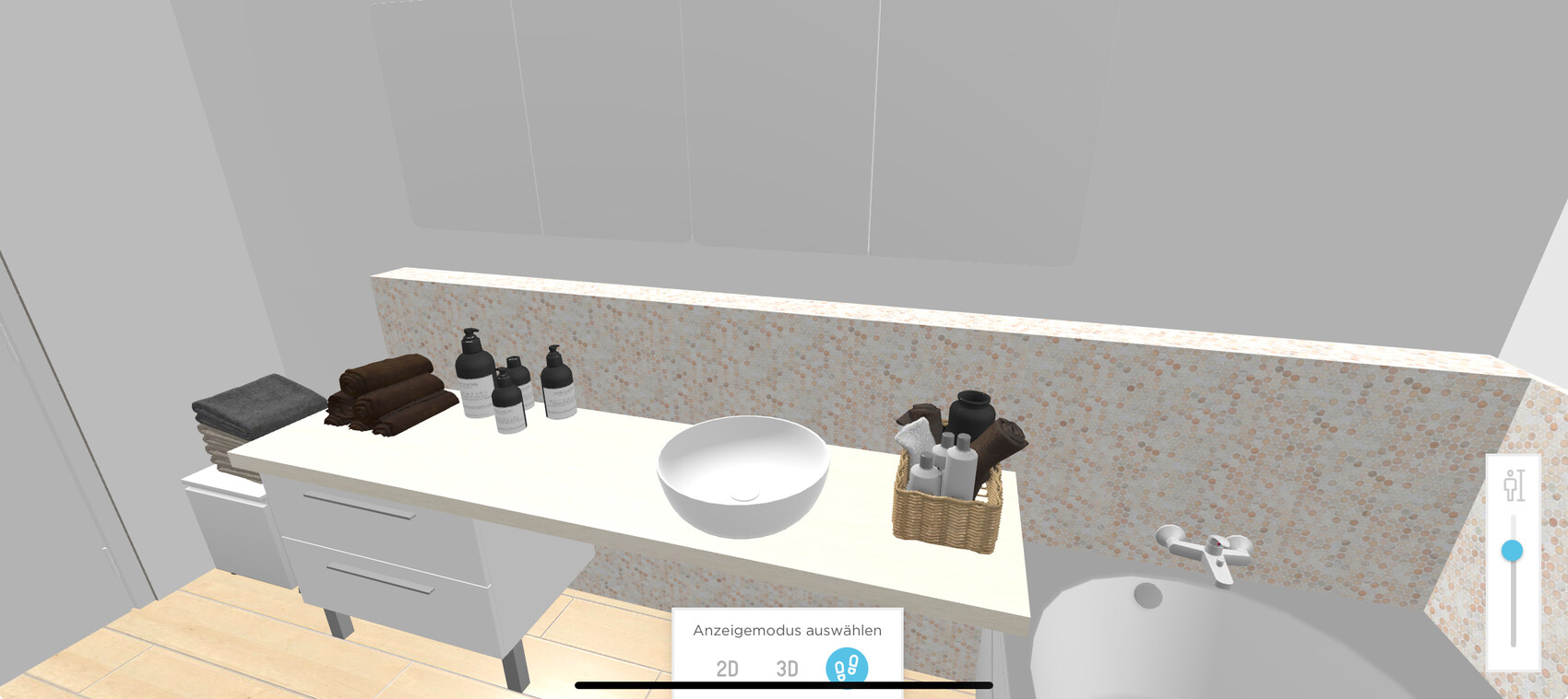

Image 4: asymmetrical washbasin with mirrored cabinet in front of a white wall
[ATTACH alt="IMG_0733.jpeg"]83269[/ATTACH]

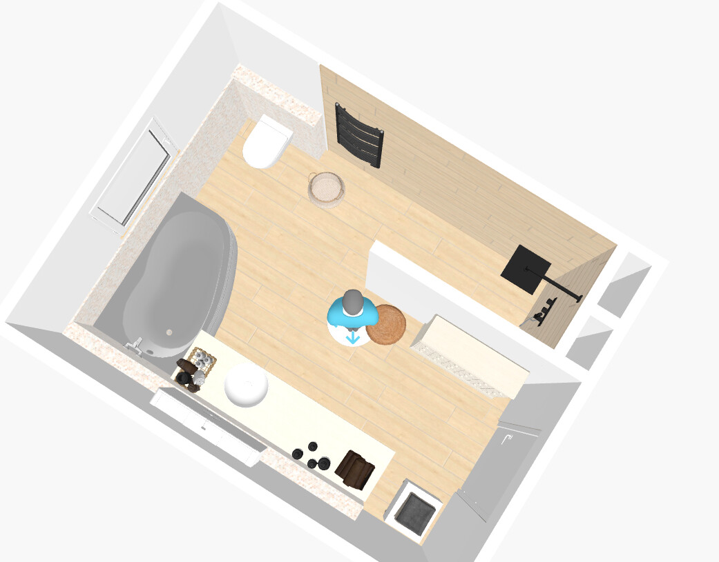

Image 5: mirrored cabinets in front of a beige wall
[ATTACH alt="IMG_0734.jpeg"]83270[/ATTACH]
Message: if you have a nice washbasin, put it in the spotlight; if it’s unattractive, let it disappear. Thank you very much for your effort! I like the solution with the bathtub and toilet. I’m sure some will criticize that the toilet is too visible from the entrance door. But honestly, that doesn’t bother me much.
Did you keep the dimensions? How wide is the shower inside? How wide is the washbasin you chose? What are the dimensions of the bathtub (the missing wall is 3.15m (10 feet 4 inches) long inside)?
