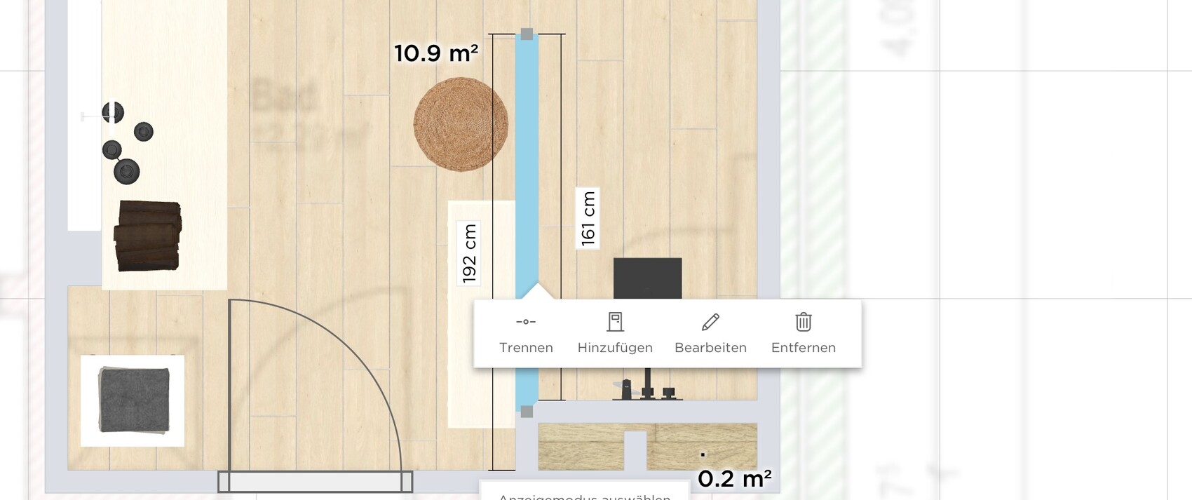

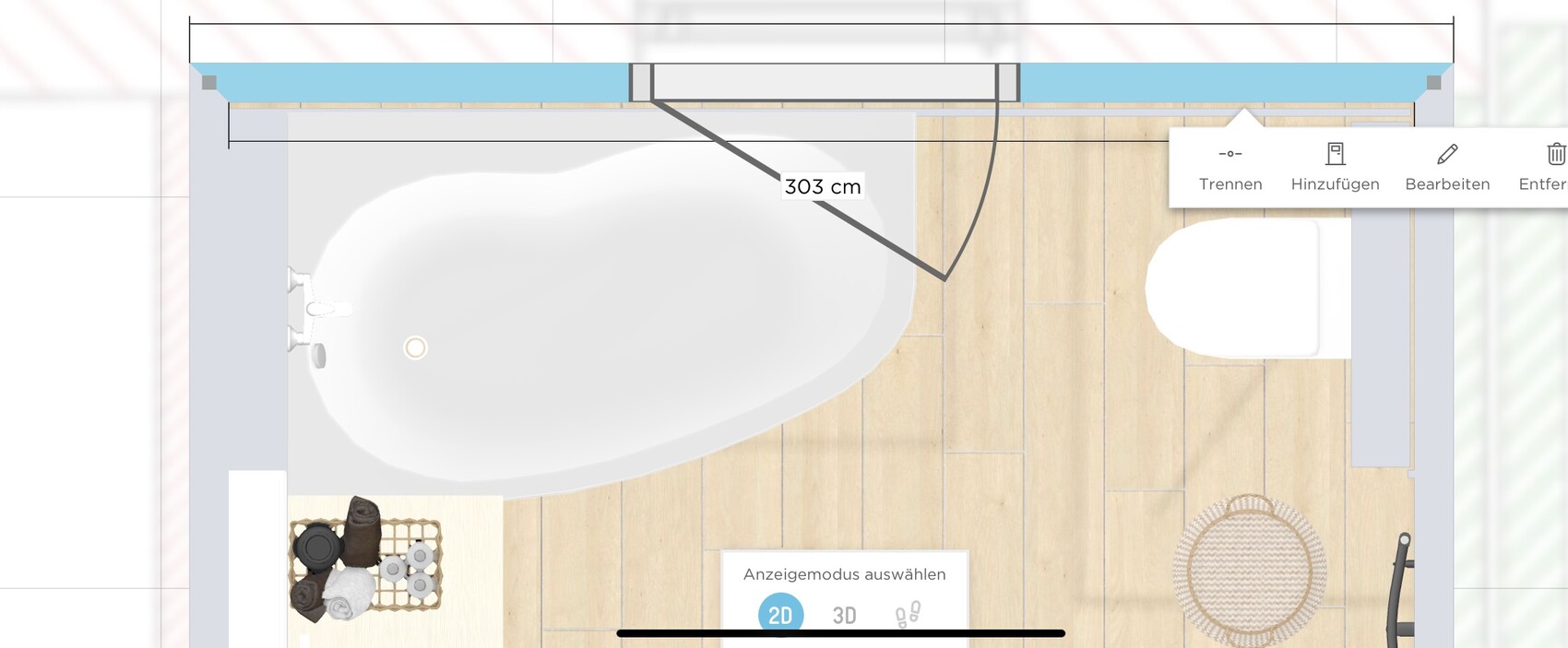

Attached is the floor plan of the entire level including the architect’s bathroom proposal. It’s a rough draft from him based on our requests. Unfortunately, our need for consulting has not really been met.
My husband experimented with a bathroom planner and came up with the proposal attached. I find it quite coherent. What do you think? Is it doable? Are there any awkward points? What bothers me mostly is that the window is behind the bathtub. But we couldn’t find another solution without making either the shower or the space at the vanity cramped. I prefer to lean over the bathtub. Plus, with the ventilation system, opening the window is less necessary anyway.
What I’m wondering now is how to design the bathroom nicely? Should the walls around the toilet and shower be tiled all the way to the ceiling? Or different heights? How would you tile it? With a child, we should probably tile at least halfway up everywhere (toilet, sink, bathtub) and fully tile in the shower. We are considering continuing the oak-look vinyl flooring from the rest of the living area into the bathroom. My husband thinks half-height tiles might make it too busy. I’m a little hesitant about fully white tiles, even if they are timeless. Any tips on small details that would enhance the bathroom are welcome too. For example, I would like a shower niche.

hanghaus2023 schrieb:
Which dimensions are correct? The ones from the bathroom you planned yourself? Or the ones in the building plan? It concerns the position of the door and window. How large is the window and what is the sill height?The ones from the builder in the complete floor plan.
Anniiii schrieb:
Did you take the measurements? I used the 4 meters (13 feet) as a reference and, I believe, the plan from the „Green“ Forumdada (sorry, but writing it out fully gets deleted) as a template. Since I know the staircase hasn’t been moved and it also leads to the second floor, the original space remains.

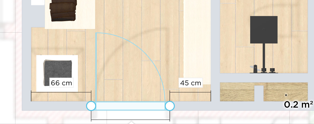

Anniiii schrieb:
There will probably be criticism here that the toilet is too visible from the entrance door. But honestly, that doesn’t bother me much. Let it be, ours is exactly the same in sight. Some people even go to the basement to use the toilet, or children have never seen their parents naked. Not everyone has to follow that kind of modesty.
The toilet has a good spot there: natural daylight, some view outside, and the drain runs perfectly along the exterior wall through the hallway closet (pay attention!). I assume that something custom-built will go in there?! It will be 30 cm (12 inches) less space, but you have to expect that when a house has one floor more than the ground floor. It won’t get wet, and the shower also has daylight.

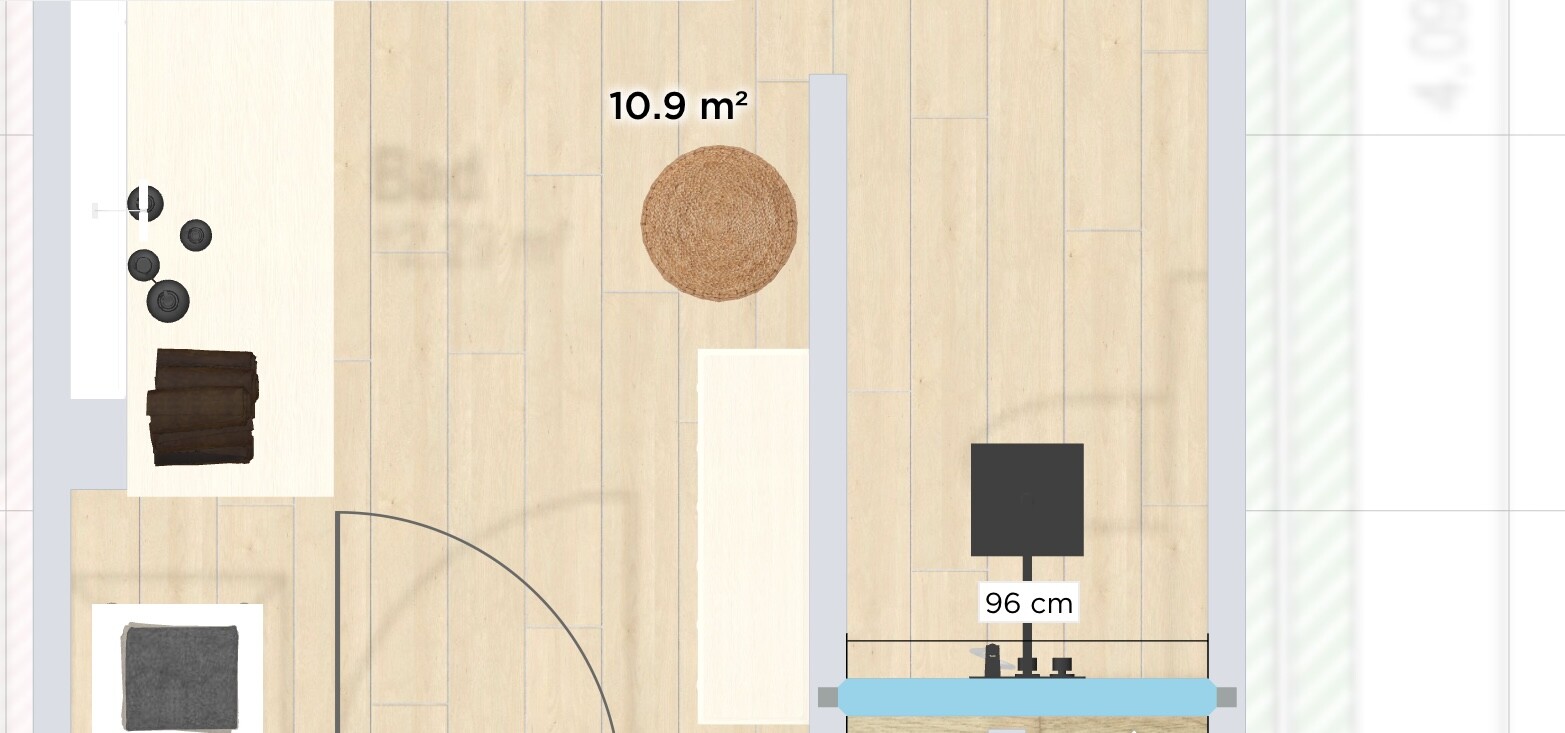

Anniiii schrieb:
Attached is a picture showing an alternative idea without a wooden floor. I think it looks very nice like this. The height should be sufficient, probably the 120 cm (47 inches) of the partition walls. It frames the space. Only the shower area needs to be a bit higher. Whether the partition wall is 200 cm (79 inches), 220 cm (87 inches), or floor-to-ceiling is a personal choice. You won’t significantly affect the lighting.

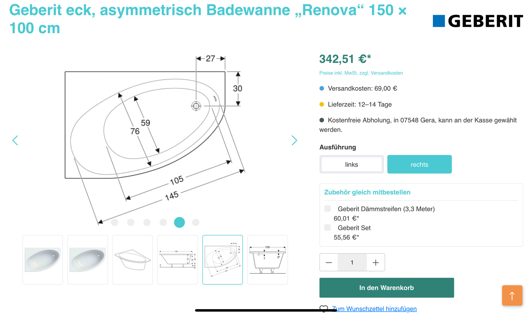

The bathtub measures 100 x 160 cm (39 x 63 inches), but there is also a version from Keramag sized 100 x 150 cm (39 x 59 inches).
After checking, it is now from Geberit.
I installed it myself in a small bathroom in a terraced house. It was great: slightly deeper, so two people could at least sit in it together. When alone you sat halfway in, but you were fully submerged in the water.
