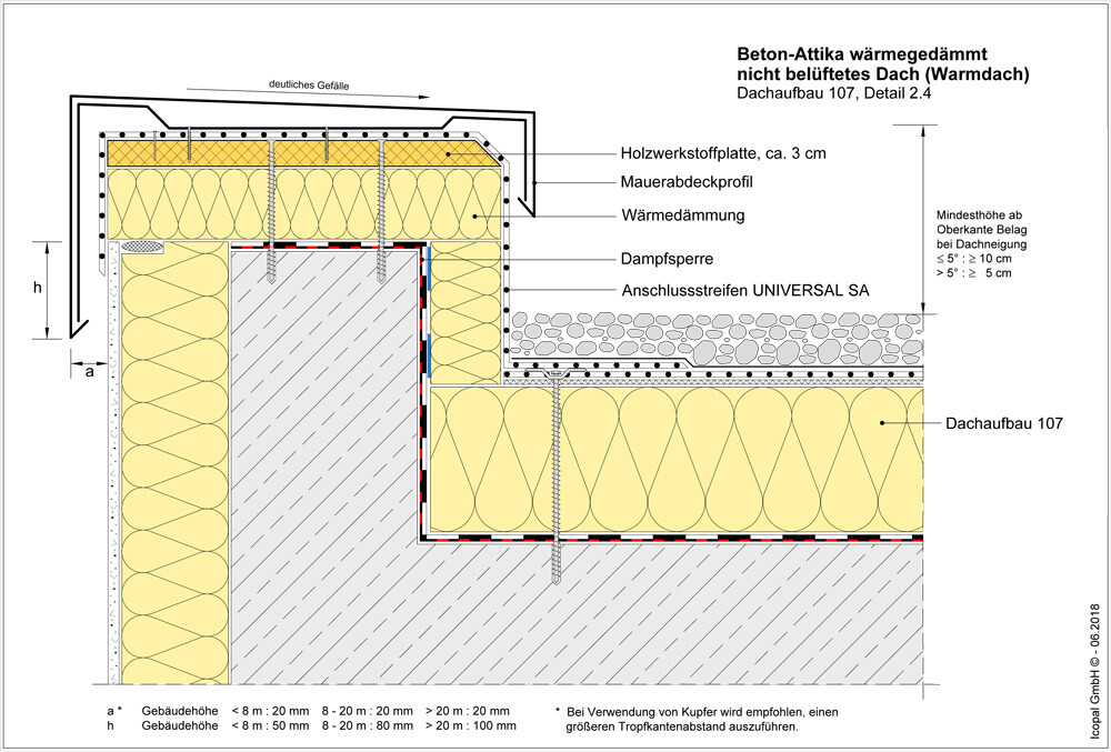

I also came across the following construction method online:
There are two key differences here:
1. The parapet is additionally insulated on top.
2. A vapor barrier is also installed.
Now I am wondering about the advantages of the second construction method and whether it would be preferable. Of course, additional insulation on top does no harm, but is it worth it? A railing is also planned to be mounted at one point, and I imagine this could be more difficult with insulation underneath.

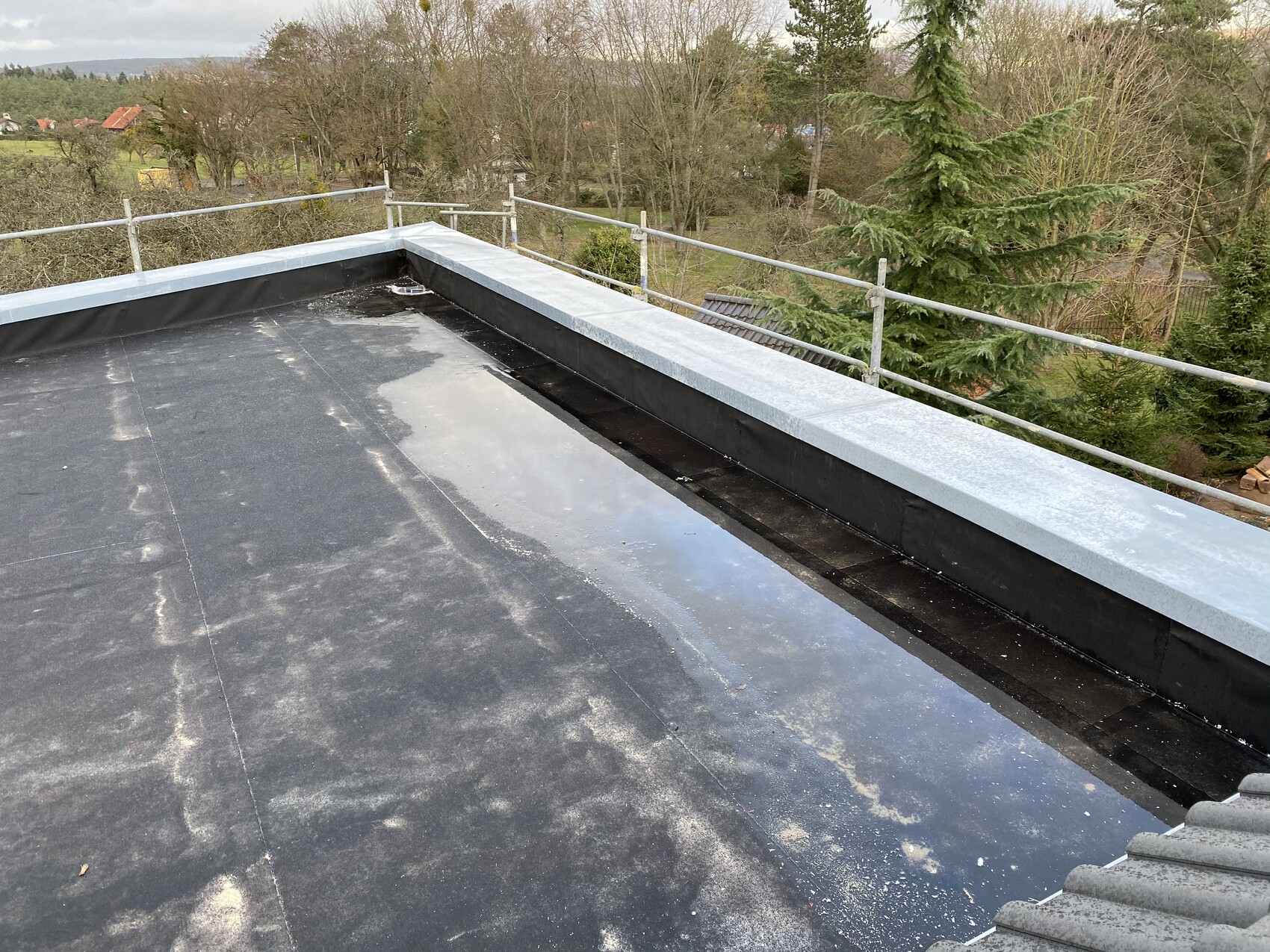

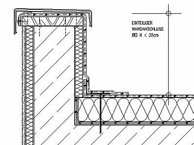

Thanks for the information! Generally, I would have issues with 10cm (4 inches), but one side will later have a railing because we have a terrace there. 10cm (4 inches) would significantly reduce the size of the terrace, and the railing also needs to be stable. I need to see how to best handle the insulation.
I also noticed that your parapet is significantly lower than ours. That increases the problem with the thermal bridge.
