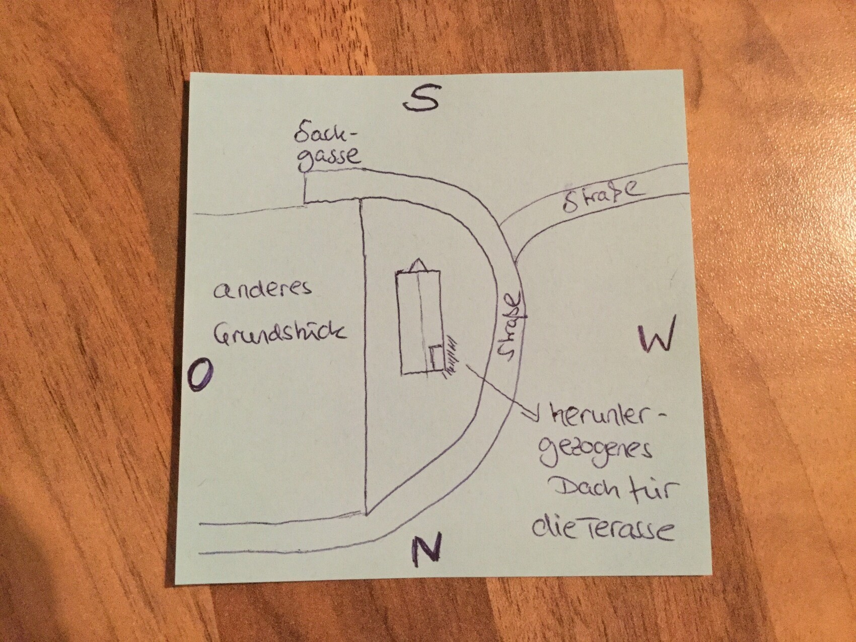

I don’t understand the orientation of the house on the plot. Entrance facing south, garage on the north side... and where is the privacy in the garden?
Is the street to the north? And how does someone, for example the mail carrier, reach the south entrance?
I know this isn’t meant to be discussed here, but I’m curious.

The children’s bathroom is in a problematic location: the sewage outlet is quite prominently placed in the dining area. Or between the living room and stairs.
I don’t understand the orientation of the house on the plot. Entrance on the south side, garage on the north... and where is the privacy in the garden?
Is the street on the north side? And how does, for example, the postman access the south entrance?
I was also very surprised by the orientation... I think the living area will be really dark in autumn. Not much light will come from the west. Is the roof extended that far on the north side? For what purpose? It can’t be for sun protection, since there is no sun there. That’s exactly why I would design it as open as possible, to capture the light that is available.

Regarding the orientation, I just made a “breakfast sketch” at the table, please don’t be too harsh on me
I hope it’s clear enough… a top-down view. Due to the building permit / planning permission for this corner plot, no other orientation is possible based on the size of the house. This seems to be the best option.
