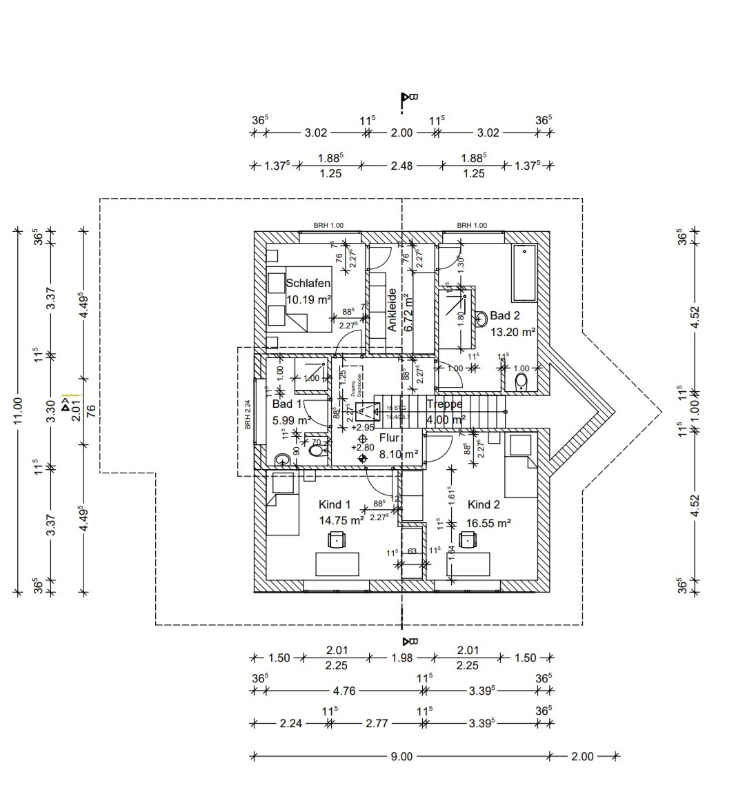

Unfortunately, we are stuck with the planning of the upper floor of our single-family house. I have deliberately only uploaded the upper floor and not the entire preferred forum list because we only need help with this layout. Here are the key facts:
• Gable roof with knee wall of 1.60 m (5 feet 3 inches)
• We prefer a straight staircase because it is easier for carrying furniture (in our current house we have a half-turned U-shaped staircase, which we want to avoid). Of course, it also takes up a lot of space.
• Both a master bathroom and a children’s bathroom are a must for us (each with a tiled walk-in shower, no more glass doors!)
• The sleeping area, walk-in closet, and master bathroom should be planned in that order (shift work, different wake-up times, with the walk-in closet acting as a noise buffer to the bathroom). Ideally, access from the hallway through the closet to the sleeping area and bathroom is desired.
• The walk-in closet should ideally have space for a 4 m (13 feet) long wardrobe (subtracting any slanted ceiling).

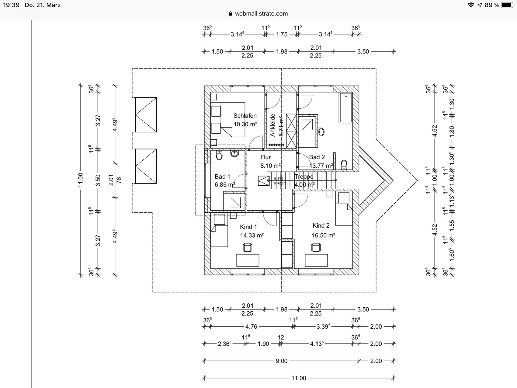

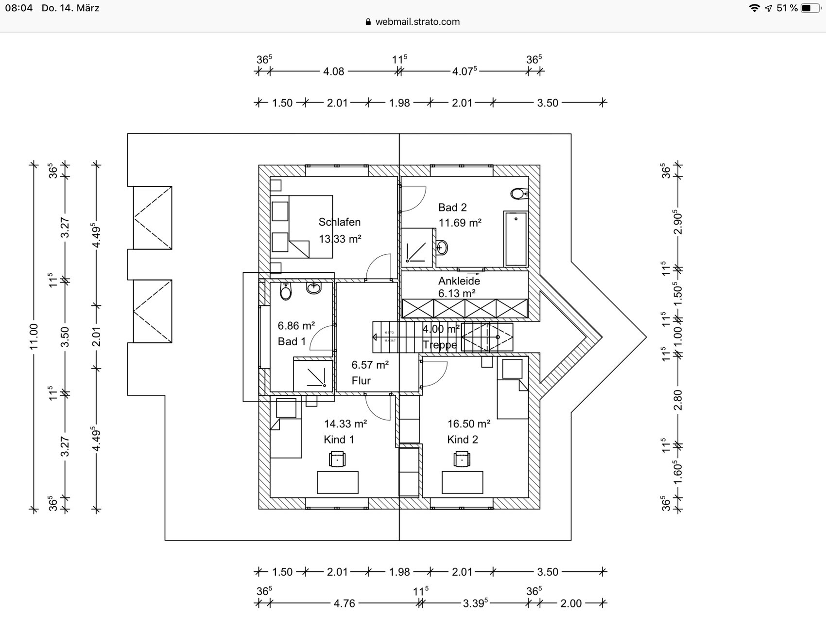

The two plans show variants from our architect, which are not yet fully optimal. We are aware that these are many requirements. We have tried everything to sketch it out, but we haven’t found a good solution.
• Should the nice dormer be used as a walk-in closet?
• Is the straight staircase the space killer in the upper floor, or would the planning be easier without it?
Is all this even feasible, or are we being too unrealistic? Perhaps someone has a similar layout or a saving idea!?
Thanks in advance!

Yes, the roof slope must not be overlooked, I have already taken that into account.
I am also curious whether the option with the three windows on the side will work. On the elevation plan, it looks quite tight because of the roof slope, but maybe I am mistaken about the measurements.
Please, the shower only without glass.
@ypg Hopefully, we can route the drainage pipes through the office.

We have now met with the architect, who has resolved everything to our satisfaction, and the building permit / planning permission has been submitted. We are currently getting quotes for the masonry work, and depending on the contractor, construction should start in August, September, or October.
Some might think the bedroom and walk-in closet are a bit small, but for us, they fit perfectly! The drainage for all bathrooms has also been well planned, running underneath through the study.

The mega brainstorming here kind of loses its impact when you consider moving the wall just 12cm (5 inches) to the left or right.
Yes, you’re (unfortunately) right – it was exactly the space that our current cabinets were missing. However, it would also have been a shame to reduce the size of the bathroom, etc.
